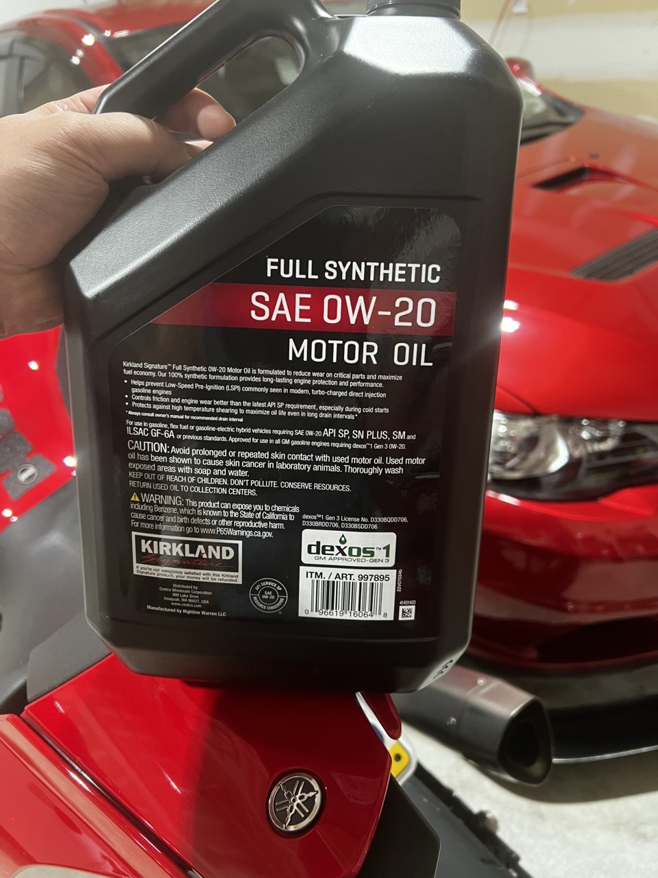

    TakiEvo
    TakiEvo New Member
    Dec 28, 2021
    #72363
    651
    Allentown, PA
    2022 SR5 TRD Sport Crewmax White
    This.
    Here is the back of a bottle of the 0W20 Kirkland that I picked up from Costco today and it includes ILSAC GF-6A.
    From Costco site. It shows ILASAC GF-6A Approved oil. Better than meets requirements.
    https://www.costco.com/kirkland-signature-5-quart-0w20-%26-5w30-full-synthetic-motor-oil,-4-pack.product.100691506.html

    Sixty9Four20
    Sixty9Four20 TRD is not a trim
    Jun 9, 2023
    #98361
    241
    2023 TuRD Pro
    I didn’t spend the money to just swap out stuff.
    Ah, you gotta hit the "specifications" link under the photos which bring up a new window not elsewhere in the page. OK, concern resolved.
