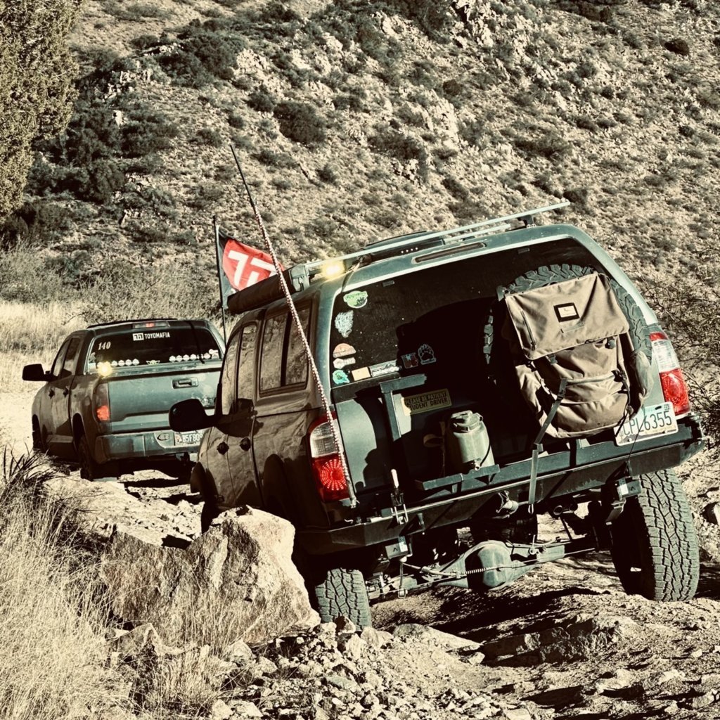

  5. Sep 21, 2024 at 12:19 PM
    FrenchToasty
    Sep 15, 2019
    #36156
    18,365
    Mo
    The SoAz….. big surprise
    Bone stock

    Looks good French Toasty. I was thinking installing the CO high clearance bumper without swings outs to save a little money. More I think about it though the spare tire will be visible underneath the truck and look funky plus vulnerable to puncture.

    I did the same and made my own swing out. I tried to replicate their heim joint design but ended up doing a prefabbed swing arm pivot with stop pins and stuff. I also added more support to that corner of the bumper for the swing arm pivot since it will see more flex and stress. And added reinforcements to the “wings” that extend to the fender wells.

    I highly recommend a tire swing out. You won't regret it. I have one on my BFF rear and I have a coastal front.

    Do the sides have a tube that bolts to the frame? I know some HC rears do that. Mine does not.

    From them it does yes, but not far enough forward into the wing so it felt very flimsy, I made a tube at a steeper angle to that other mount they use.

    I thought the swing out looked a little different. How’s it holding up? This would be my first big welding project. Reinforcements and stuff making me rethink the BFF. I did their front bumper and it’s pretty sweet.
