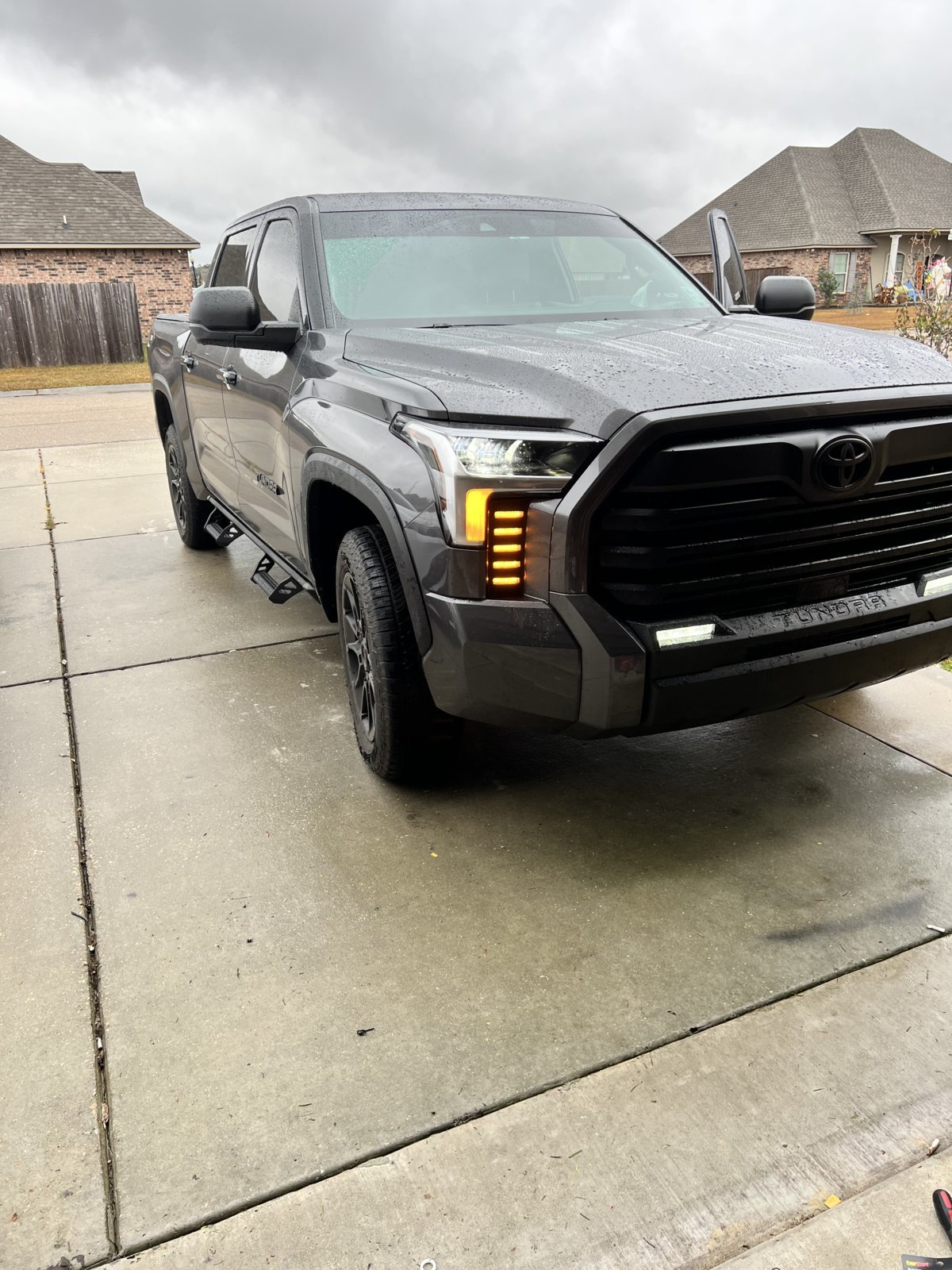

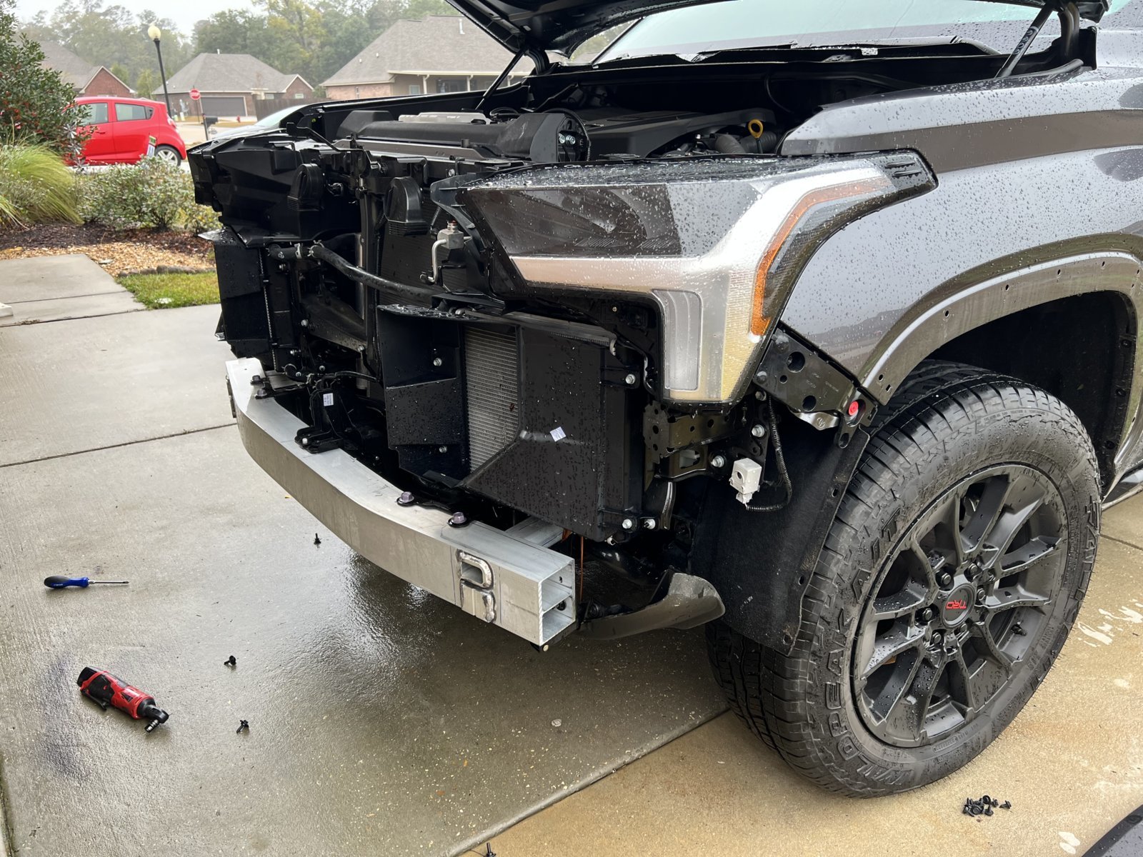

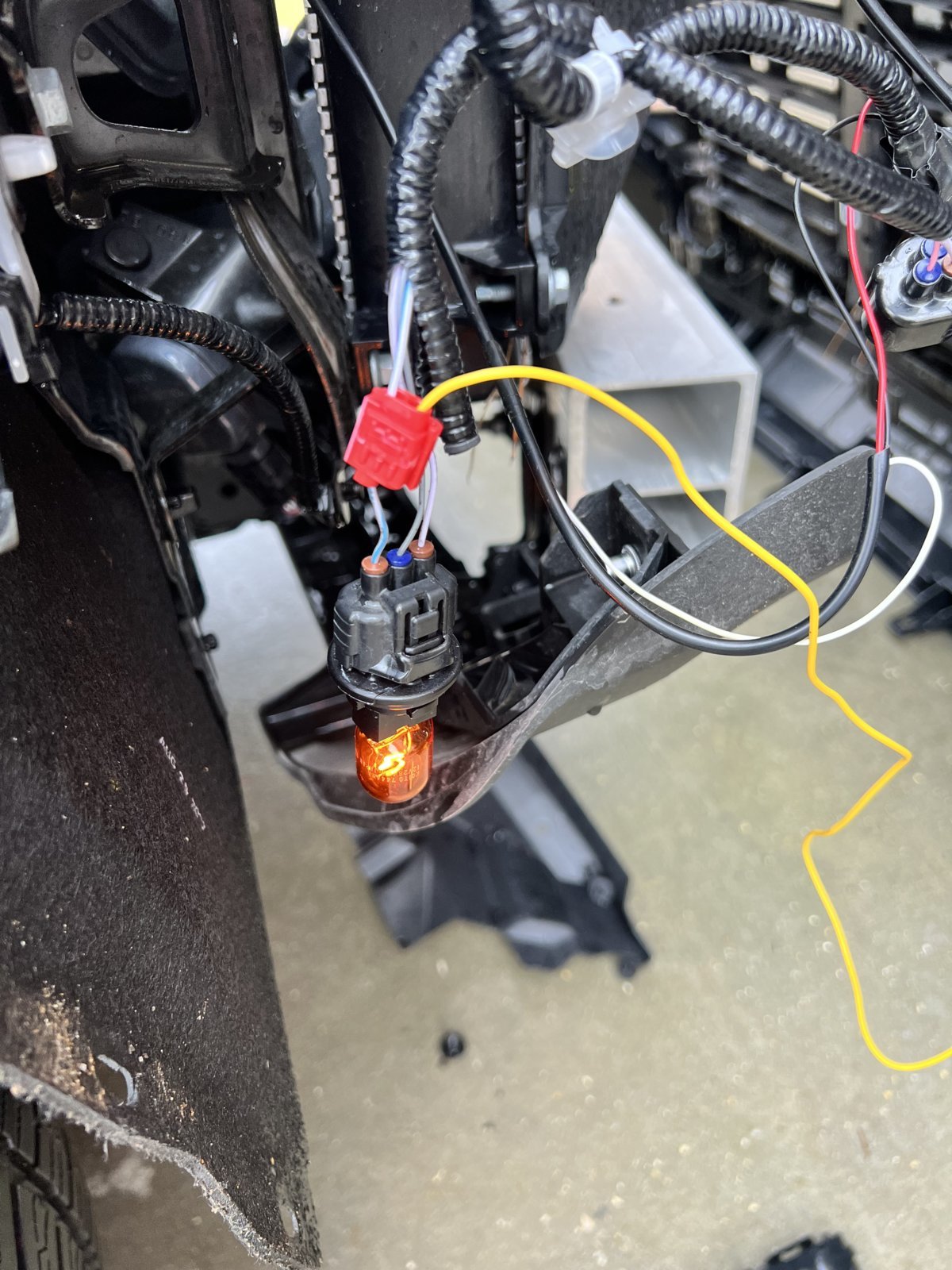

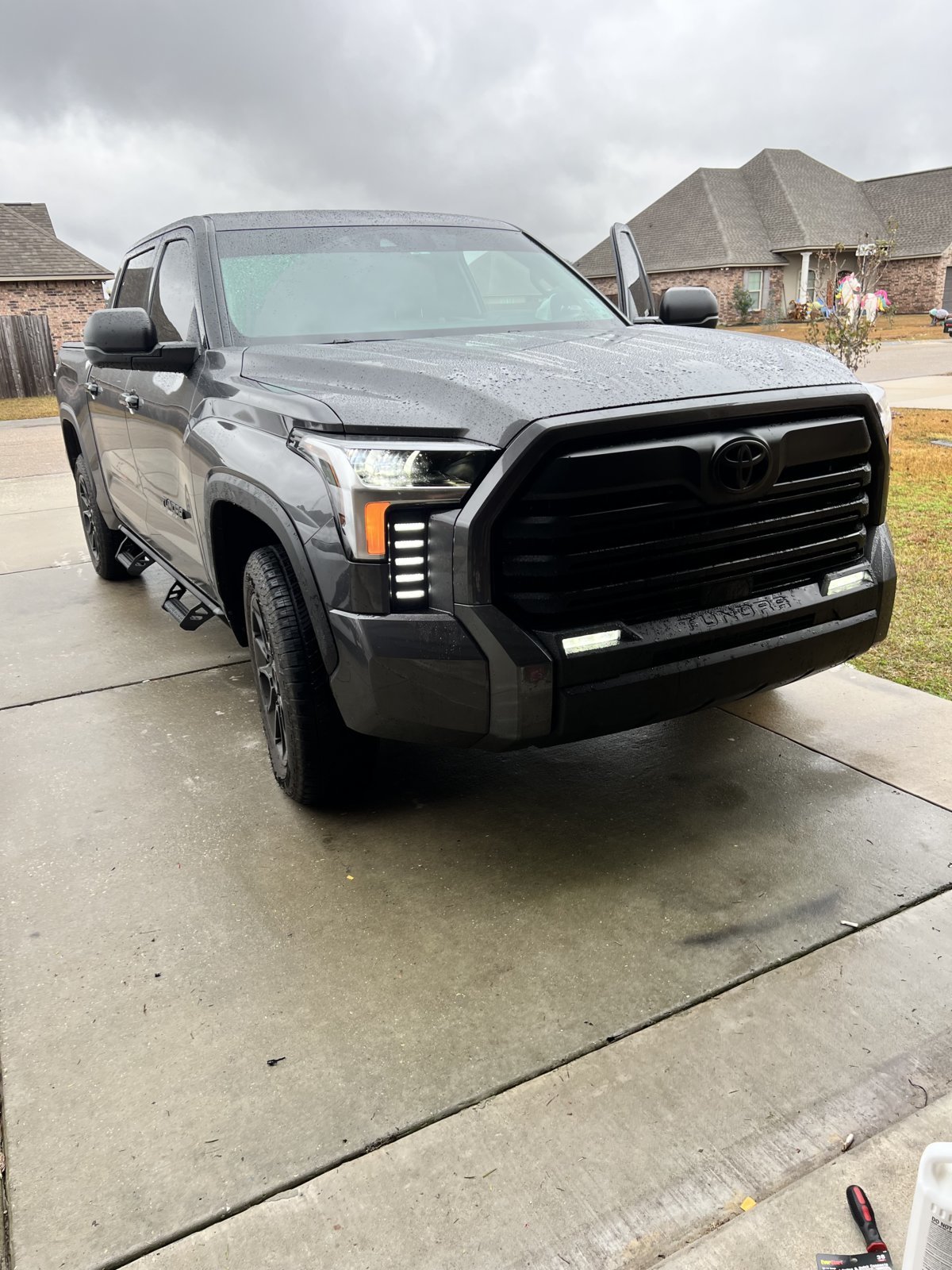

    I took some photos of the ones I installed hope this helps.

    damn I was hoping I wouldn't have to take the whole front off again.
    I got the drl part of mine working but not the turn signals. Where did you connect the red and white wires? The instruction video showed them tapped off a fuse but in my 2024 SR5 the fuses all have power all the time and not just when the ignition is on. Manufacturer instructions said red to acc, white to headlight/drl, and yellows to turn.

    I don’t remember and I just realized that the picture didn’t capture that. I used my multimeter and connected a 1mm tip (to keep from stripping wire) to the positive and negative leads on meter. Then I stuck it inside each wire and tested it that way until I found the right ones.

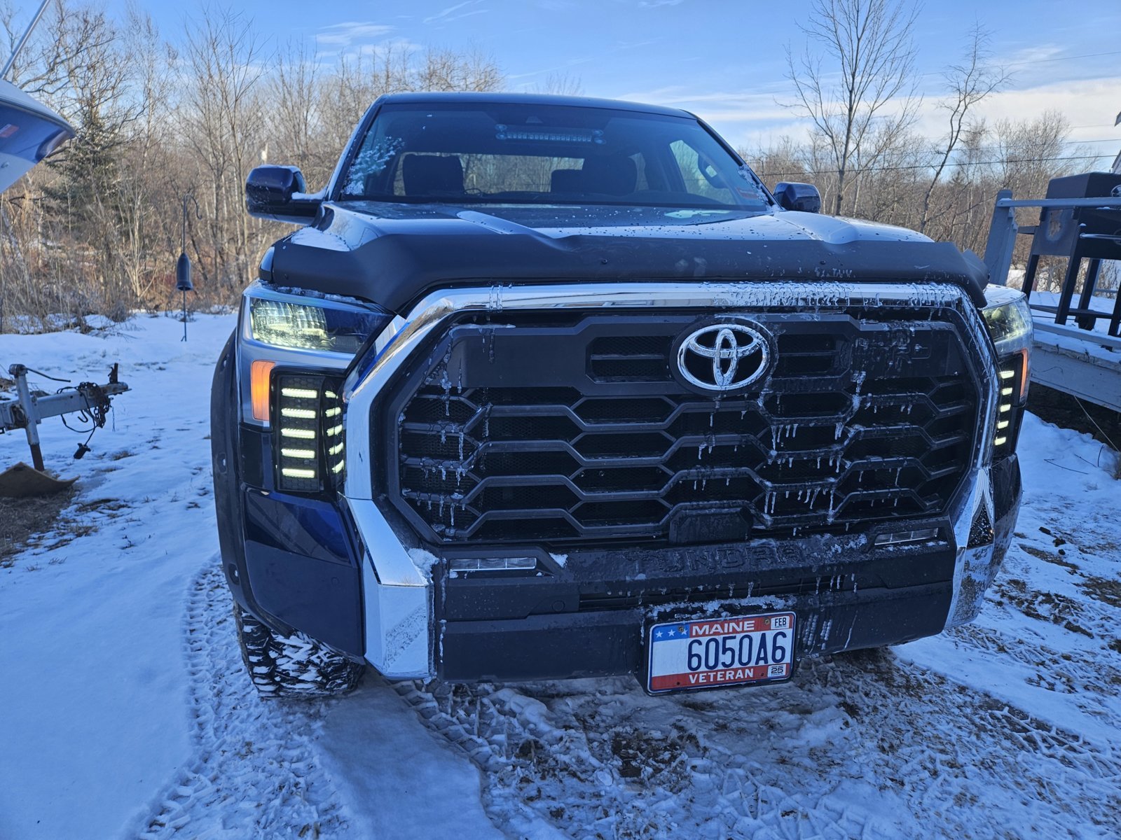

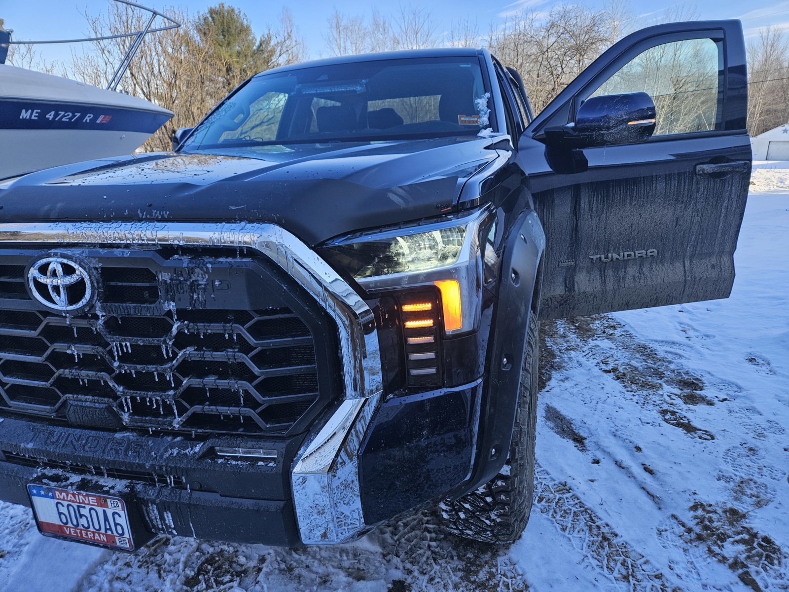

    got them working!

    Looks good. Toyota should have added that feature in the beginning
