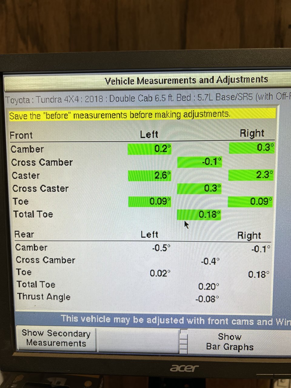

    These are my alignment specs after I installed the 2/1 cornfed
    Black widow TRD[OP] likes this.

    I see specs are for a 2018 Tundra. How did that workout? How’s the ride & tire wear?

    yes I noticed that on my specs and several others who’ve posted their alignment specs on here. Regardless, it rides nice. Stiffer over bumps which is to be expected.
    These alignment specs are in line with what Westcott recommends for their lift, which is a very similar style lift to the Cornfed.

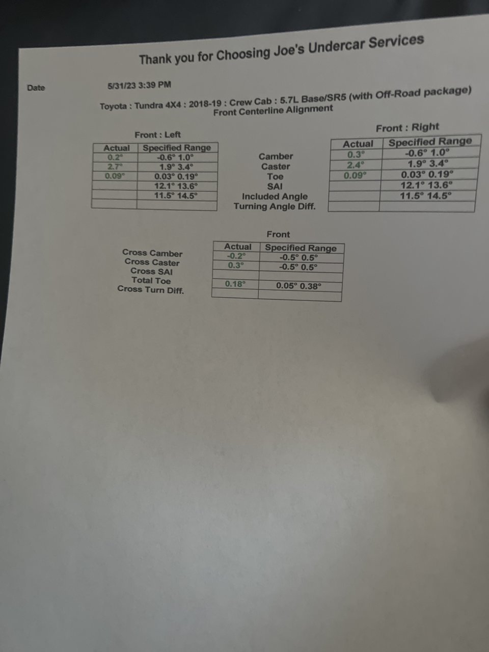

    @cvd2312
    Thank you so much for those specs. She drives frikken sweet.
    My shops print out.

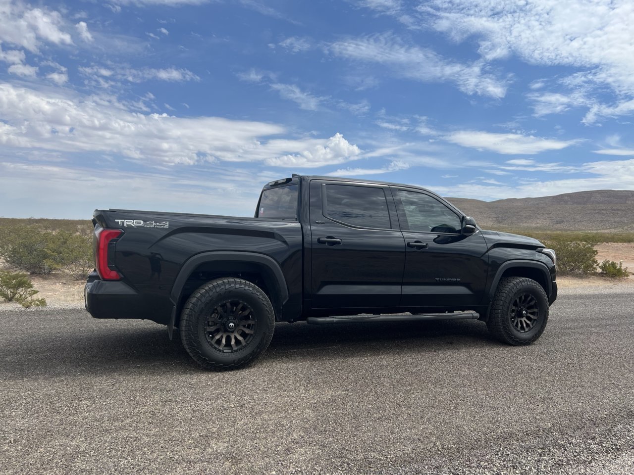

    how did 295s fit with a 2" front lift?

    Good, ever so slight rub on the front mud flaps. You can tap the wheel well liners back.
    Be sure to get a proper alignment.

    Final looks.
    Yota802 and Coasty like this.

    Great wheel to fender opening ratio, they should come that way...
