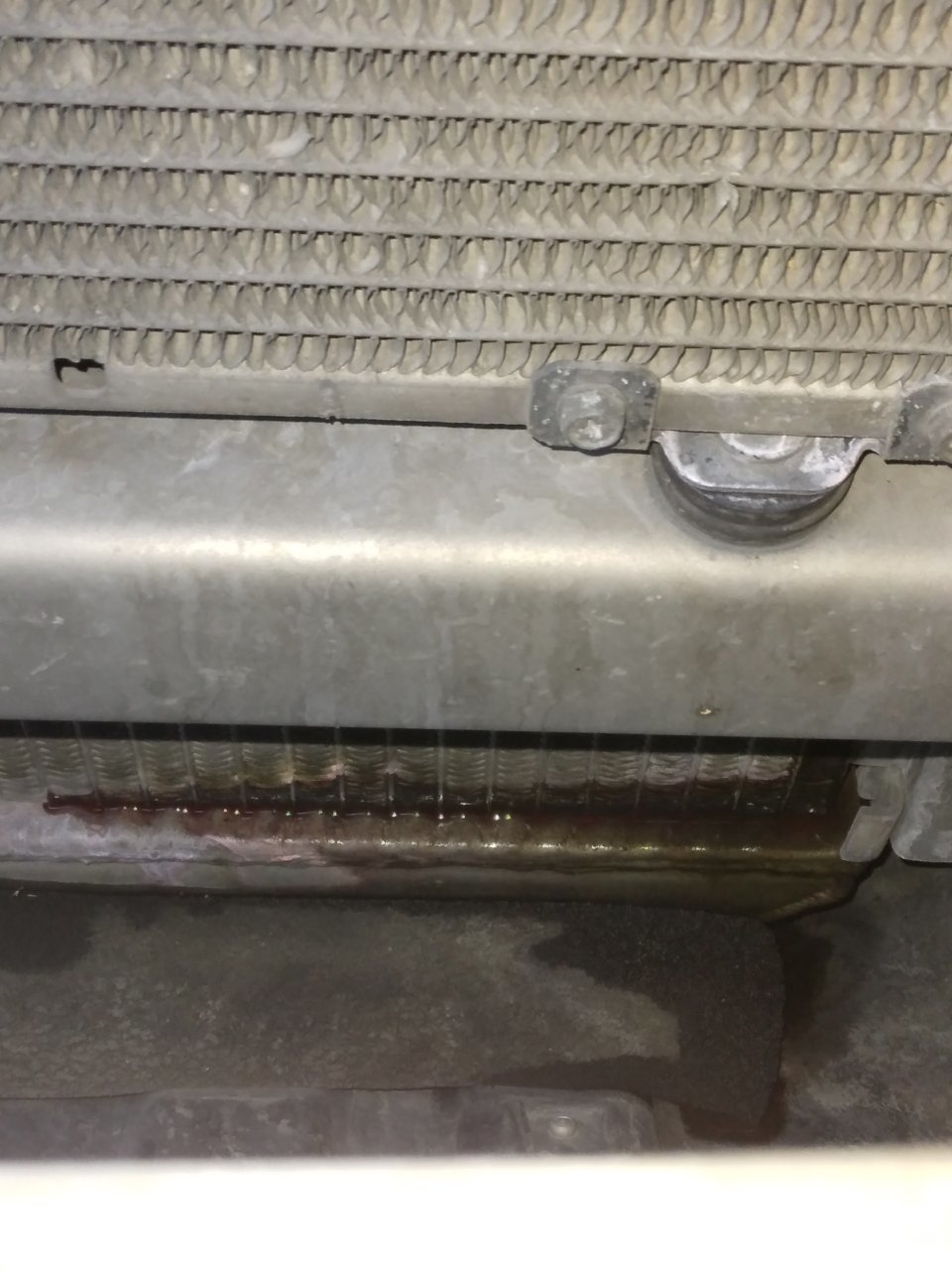

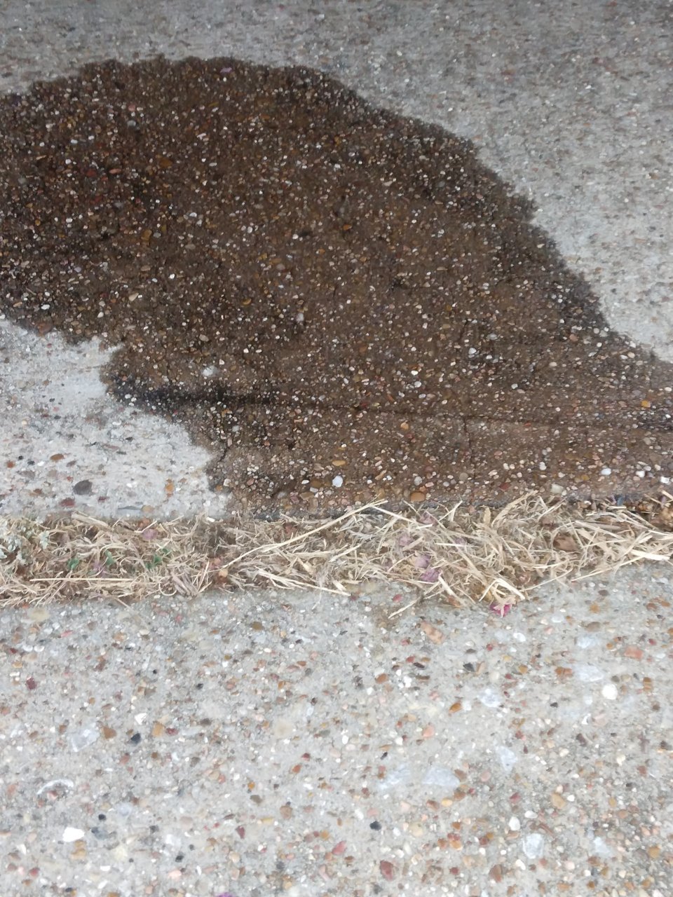

    Radiator leak? Came home today and found coolant on the ground. Replaced top hose 3 days ago. Was going to buy a thermostat but I believe Now that I need a radiator replacement. Any thoughts or opinions are widely accepted.

    Look below the upper hose. A lot of times the plastic tank cracks there when changing the hose. Due to the age and brittleness of the plastic after so many heat cycles.

    Tranny fluid is what it looks like

    No, my tranny and radiator fluid color are the same. I MADE SURE it was not the tranny. Good on that part.

    The first pic shows what appears to be dried/crusty coolant on the lower left. I hesitate to recommend this but you can dab a finger on the fluid and touch it to your tongue. If you get any hint of a sweet taste, it's coolant. If it's trans oil it wont taste like anything, just oily residue. Coolant is highly toxic so be warned so if you do a taste test don't swallow!

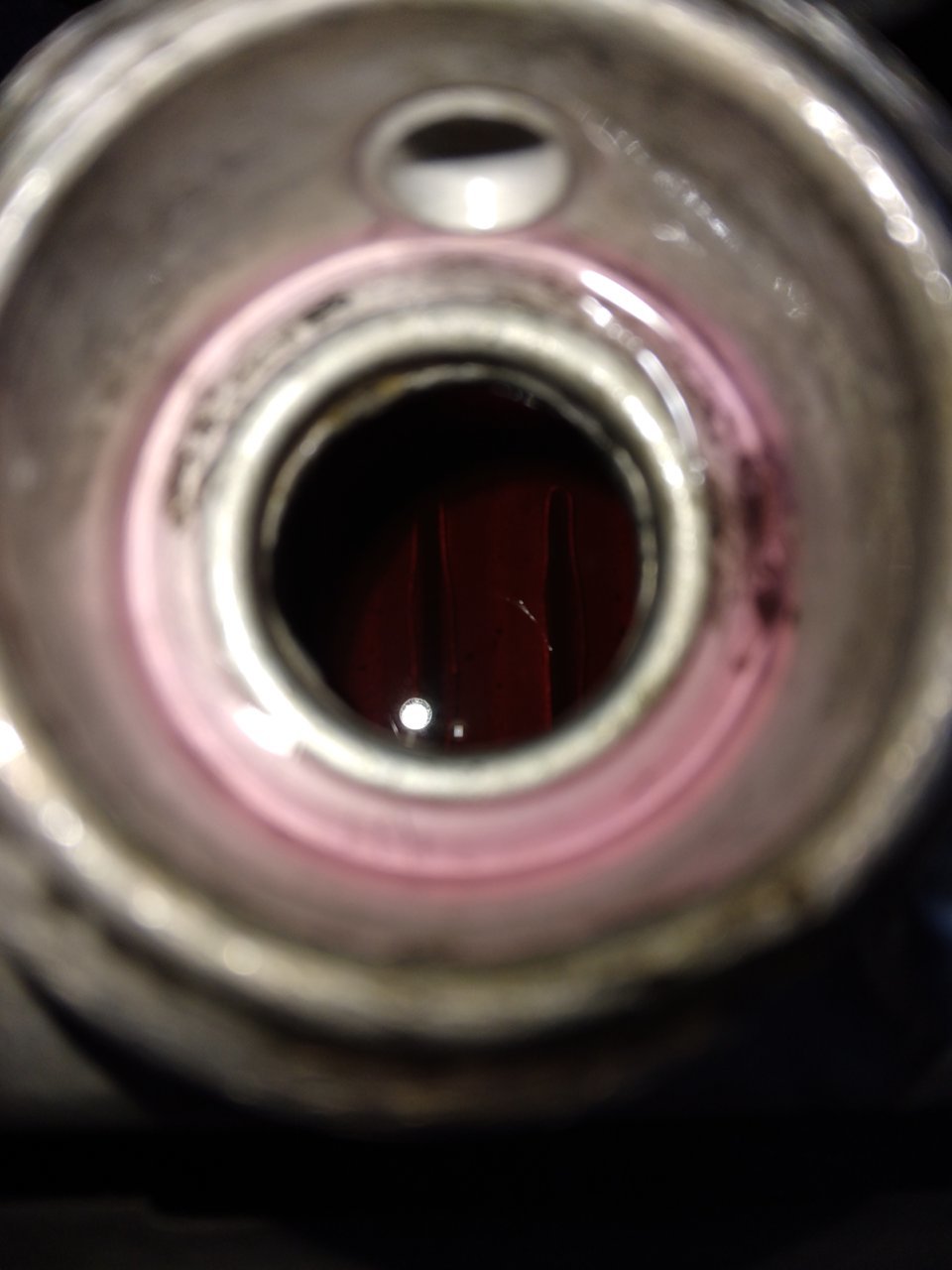

    While you're out there, remove the radator cap and take a look inside the radiator, check the overflow tank, and pull the transmission dipstick to see what the fluid looks like. If the coolant and ATF are pink/red and semi transparent, you're OK. If they're light pink and cloudy/milky, they have likely mixed.

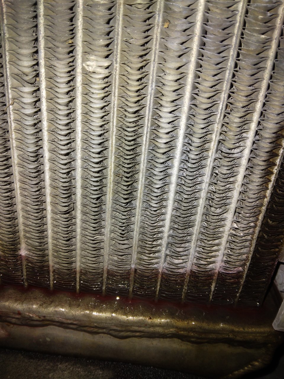

    It is the radiator fluid leaking. It is still pink/red and a little transparent. Has not mixed. Transmission fluid is still red and not milky. Has not mixed. Transmission fluid is also still full. Looking into new radiator tomorrow at napa and autozone. Any suggestions?

    Inside of radiator today at 6:48pm.
    Same color and feel as substance leaking from bottom and substance on the ground.

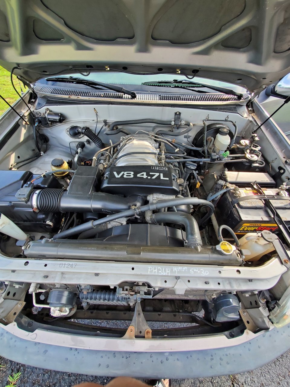

    Just noticed this: you have an aftermarket radiator with aluminum tanks on the top and bottom. I'd be interested to know where it failed after you get it out.

    How do you know its aftermarket? My grandfather said this is the original radiator that came with the truck when he bought it 20 years ago. Never failed or been changed. Straight off the lot. I do not want to replace radiator with a radiator that has plastic on it at all. All aluminum. Any suggestions?

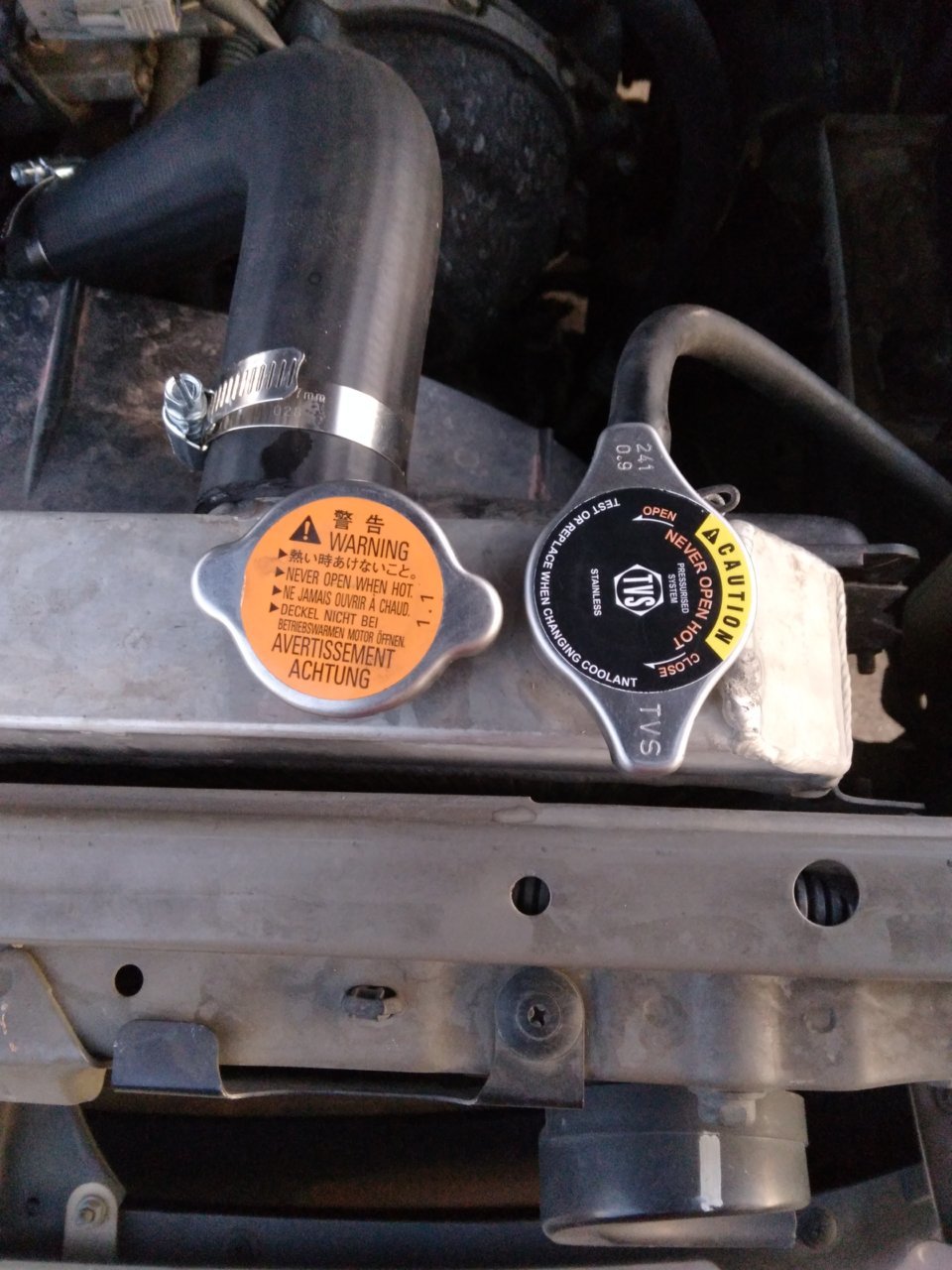

    Take a pic of the radiator from the top with the fill cap visible. That will let us know for sure if it is aftermarket all aluminum or original type.

    The original fill cap i replaced because it wore out. Still will include a photo of it. Hang on

    The original radiator cap wore out and I replaced it with the orange one. The orange one wore out 2 weeks ago and I replaced it with the black one. OEM radiator cap is not shown here because I threw it away after I seen the damage it had.

    Should look similar to this if original.

    Yes definitely aftermarket. Looks like a nice piece it sucks that it's blown out. All aluminum ones are kinda pricey I believe. Most likely have to find one and order. Not gonna be around in any parts store only original type. Someone on here has a aluminum one like yours but I don't remember off hand who it is or what brand it is .
