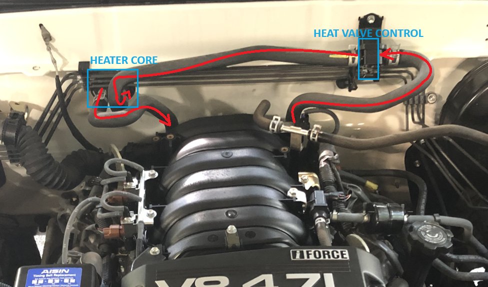

    See this reply for troubleshooting steps: https://www.tundras.com/threads/strange-cooling-system-issue.141181/#post-3553351
    Did you orient the thermostat with its jiggle valve at 12 o'clock +/- 1 o'clock?
    You may have an air bubble somewhere because whoever filled the system didnt properly burp, or because jiggle valve isn't oriented correctly.
    Or it may just be the heat control valve in that picture (see link above) and/or the cable to actuate it isn't working correctly.
    Truck should have red (or pink) coolant only, to avoid buildup in the system that will cause blockages. Can we assume you're not using yellow or other?

    I would bypass the heat control valve (pictured above) just to see if you get heat. If you do, you know either (A) the valve is bad or (B) the control cable isn't functioning as expected.
