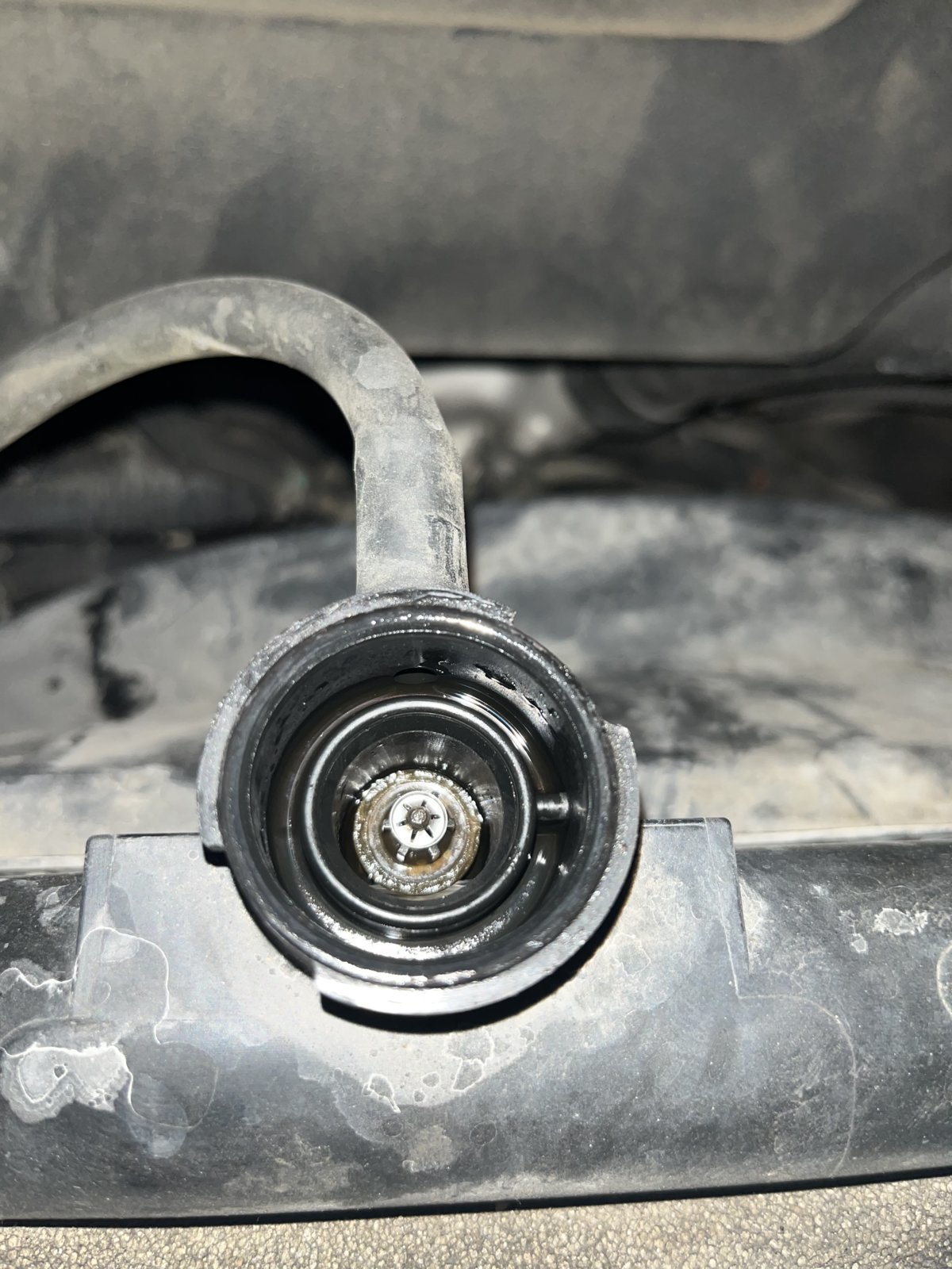

    Today my 2015 started to over heat, and it had no coolant. I refilled and few hours later I went to go check and it’s leaked out and also took radiator cap to check if see if it had any coolant in the radiator, and the cap came apart. The spring and everything else wasn’t attached to the cap.
    There’s coolant on the hose but can’t tell where it’s coming from or where it’s going. There only a few drops on the driveway but may be because when I topped it off, i didn’t have a funnel so it I got some on other engine parts.
    Where could it be leaking into? after I topped it off, I was only able to drive 5 minutes before it told me it was heating up again.
    What could be the problem?

    Remove the oil filler cap. Take a picture of the underside (the engine side) and post it here.

  13. Jan 8, 2024 at 8:18 AM

    Your cap is a pressure relief valve. It is broken in half. Yeah, that is probably the issue.

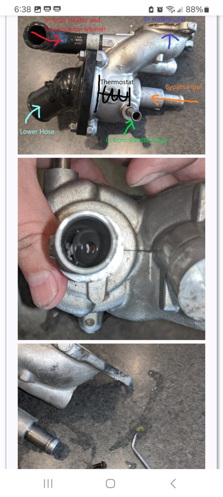

    I replaced it, still running hot. I’m going try to replace the thermostat

  23. Jan 9, 2024 at 3:37 PM
    pwpblue
    pwpblue My ignor list just keeps growing!
    Mar 20, 2023
    #94166
    954
    Greensburg,PA
    2023 Toyota Tundra Platinum ADV
    I think it's part of the thermostat assembly from the pictures. I'm not sure if it is part of the water pump, you'd have to have someone else confirm that.

    It was the thermostat, works fine now.
    Last time I started it, it got to operating temp, then went down, some. thanks everyone
