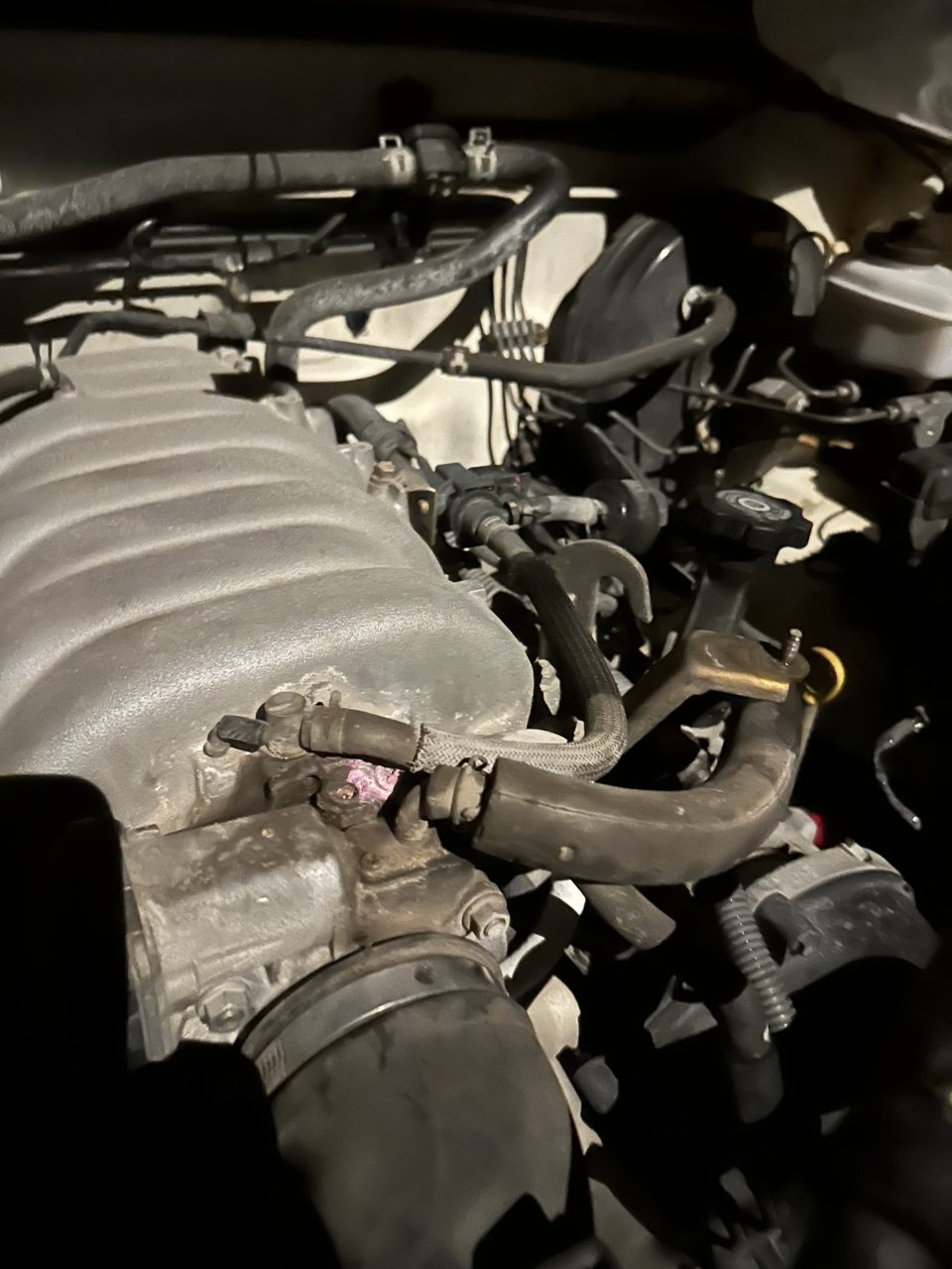

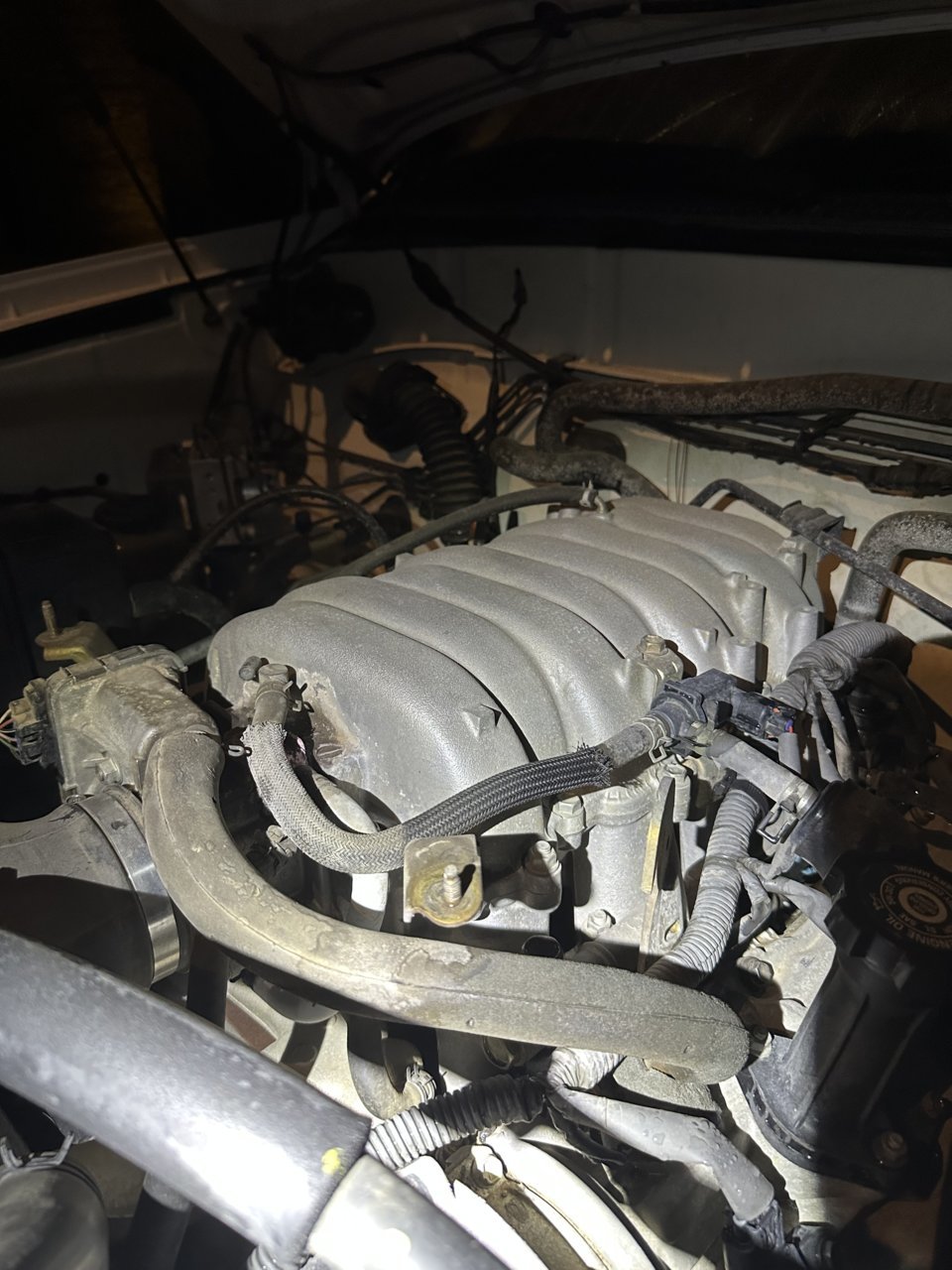

    Hey there-
    Was under the hood yesterday and noticed a small coolant leak. Anyone know what this hose is? 2004 Tundra 4.7L V8. An hour of internet research and I am coming up blank.

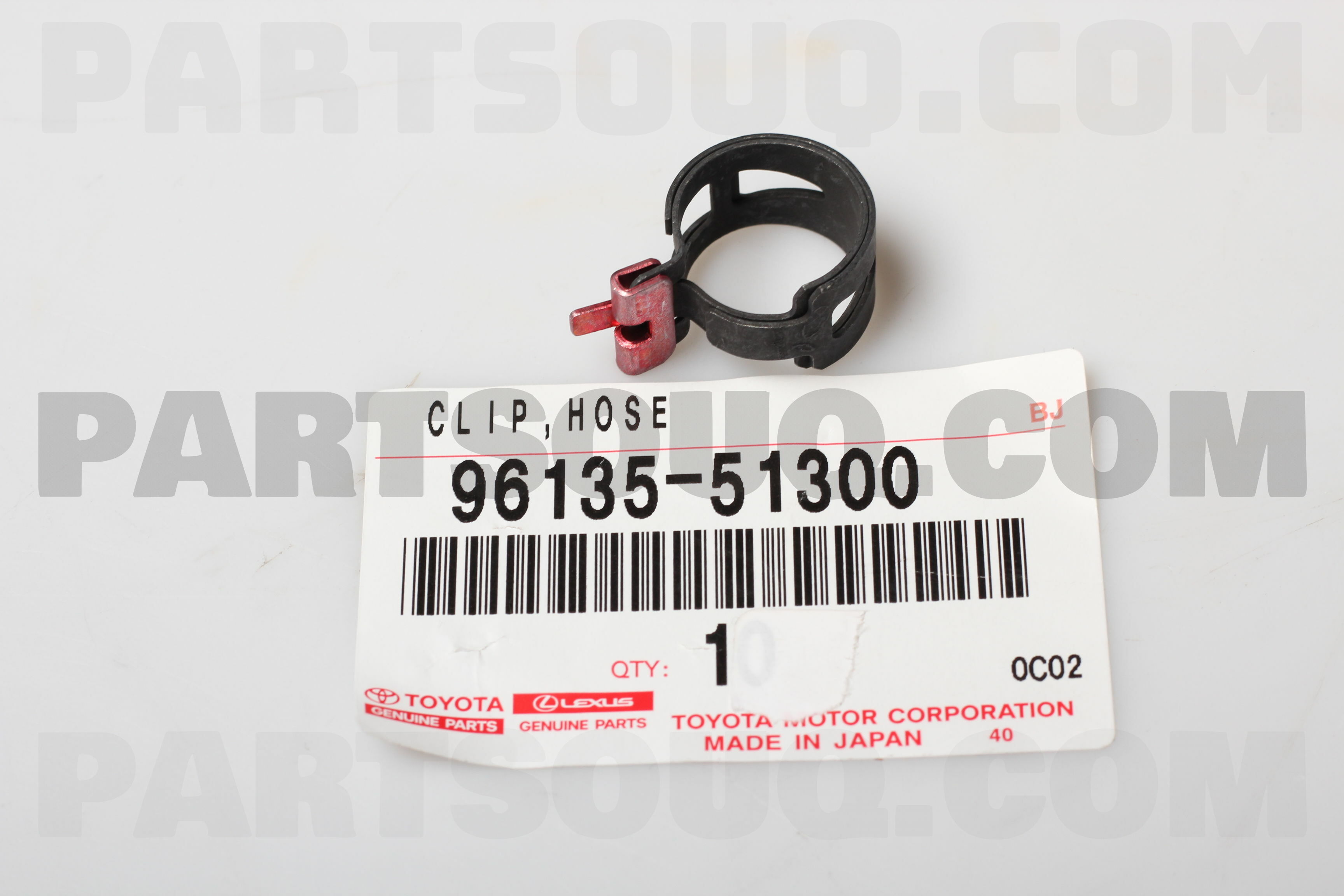

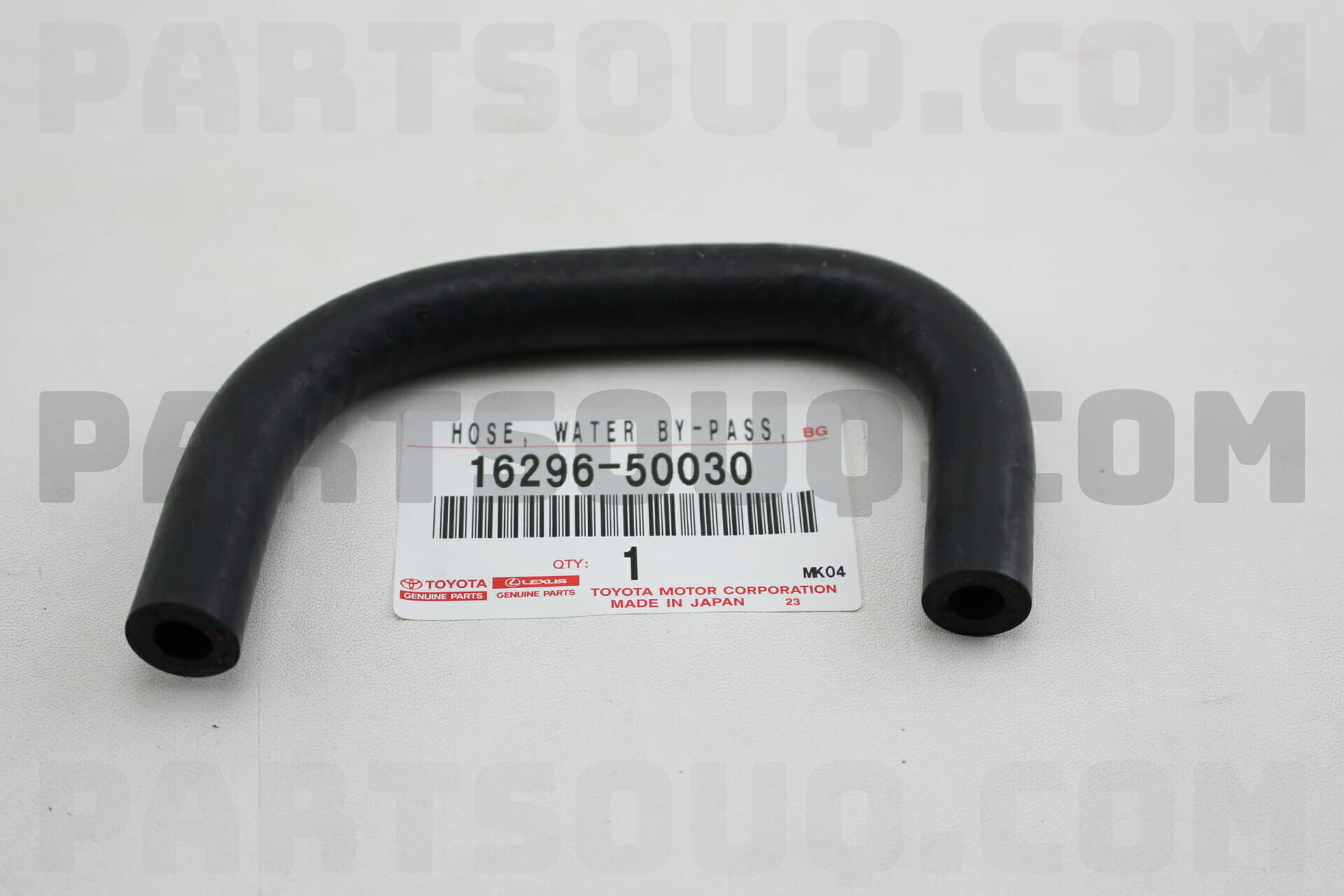

    I do believe that you want this:
    And 2 of these
