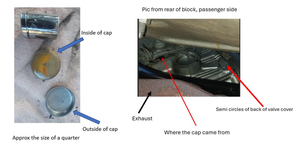

    Hey guys, need some help trying to identify the caps in attached picture please.
    Background- 2002 Tundra V8 4.7L. Started to run hot - replaced the radiator, water pump, thermostat, coolant pipe O ring. During all this, snowmaggedon hit Georgia. The truck sat outside in 13 degrees for 2 days. Today, I get everything buttoned up. Started to fill the radiator and coolant starts pouring out the rear of the block on both sides.
    I put the hose in the radiator, turned on and crawl all over it above and below. I find these caps "blown" out of the rear of the block with water dumping (not leaking) out. These are located below the valve covers, basically behind where the pistons are. I can't find any diagram in the book or online labeling what these are.
    This did not happen prior to the cold snap. I had originally tried a flush, then replaced the water pump and those caps were still in place. I assume the lack of coolant and residual water caused the blow out.
    Can anyone help identify these and what are they held in with? The caps are very clean around the edges (no sealant or gasket leftover). They're about the size of a quarter. The attached pic is from the passenger side, looking up past the exhaust system. The driver side is basically a mirror image.

    Freeze plugs. Although not a reliable method to prevent cracked block. I’ve always used Permatex Indian Head shellac in the brown bottle on mine. Best wishes…
