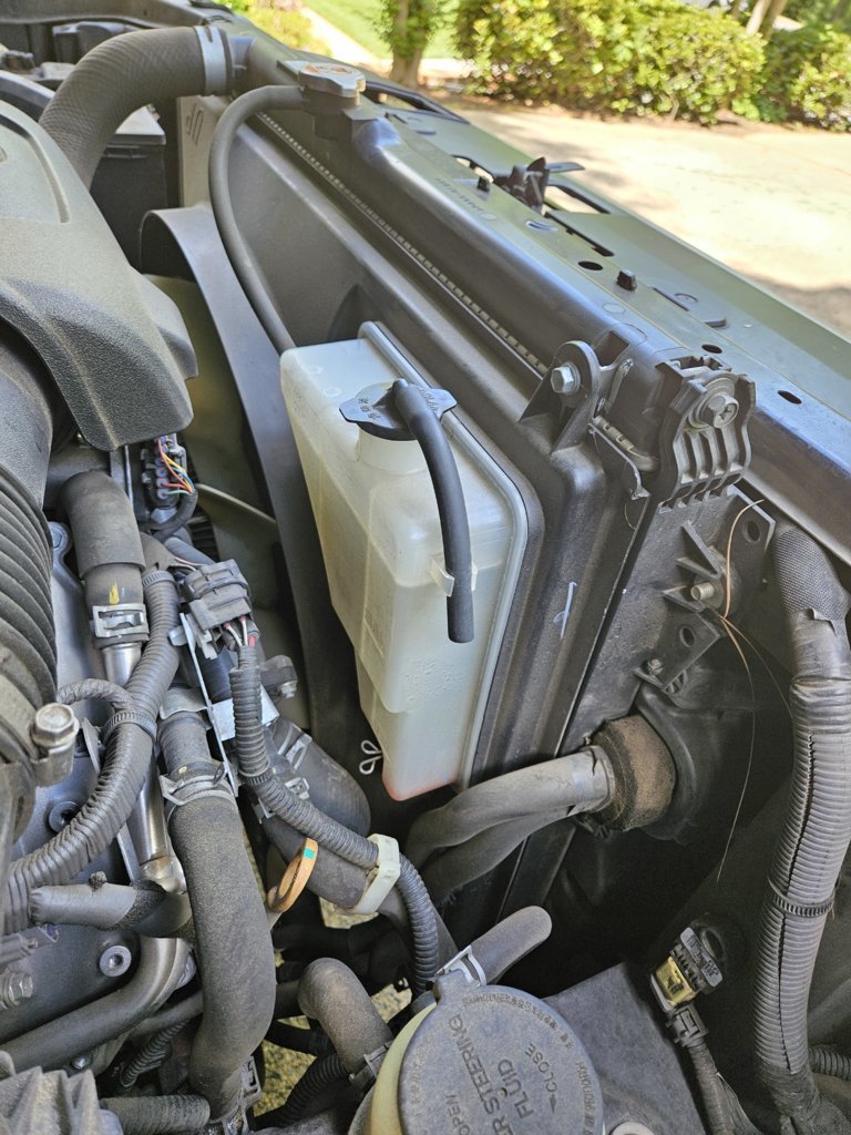

    I'm needing some direction here. After being filled to the cool line, my coolant drops in the span of about 400 miles. No sign of leaks anywhere, no smell of coolant anywhere, no sign of it burning in the exhaust, it's like it just vanishes.
    Once it reaches this level at the bottom of the reservoir it doesn't go any lower. There is no boiling, bubbling, nothing. Coolant temps are normal and nothing seems effected by it, but I'm trying to figure out where to start here. I don't want to start pulling things apart if someone's seen this before. I'm used to coolant issues being pretty straightforward to diagnose but I'm scratching my head here. Maybe I'm just missing something.

    You might check to coolant level in the radiator once the overflow tank is empty and your engine is at ambient temps.

    Coolant will evaporate, but not that quick. If it was every couple of years I would say it's kinda normal.
    Check the weep hole on the bottom of the water pump closely. Second check for slow leaks that might be getting evaporated off due to a hot engine. Last, get a pressure test done (or do it yourself). This will let you know if a head gasket has met the end of life.

    I'll check that when I get home, good call.
    Yeah it's too fast which has me nervous. I took a look around and there's no sign of a leak anywhere, but I'll get in deeper and check that weep. I just changed the oil about a month ago and levels and color were normal, so I doubt it's a head gasket, but I'll run it just in case.

    Overflow tank can’t get lower than that.
    Look for obvious leaks on all the coolant plumbing; hopefully no sweet coolant smell in the cabin. Check for valley plate heat exchanger leak… it’s hard to see directly; tell tale sign will be coolant streaks on the back of the engine to transmission bell housing

    Get a mirror and good light. Those leaks can be on the block or a hose fitting. Seen it a lot over the years.
    You will not always see a head gasket leak in your oil if the gasket is leaking a small amount into the combustion chamber. This usually starts out slow and then goes very suddenly.
    A pressure test and coolant test will tell you everything you need to know. Here is the combustion gas tester you can easily do yourself for pretty cheap. Sometimes you can get the pressure tester and gas tester in a combo deal.
