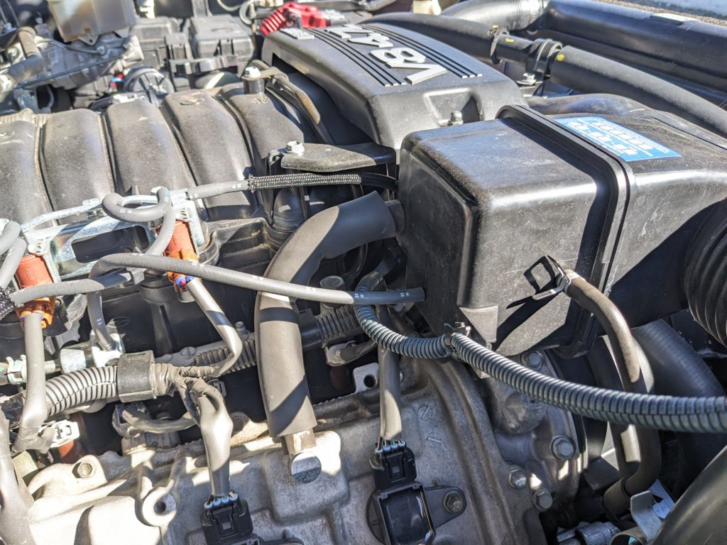

    Northern California

    There's a 1GT for sale I'm looking at that has an Airaid CAI assembly, and that won't fly here in CA, and from what I've read the OEM CAI is the best option anyway.
    Besides switching out the assembly, do the aftermarket units use less vacuum lines or any other issues I should consider?

    There's been a deep dive on airaid CAIs lately.
    All vacuum lines that go to the Airaid unit, if set up correctly, will go to the stock air system.
    You'll have the valve cover breather going into the largest port on the baffle, and then the two that are barb fitting'd (I'm assuming) into 1 will go into their own respective ports. Fuel rail on the back, PS pump on the side.
    Note that you CAN use the stock air box and filter and use an just use the Airaid tube. You will need a 3.5" diameter by 3" long hump hose to connect the box to the tube. This would basically create an Airaid Jr kit.
    Edit. All of this assumes a common Airaid kit. If you can take a photo or specify the kit number yourself, we can possibly verify

    This is good info, thanks.
    If you plug in a 2006 Tundra SR5 dbl cab 4X4 V8 into the Airaid website it says they don't even make a product for that vehicle, but it does list one CAI assembly for a 2004 with the same specs.

    Their website is all messed up.
    It's probably similar to airaid 510-173? You should be able to find schematics based on that. The 510 can change based on filter media, but other components are the same. Stock air box ones are variations on 511-781
