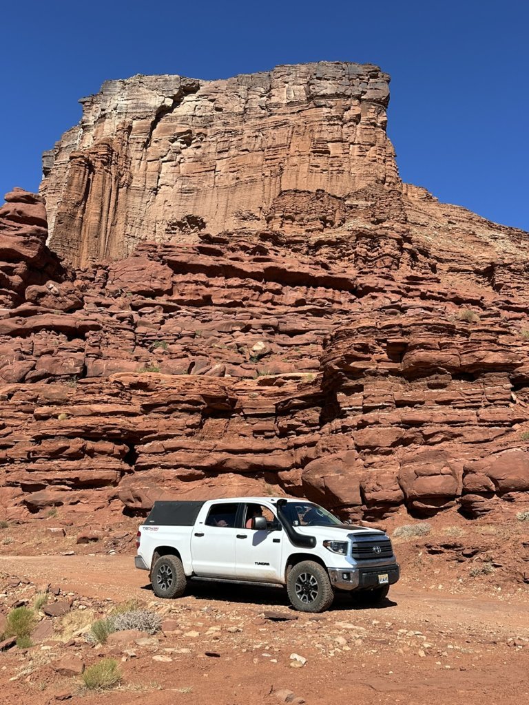

    And just for good measure, a pic from our Utah trip mentioned above.
