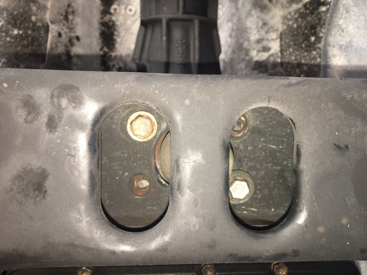

    I found the culprit, the 4 bolts that hold the tranny mount to the crossmember were missing!!
    I popped in 2 for now, the creaking is gone.

    Dang! Didn't see that one coming. Good thing you didn't replace the control arms. Nice catch.

    Hey @cardiac there's actually a TSB for this if your truck is 2WD. More info in my reply (2nd reply in the thread) over here: https://www.tundras.com/threads/driveline-clunk-found.104760/
    Simply reinstalling the bolts and/or re-torque isn't seen as a "fix" at Toyota.

    Someone bought the 'updated' TSB crossmember, mount and bolts. Iirc the crossmember (and maybe mount) appeared identical.
    I bought the updated bolts for mine but haven't put them in. The old ones with blue locktite are still there. Mine were all loose originally.
    FrenchToasty and shifty`[QUOTED] like this.

    Maybe a naive assessment on my part, but I'm assuming while they may appear the same, there are material differences.
    I have my suspicions whatever the substrate is they used on the original mount has lower longevity, and that was the cause of the full xmember replacement. But w/o seeing with my own eyes....
