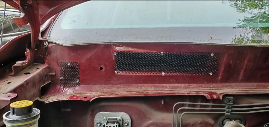

    @Slim Gym cover up the access points they come in from the air cabin vent intake. Under the cowl. How's the cabin air filter?

    I have been thinking of this. Looks like a lot of work to remove everything to get to the air holes in the firewall. How bad was it to remove all the stuff to get to these holes?

    It's not too bad. I've disassembled it a few times. Just getting the wiper splines lined up took the longest.

    Cool. I have been wanting to remove the plastic piece that has faded and treat it with a new black trim refresher product that I bought. Supposed to reblack the trim and last a long time.
    Might put some painter's tape on windshield at top edge of wiper blade before I remove them to make it easier to reinstall in the right spot.
    But I will feel a lot better knowing that the screens are stopping rodents from entering the truck.

    There's a rodent thread somewhere. My highlander last year had a chipmunk family under the cowl. Before blocking I would turn recirc on to block vent but once open it all goes to the filter. Big PIA!

    Bastages! See this thread for more info on blocking the entryways from the engine bay.
