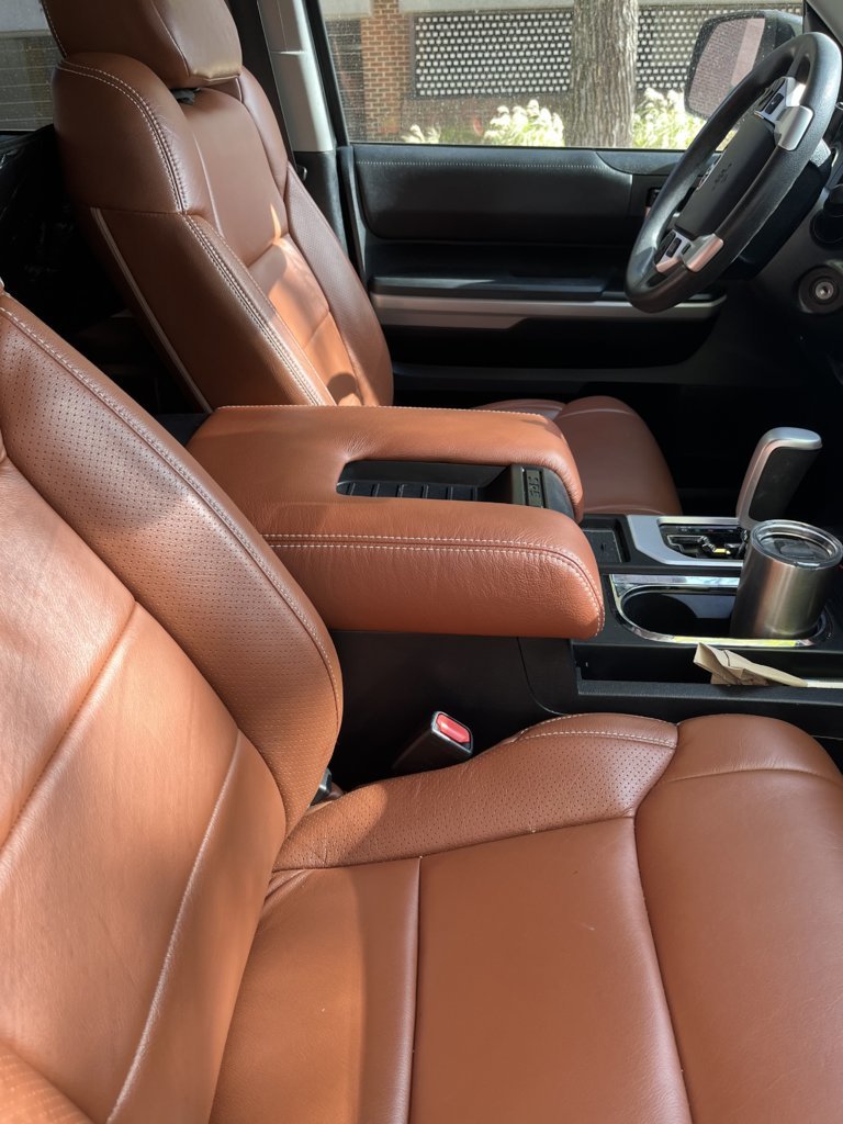

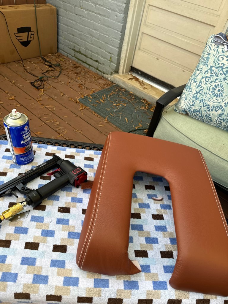

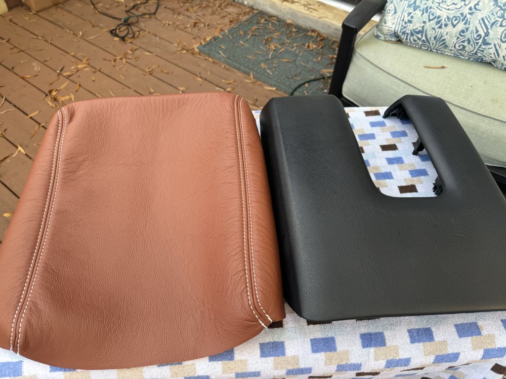

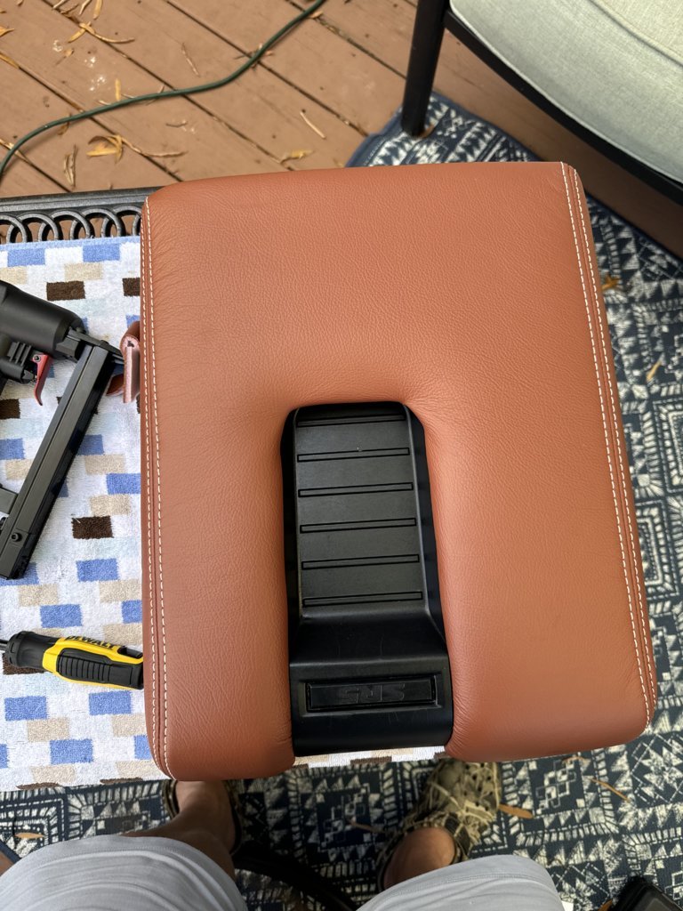

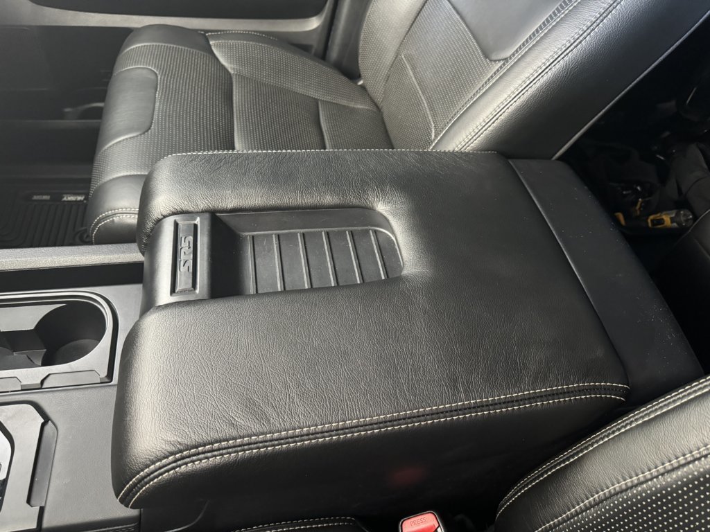

    Well, I’ve seen a few others on here with the same issue but the vinyl for the console lid on my 2019 SR5 finally pulled away. I made the issue more complicated because I have katskinz and wanted my console to match the seats. I got some samples from leatherseats.com and had them make me a cover for about $100. Happy to share the process with anyone that wants to know, but would recommend this company to others as they were extremely helpful. IMG_0992.jpg camphoto_684387517.jpg IMG_0994.jpg IMG_0019.jpg

    Came out great! I'm in a similar situation but when I watched the reupholster process video it looked like more work than I'm motivated to do. Based on your post I may just take the plunge.

    I’ll say, I was a bit hesitant to jump in and do it but once I actually sat down it only took a little over an hour to do.

    Nicely done.
    Did you remove the entire old cover?
    Spay adhesive everywhere or just certain areas?
    I'm about do do mine with an Amazon replacement.

    I barely used any spray, just where it has to be fixed for the phone insert. It’s all upholstery staples.

    Very nicely done! Did you follow a video or other instruction or did you just dive in and mimic the factory assembly?

    Followed the vid, the problem with factory assembly (and why we are in this boat) they just glued the thing and it’s not enough to keep it intact. It needs the staples as well or you will just be in the same boat.

    My 2018 has really hung on. It matches the black Katzkin I put in closely enough that it's never bothered me, but I just know that eventually my vinyl is going to start to pull loose.

    Jealous, don’t have a shop close by. I will say this is definitely better than factory and more comfortable.

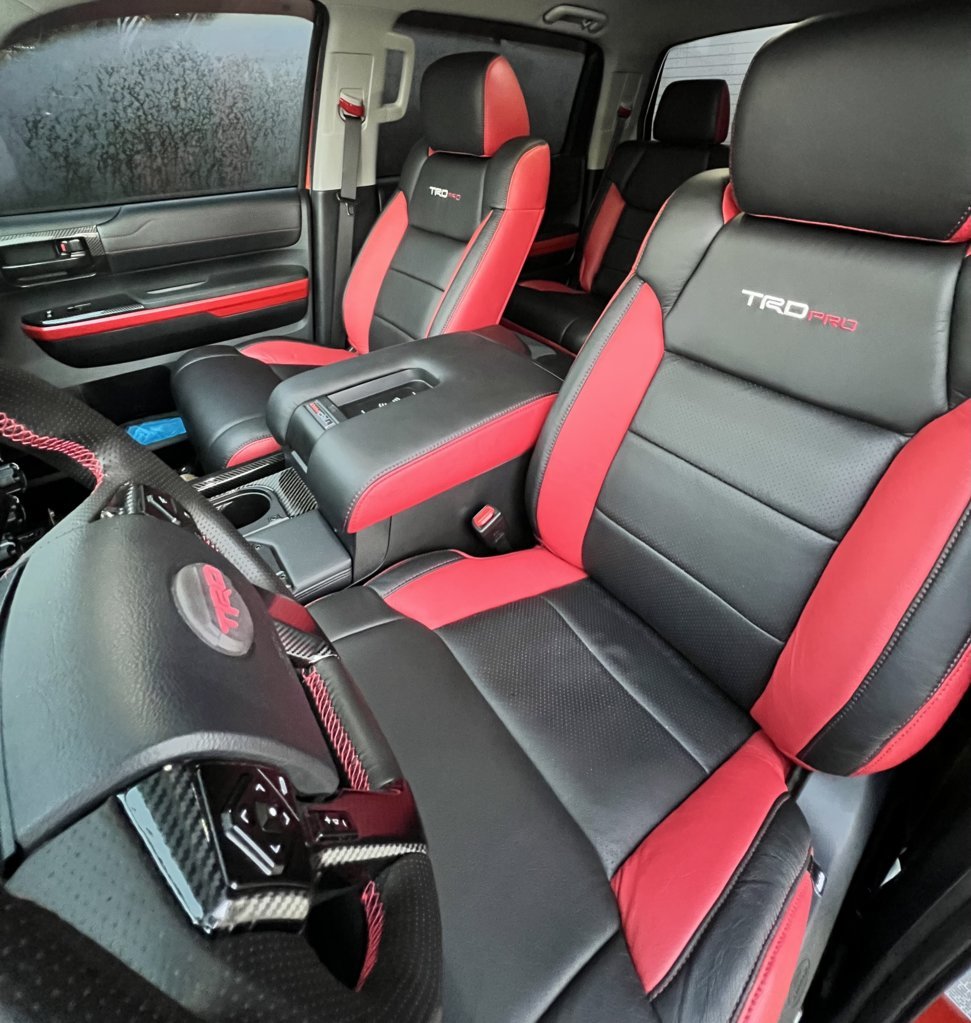

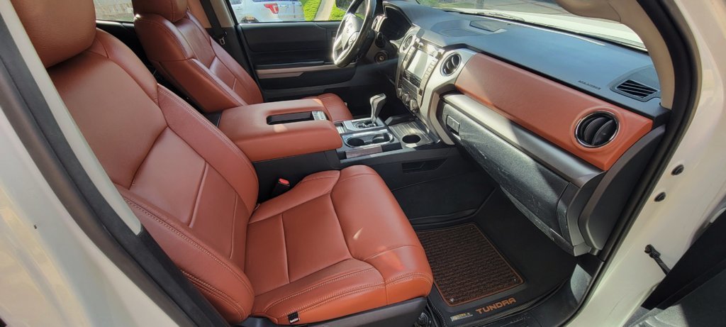

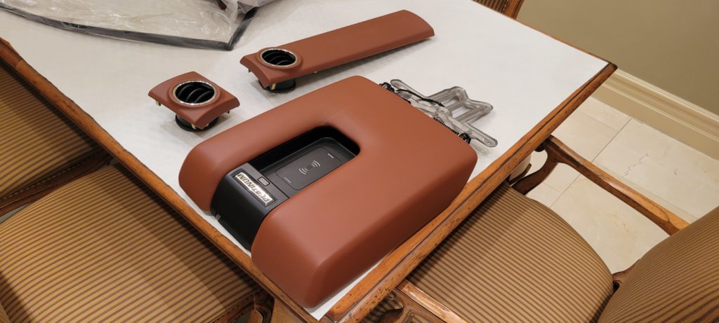

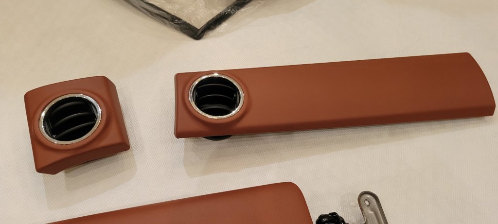

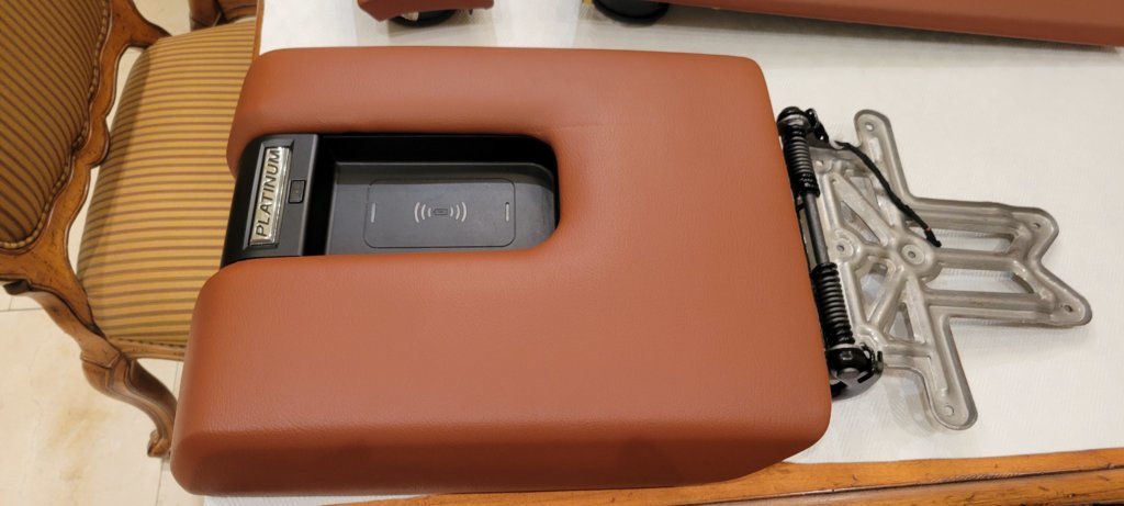

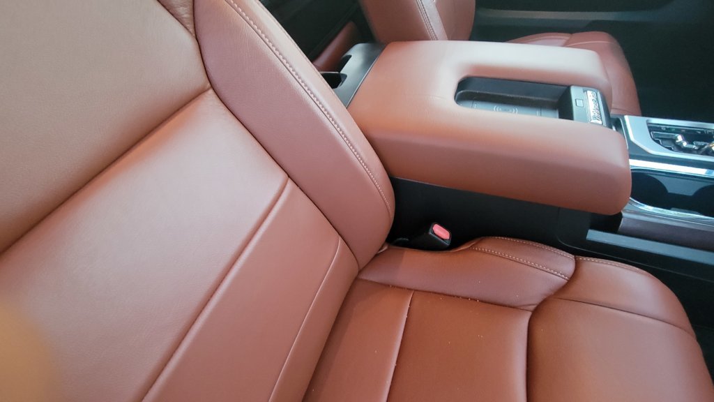

    Nice job! I ordered a custom leather cover from them as well to match my Katzkin seats.IMG_1072.jpg IMG_1076.jpg

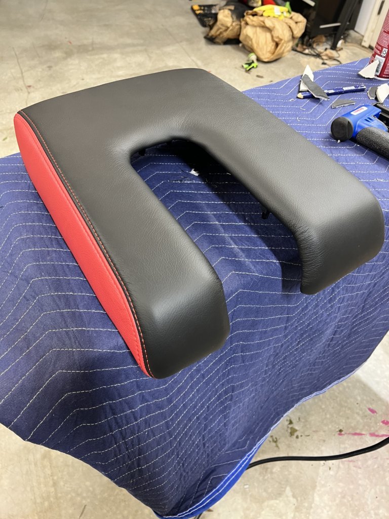

    Also did this mod and had them match colors from my katskin seats.
    I've had it 2 or so months and its holding up amazing thus far. Seats are holding up great too after a year
