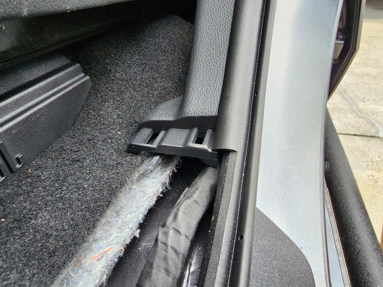

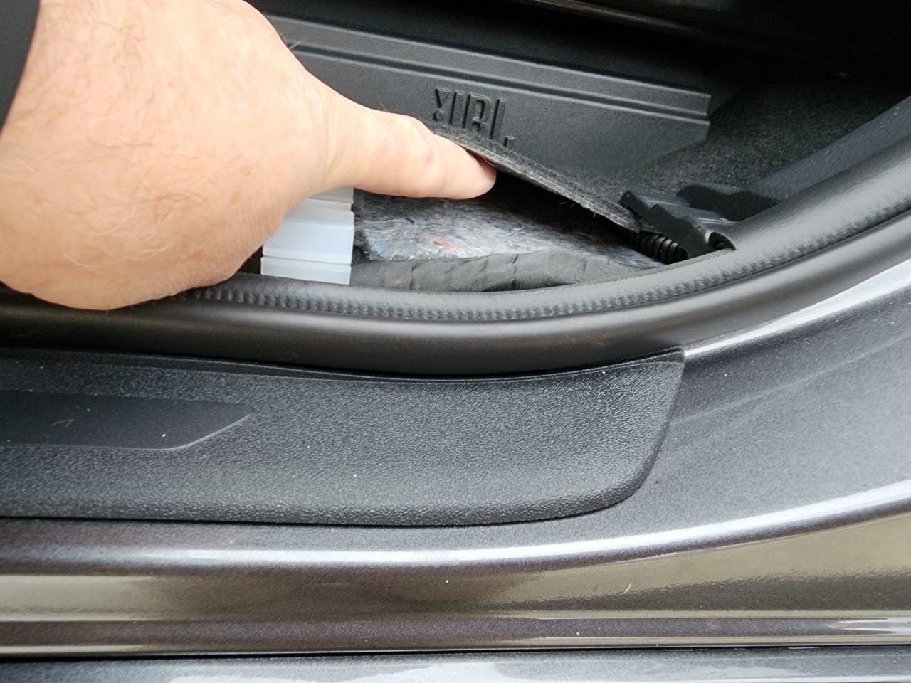

    I will share some photos later today but I finally found the plug under the driver's seat and was able to access it without removing anything except the popup kick panel. From there I just reached my hand under the carpet and pulled the wiring through and ran it down the drip channel to the back seat and up to the battery. Thanks, everyone for the info!

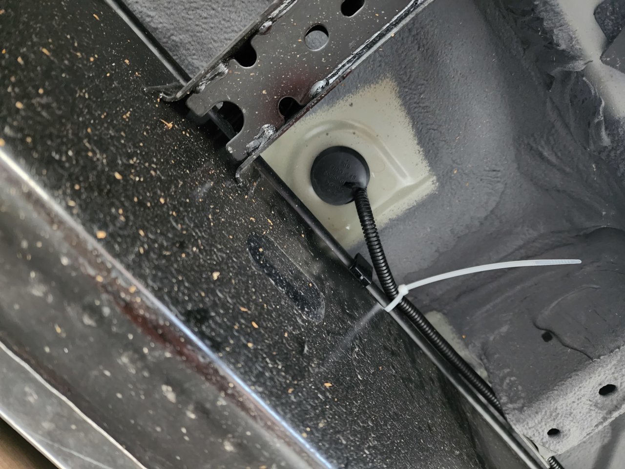

    Pretty simple photos but there is a plug that you can easily reach from under the drivers seat in between the carpet and the padding. Just pull the wire up through the hole and run down the drain/wire channel under the plastic trim to the back seat and then up through the carpet into the battery. It was MUCH easier than I thought it would be you just have to make sure that the plug goes back in to prevent water from getting into the cab. If anyone wants more info I will be glad to post more photos. Thanks again for the suggestions!!

    You will want to silicone around your wire really well, not just around the loom. Water will work its way up and into the cab.

    YUP, I do plan on doing that just didn't have the stuff to do it at the time.
