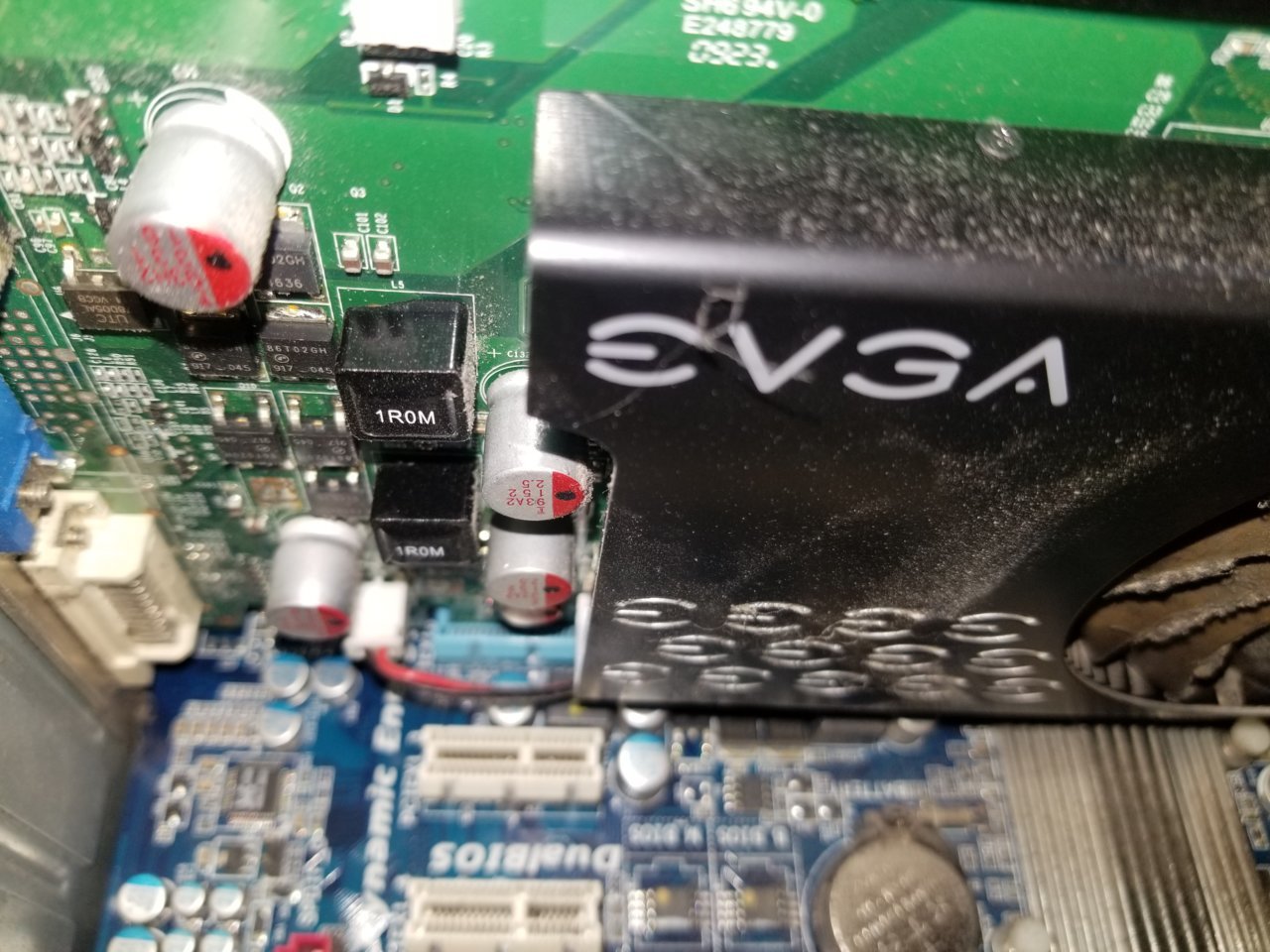

Computer savvy people. Couple simple questions....

    Depending on how much the power supply is...it's worth a try. Even if overbuilt, it's still a 10 year old machine and likely not dumping tons of money into.

    If it's not turning on, the power supply is probably the culprit. Is there a Bestbuy near you? Often times you can take it there and they can trouble shoot it for you for pretty cheap. Especially if you are wanting to sell after. They can wipe and reset to factor settings.

    Hate to be that guy but if your plan is to sell it then just get rid of it is my suggestion. The power supply will cost more than what you’ll get for the whole computer.
    The thing is very old and you might get $50. The operating systems that thing can support are no longer supported by Windows.

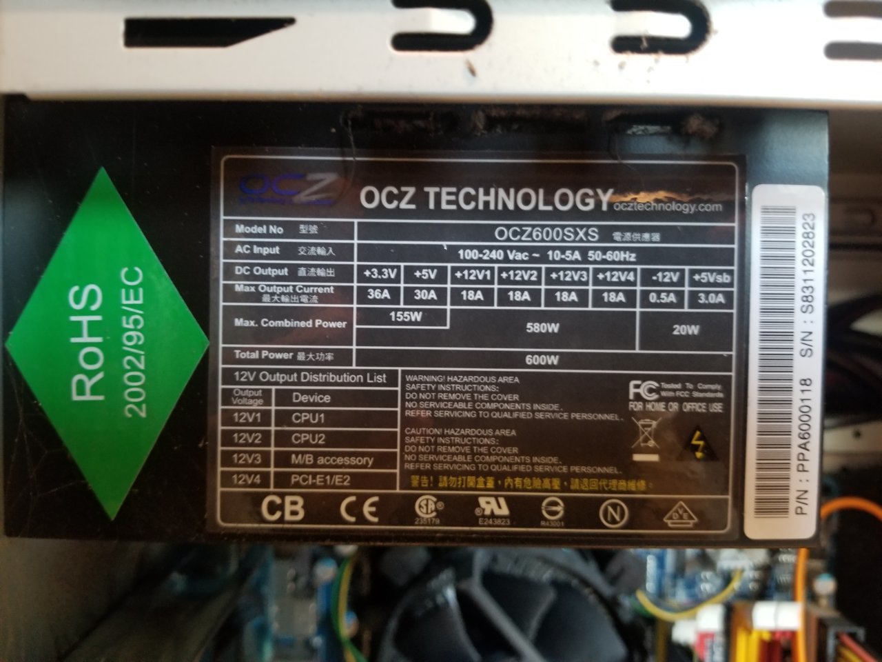

    You're gonna think I'm nuts, but if you want to know for darn sure if it's the power supply, you can do this:
    1. Remove power from the power supply. (Unplug the power cord.)
    2. Unplug ALL of the plugs coming from the power supply to the motherboard (noting where they are), DVD/CD drives, etc., so the power supply is isolated.
    (This is the part where people usually crap their pants. LOL)
    3. Find one of those 'coated' paperclips (plastic coating on it).
    4. Take the biggest plug (the one to the right of the fan in the 3rd picture), bend the paperclip into a "U" shape, insert one end into one of the black wires, and the other into the green wire.
    4. Plug power back into the power supply.
    What this does:
    You're essentially jumpering the power supply 'on' by connecting the green wire with one of the black wires. It's not at all a high voltage, though as with anything, caution is always recommended. But yeah, if you do this and it *STILL* doesn't turn on, with the power supply completely isolated, obviously it's bad. If it DOES turn on, then the motherboard itself may be bad.

    Yep, done it literally 100's of times. (Both the freezer hard drive trick and the paperclip trick.) It's all but impossible to screw up and you're dealing with a whopping +5V. Besides, the point of it isn't to test the voltage; it's to jumper the P/S on without it being attached to anything to see if the P/S is the issue, or something else (e.g., motherboard short or something).

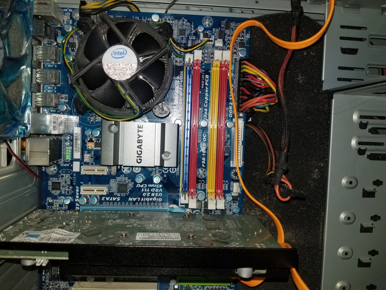

    Unfortunately, I have to agree, PC tech evolves so quickly, this machine is considered obsolete. It may be best to retire it.
    For a socket 775, it's probably at best a Core 2 Quad processor. Max supported memory will probably by in the 8 to 16Gb ballpark. It will probably run Win 10 but still a risk with driver support, etc. Gigabyte shows first manual published early 2009, and only offers drivers up through Win 7.
    You might inspect the capacitors on the motherboard really close to see if any have puffed up, from the ones I can see in the photo, they seem ok, but there may be more obscured by wiring. Also, you might even try pulling the EVGA video card temporarily to see if it will power up without it. I've seem my fair share of bad caps on motherboards and video cards, especially EVGA in that time period.
