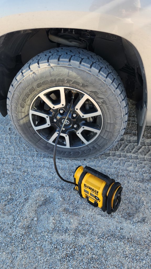

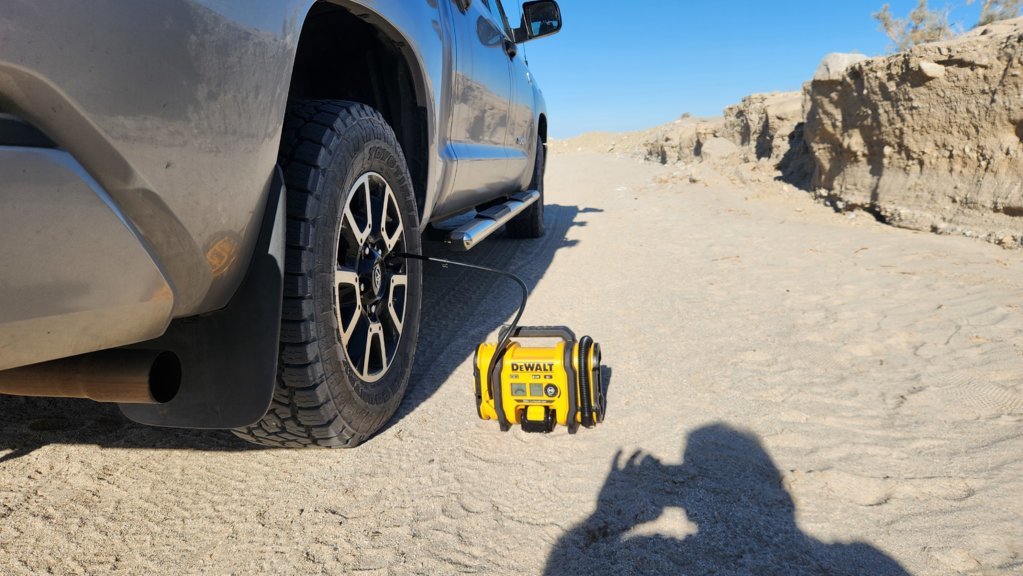

    I really like my DeWalt 20V cordless inflator.
    I have other DeWalt 20V tools and multiple batteries so it made sense.
    The versatility and portability is nice, set it right next to trailer or truck or bike tire you're filliing.
    Battery life is pretty good, I can go from 20 to 36 psi on the truck tires after exploring and still have plenty of battery left.
    bflooks, Tunrod and 1lowlife like this.
