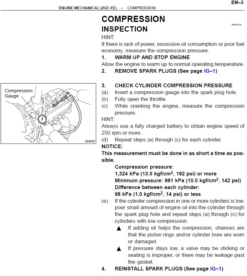

    Recently purchased an 01 Tundra and the engine sounds great. I did a compression test and the average compression is 169 after 4 cranks and 195 max, after 8-9.
    I have seen a spec of Std. 192 and Min. 145, but does anyone know how many cranks this refers to?
    Just trying to figure out if this engine is worn

    Here's what the service manual says.

    Sounds like you are golden per Festers post.

    Nice! Wanted to be sure I'm working with a good engine before I pour money into fixing the suspension.
