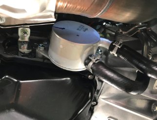

    Thanks for the response. Here's the thing, I had to rebuild my engine after the truck rolled into an over-flowing river. I'm afraid I got water and silt into the transmission and possibly torque converter. Which is why I want to flush all nearly 14 quarts of transmission fluid. Im thinking of disconnecting each hose to coming out of the pan, turning on the engine, and seeing which one is the return. Then treating it like I would the cooling loop. Theory and videos seem to indicate I can flush all fluid in the system, including the torque converter, this way. I'll take photos. Still open to advice, though.

    Those hoses have coolant - not ATF.

    So the Transmission heating system works by taking coolant to the tranny, not ATF to the engine block? tundra.png

    Yes, the two lines you see there are coolant lines and the puck shaped thing is a heat exchanger to warm/cool ATF relative to coolant temp.

    Ok. Verified. Which brings me back to my original question, How do I flush the entire system, including the torque converter, without any supply/return loop outside the transmission? Correct me here if I'm wrong, but all ATF fluid is contained within the tranny.
    I might be left with simply draining and filling the pan, running the engine while cycling through Drive/Neutral/Reverse, for 15-20 seconds, then draining and filling the pan again. Repeating this process until the ATF fluid draining out of the pan looks consistently new.

    I’ve only seen methods to DIY flush using the trans cooler, which you don’t have based on your picture. I’d try multiple fill and drain cycles with less expensive WS compatible fluid (maybe three) then two with your WS ATF of choice. I’d do more than warm it up, maybe drive it a week between. It’s probably overkill but learning transmissions seem to like gradual fluid changes.
