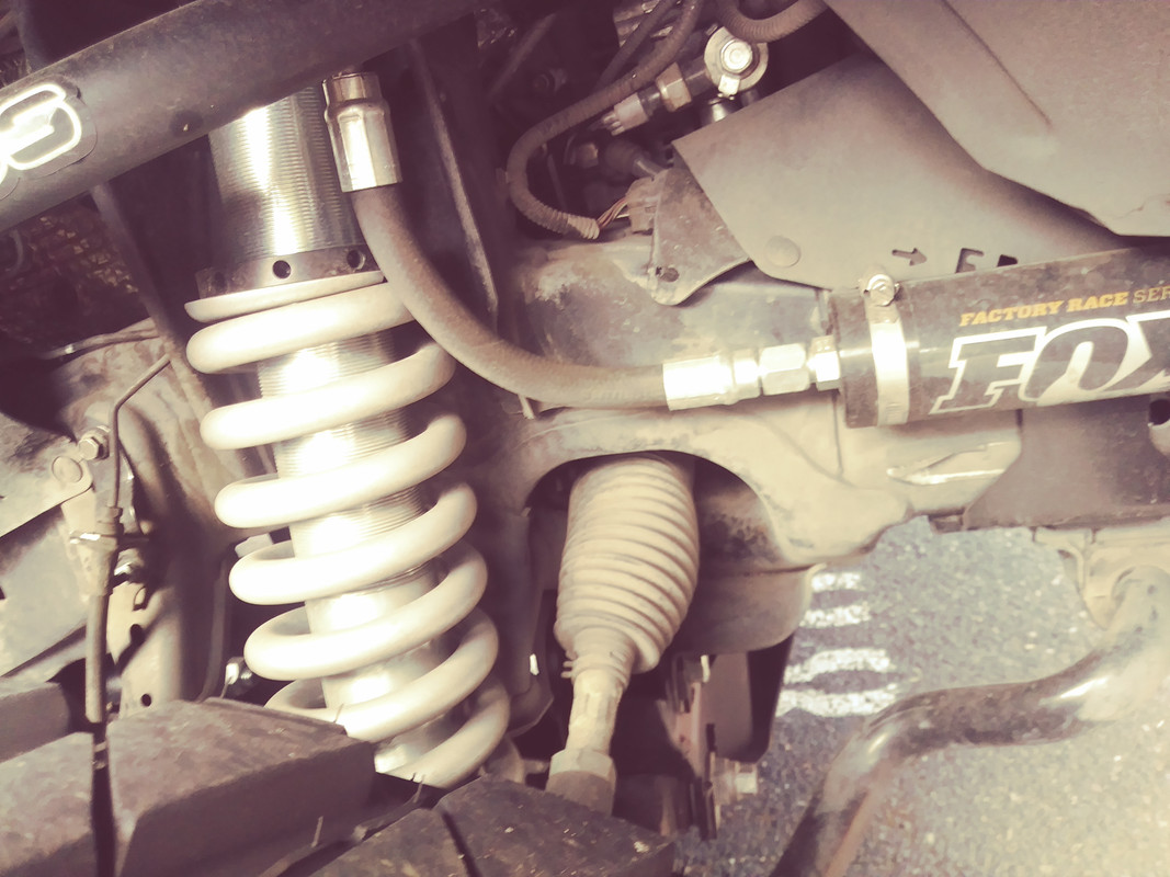

    Here are the Toytec Boss on mine getting ready to do Shackles in the rear and max my front up to the full 3” lift
    4EC7BB5F-0646-40F5-9624-71489F597DC8.jpg 973F4D57-E7D3-4E1E-BDB8-7177F1EF8082.jpg A18DF9A3-A411-4C57-AEF9-A2F8C45A7665.jpg
