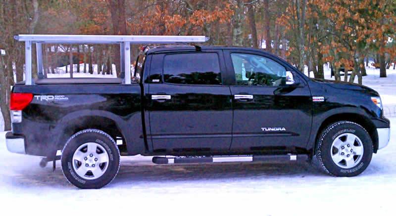

    I didn't have the will to buy the only pre-made metal rack that fits my '15 Crewmax, $988[Galleon Truck Rack from USRacks illustrated], so built one of scrap lumber.
    Back uprights are 30 3/4" o.a., with 6 1/4" bed pocket extensions; with 14" pieces screwed on outboard of them...the tops rise up 2 1/2" above the cross-piece...to act as load stops. The four 2 x 4s were literally laying on the ground under a snowpile til 2 weeks ago. Applied lots of linseed oil and Briwax to renew the dried-out wood.
    Front uprights are 6" logs milled in half(36 3/4" o.a.), flat side in, with notches 6" from top, 1 1/4" deep, to accept horizontal 2 x 4s. Gives me a 4 1/2" load stop...built-in using one piece of wood instead of two. I used a draw knife to shape them a little. A normal person would've used a table saw to mill out the built-in bed-pocket extensions - but I did it with a skillsaw/draw knife/hammer/chisel/horseshoe rasp. Location had to be precise to not hang out, not be in the way of the tonneau cover, not be too wide to fit in the stake pocket, or too deep. Stained them with 1-step stain/seal for decks. These half-logs were in the scrap pile at work.
    Finished by putting on two 2 x 4s horizontally as cross-pieces(torx screws) and four 1.5" lag screws in the holes provided to anchor the uprights. I wind up with 24 1/2" of rise above the bedrails and 5 1/2" above the 19" cab height. Tried it out today on a 50-mile trip and all is well.

    Decided to get a U.S. Racks rack after all.
    Pretty well engineered, made in USA, lots of aluminum and stainless steel and matches my Silver Sky Metallic Tundra. Assembling it is a trip, though. Shipping weight with 8 canoe brackets thrown-in was 106 pounds.
