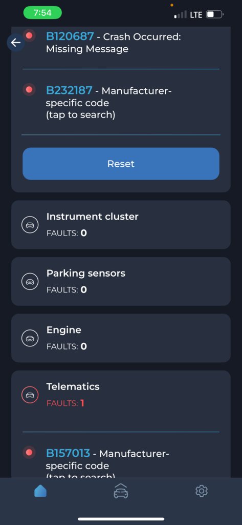

    This happened at startup maybe 6-8 weeks ago. I went to the dealer and the service lady said it was from the car wash I went through with the collision sensors and nothing was to worry about. I bought it and went on. Now, over the last week while up in Bowling Green, KY it has happened many times. It seems like 60% of the time now. Has anyone else had this occur?
    I plan to go to the dealer this week and demand they look into the codes, as there must be something showing somewhere.
    Thanks in advance for any insight,

    I took it in today. Played the audio recording for the service advisor. He wanted to keep the truck for a while after looking up my records on his computer for my startups. He saw nothing for what I was hearing in their system. I really thought there would have been something. But not.
    The mechanic had it running for a while and heard nothing. I then emphasized it was only at start up. They had went through more start cycles with no failures reported.
    The tech was there when I picked up my truck to talk with me more. He stated that it may be where I used the power feed above the rear view mirror for my dash cam, possibly. He suggested I disconnect it for some time to see if it returns. Oddly, it has only happened once since I have been back home from Kentucky. This is a strange one to me for sure.
