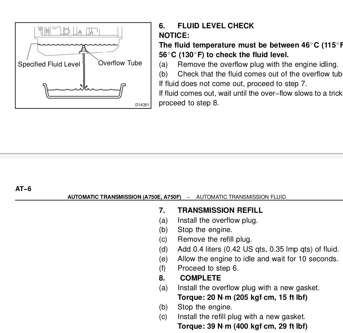

    04 double cabs have unique, 1 year only headlight housings.
    5 speed transmission are not hard to check.
    FLUID LEVEL CHECK
    NOTICE:
    The fluid temperature must be between 46C (115F) and
    56C (130F) to check the fluid level.
    (a) Remove the overflow plug with the engine idling.
    (b) Check that the fluid comes out of the overflow tube.
    If fluid does not come out, proceed to step 7.
    If fluid comes out, wait until the over−flow slows to a trickle and
    proceed to step 8.
    Did the first million mile tundra have the air injection pump? I think it did.

    Correct, the 5 speeds are not difficult. I have serviced quite a few. Most modern auto transmissions use very similar methods now.
    But its much simpler when there is a dipstick accessible from under the hood. After draining and reinstalling the plug, all you need is a funnel to add fluid.
    They’re all good, but I just mentioned my preference. Ease of checking and servicing is always good.
