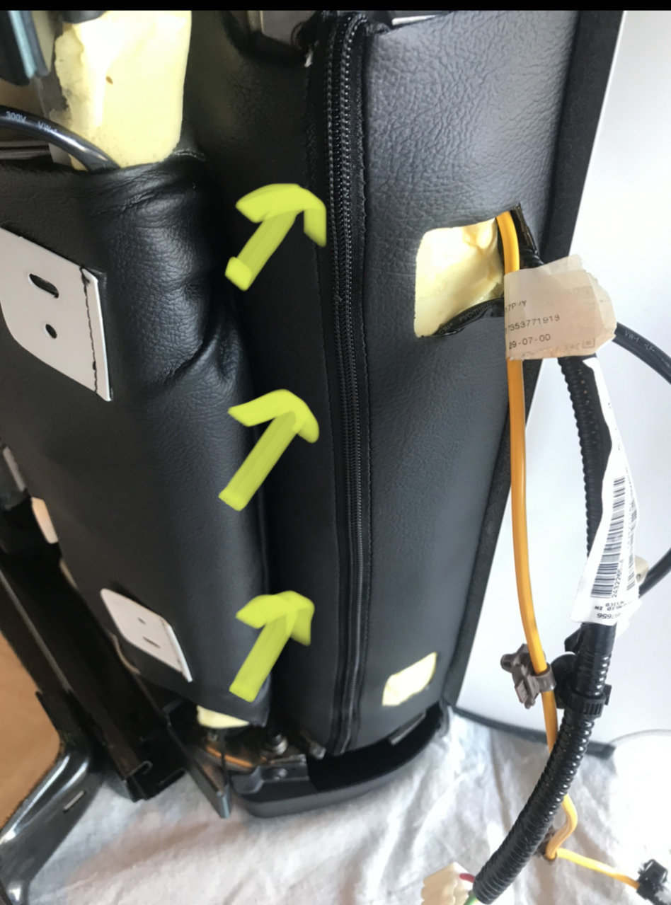

    The bottom edge of the seat back is normally invisible, because it is tucked under- in the seam created by the seatback and the seat bottom resting together. Along the seatbacks underside edge, there is a zipper. I have indicated that zipper here with green arrows:
    Once unzipped, you should be able to pull/tug/roll the seatback upholstery up and out of the way. I believe you would “get at” the lumbar adjustment hardware from the back.
    After you’ve done the dicking around that you want to, you’ll need to reposition the upholstery and then line up that zipper and zip the seatback back up. Probably harder than it sounds.
    If you’ve ever zipped up a jacket that you’re not wearing, it can be awkward. Also, this zipper will be nearly upside down and likely in a tight space. Also, these are not beefy zippers, and the upholstery is a tight fit. You could be in for a fight and you DONT want to damage that zipper.
    Getting that seat out and onto a sheet of plywood on some sawhorses puts the work at waist height, and you can turn the seat this way and that more easily.
