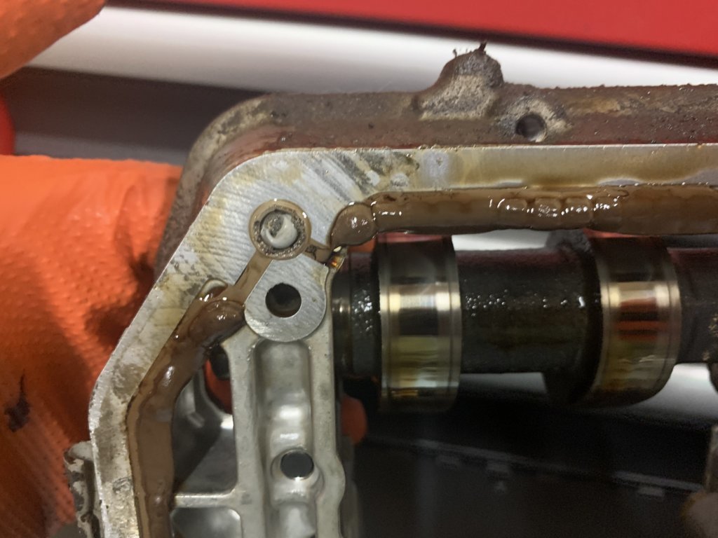

    It’s a machine process error - too little sealant on the back corner of the cam tower. It’s not really related to miles or hard use, per say. Mine also had some rough machining marks in that spot on the cam tower. At 230k miles, it was still barely a weep. Adding a SC didn’t seem to affect it any; it was already weeping before that.

    And to speak to those asking about how common or early OP's leak is, I've seen them leak and drip before the first oil change. I've personally done about 2 dozen, some under warranty, some under CP.
