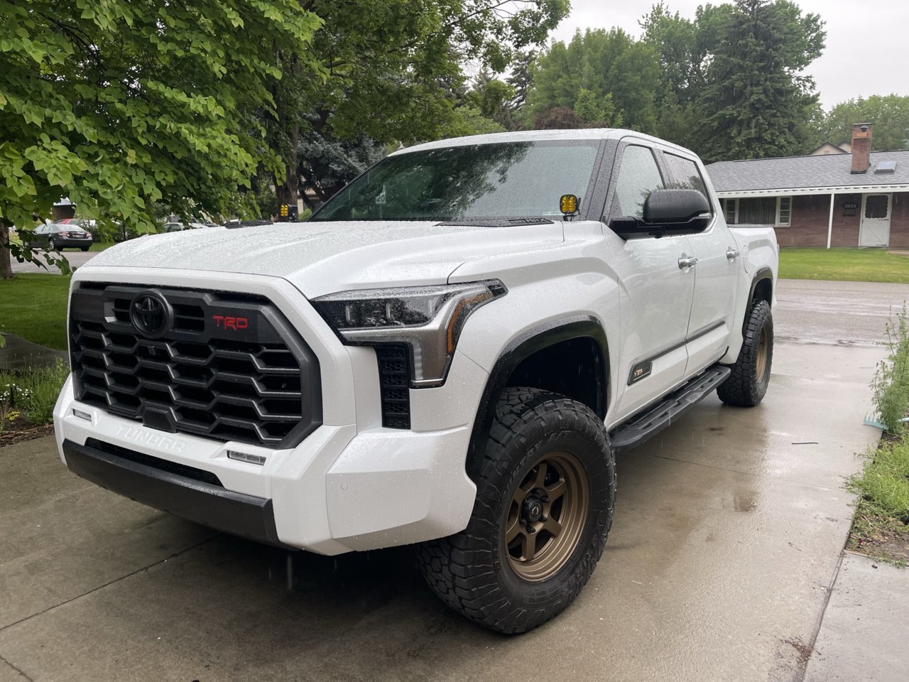

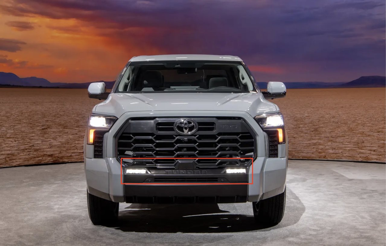

    Has anyone painted/wrapped the horizontal bumper piece below the grill? Think it would look a lot better color matched, but hoping to see some pics before I decide to do it myself. Pic for reference.

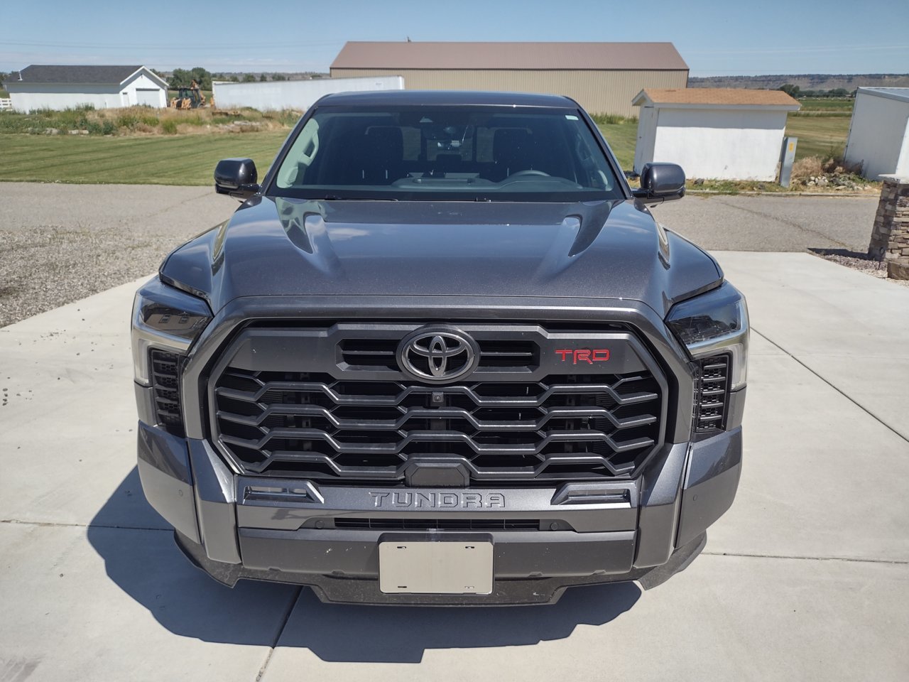

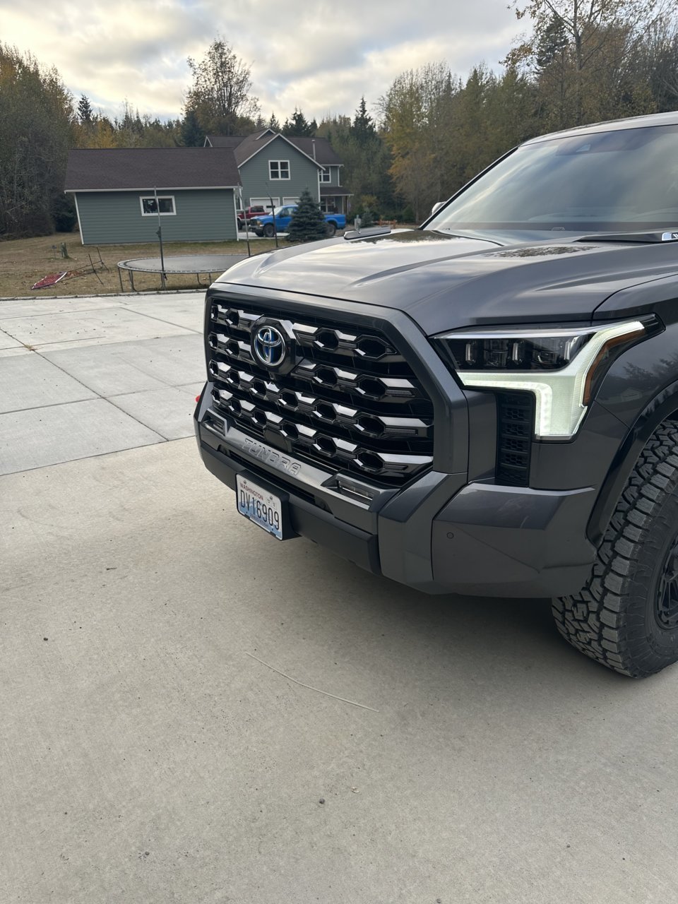

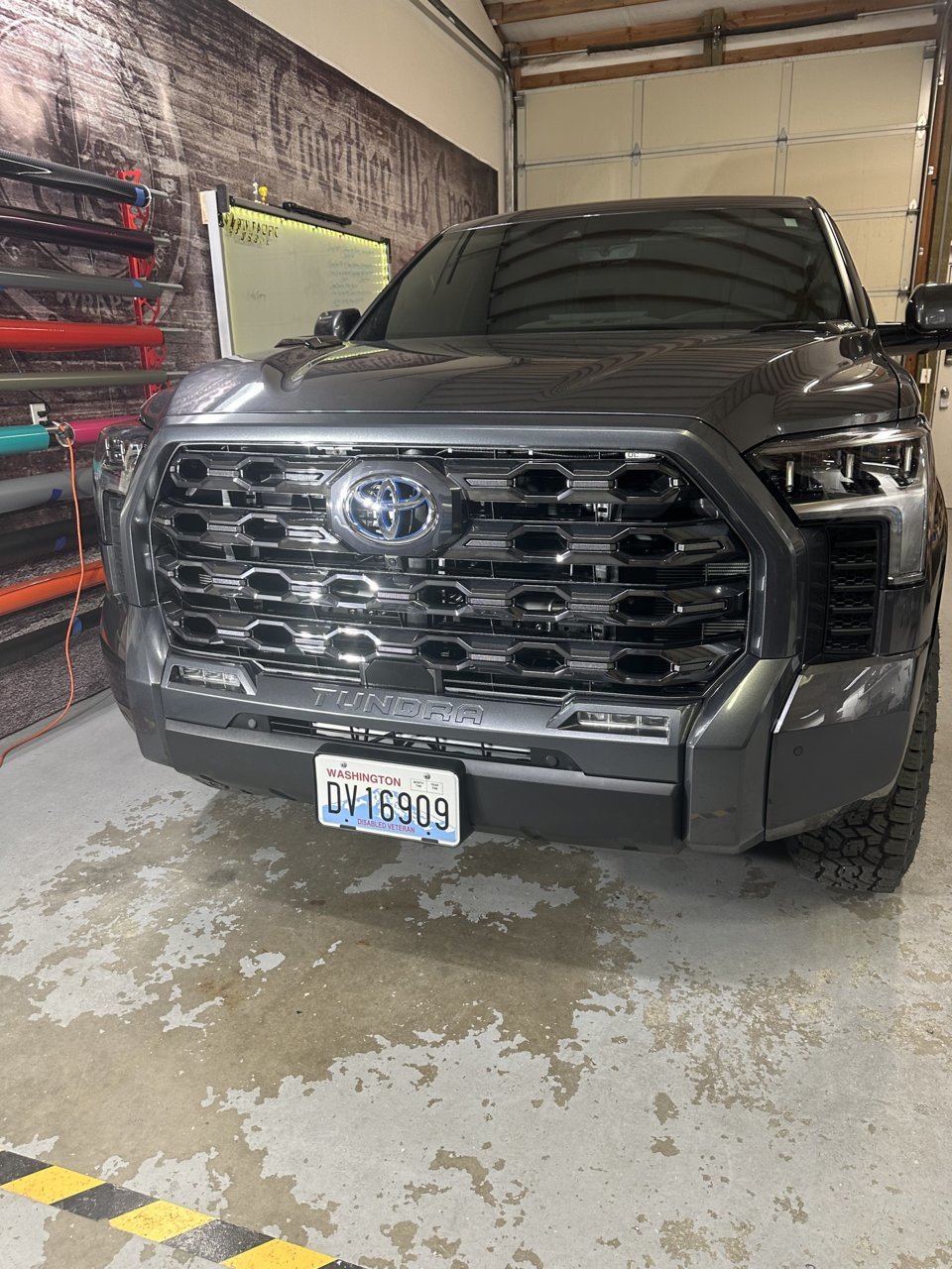

    Went from this :

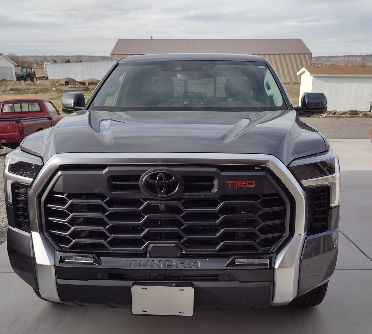

    To this (tough to see the MGM color vs black):

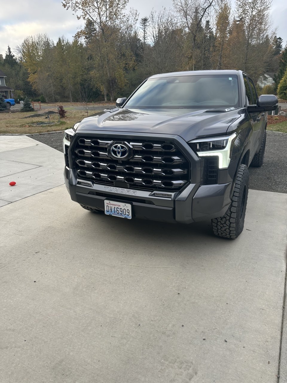

    Grille surround and upper valence wrapped using Oracle 937-970RA. 2B8073C5-633C-491B-8F32-06D8E5E82574.jpg

    Finally, someone with an mgm plat did this. Do you have any more pics?

    I can take more tomorrow. I will say the Oracle is pretty damn near a perfect match to MGM. It looks so much better in person. Debating what I’m gonna do with the Toyota and IForce Max badges. I’m thinking gloss black or MGM.

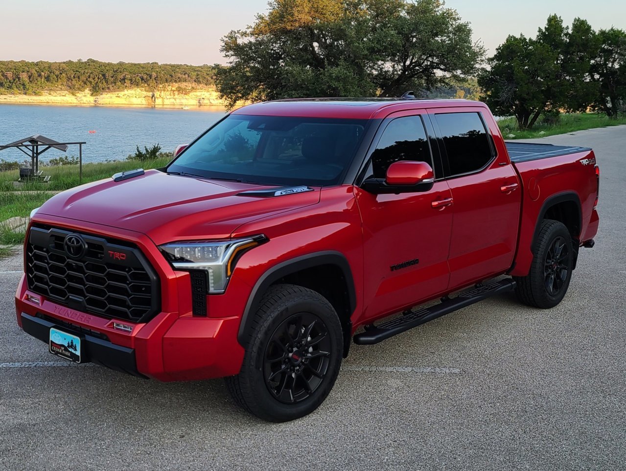

    I had mine painted that way. I took my front end apart and took the pieces to a shop to have them painted.

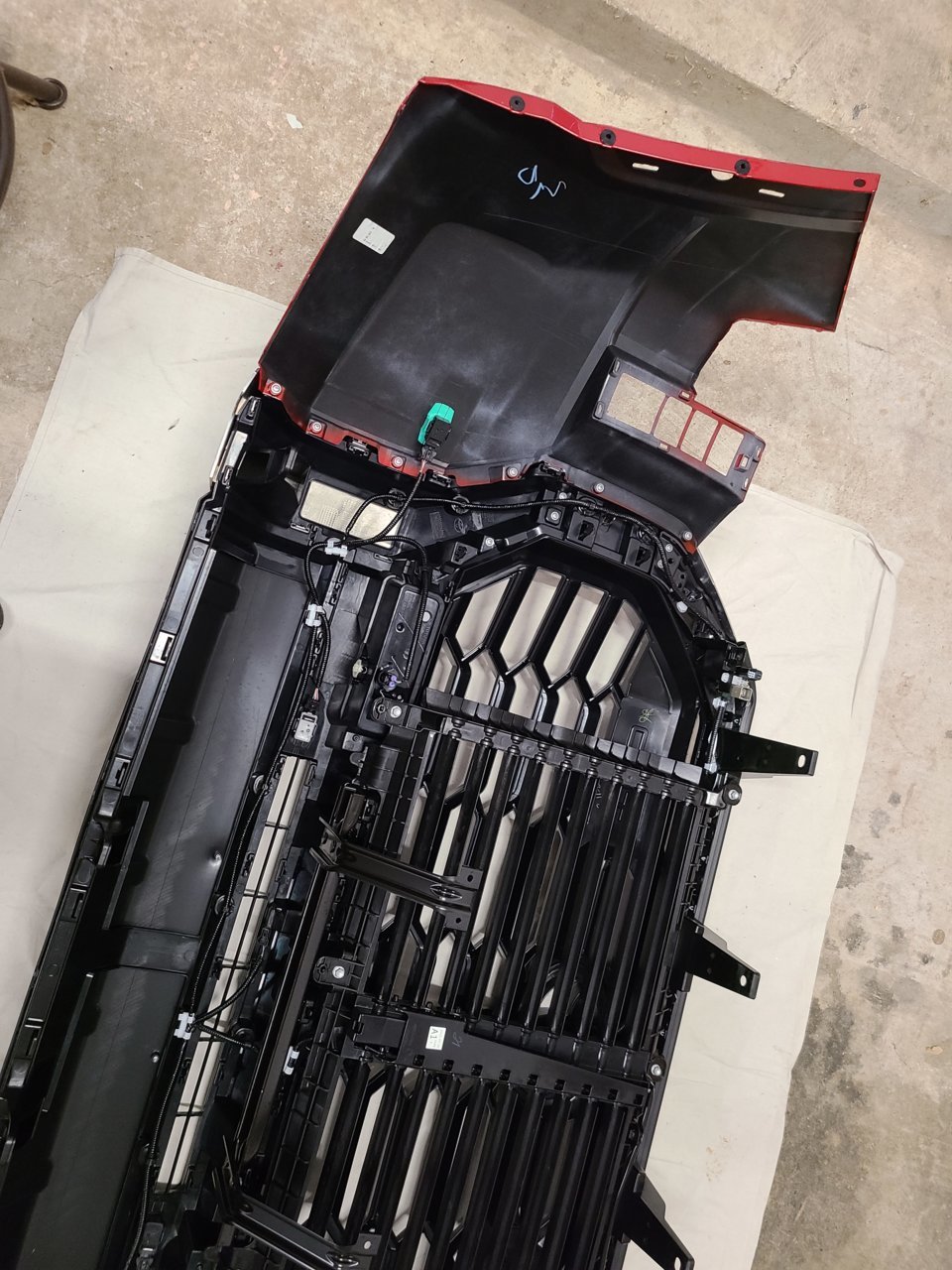

    I was nervous before I took it off (I pulled it all apart with only 62 miles on the truck), but it was a lot simpler than I imagined. If I had to replace just that "Tundra" piece, I'd probably pull the front end again. There are a couple clips on that piece that are behind/above the fog lights that you can't see from laying under the truck. I would guess that you just got lucky not breaking those.
    A tip on pulling the front end off: take off 2 of the bolts holding the top brackets to the truck and use some clamps in their place. This will keep the entire front-end from falling and you can just remove all the other bolts/screws while it stays secure.
    Also took me a while to figure out: on the front sides where it meets the fenders, only pull off the skin. There is a plastic mounting bracket that needs to stay with the truck. When you slide your front hand under there, your fingers will run under that mounting bracket and it will feel like it wants to come off with the front. Just the skin on top. You can see what I'm talking about in those pics I posted.
