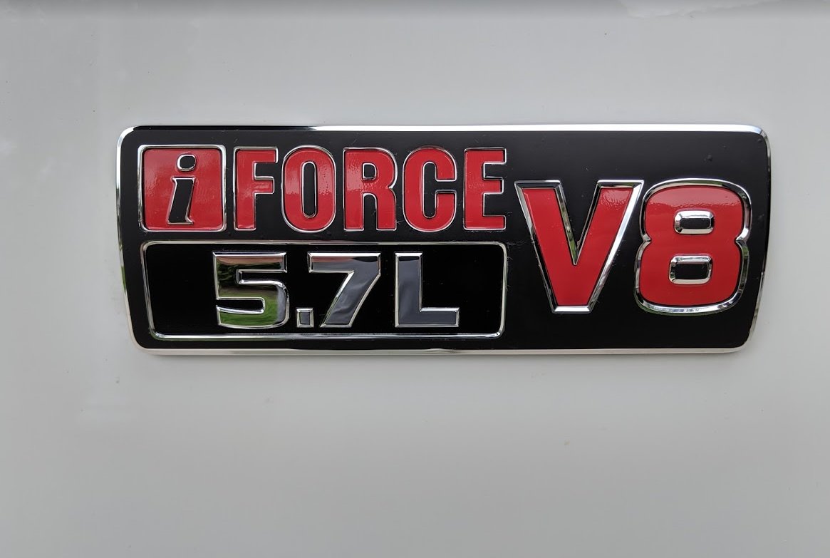

    Is there a color matched emblem available? I only found the black-out ones.

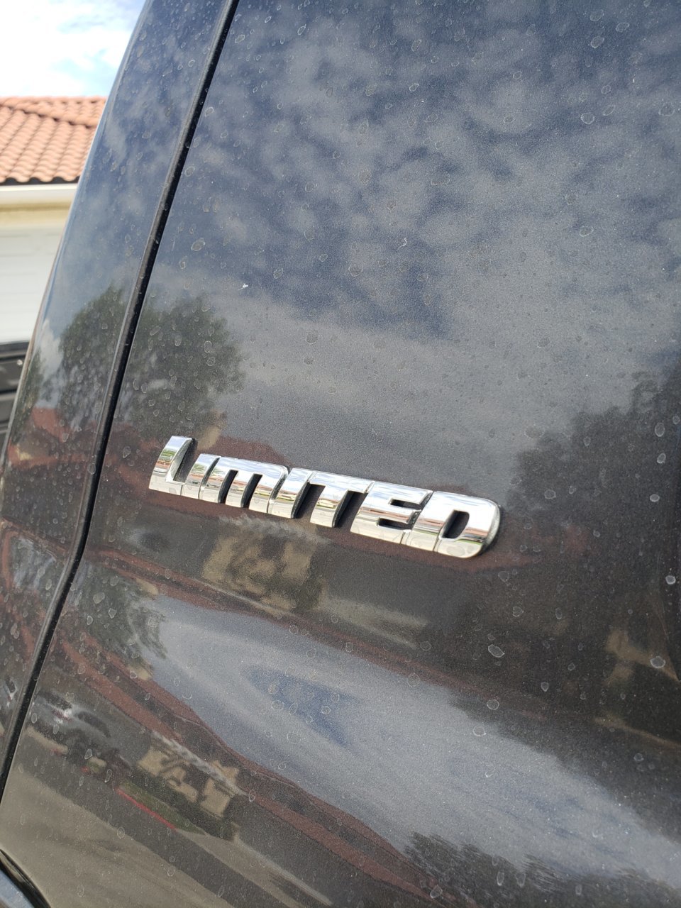

    I want the 5.7L emblem to be color matched only over the chrome. Do I have to do this myself? And, what about the "LIMITED" emblem?

    Yeah, you’re gonna have to do it yourself. The ones you have and black are the only options as far as I know.

    Damn, that's not going to be easy sanding down just the chrome on that 5.7L emblem.

    Do it!
    I did mine. You do not need to sand the chrome off.
    scuff with a scotch brite pad and dull the finish and use a plastic adhesion promoter.
    Then prime and paint away.
    Use a good clear coat
    Take your time

    Ok. I'll try that.

    What adhesive works best?

    Are you talking about the adhesive tape to re-apply the emblems? I use 3m
    Or plastic adhesion promoter. I have had great success with dupli color

    No need to sand the chrome down. Just use duplicolor adhesive primer. I works shockingly well.

    Has anyone else done the color-matched TUNDRA or LIMITED emblems? Not sure how it will look.
