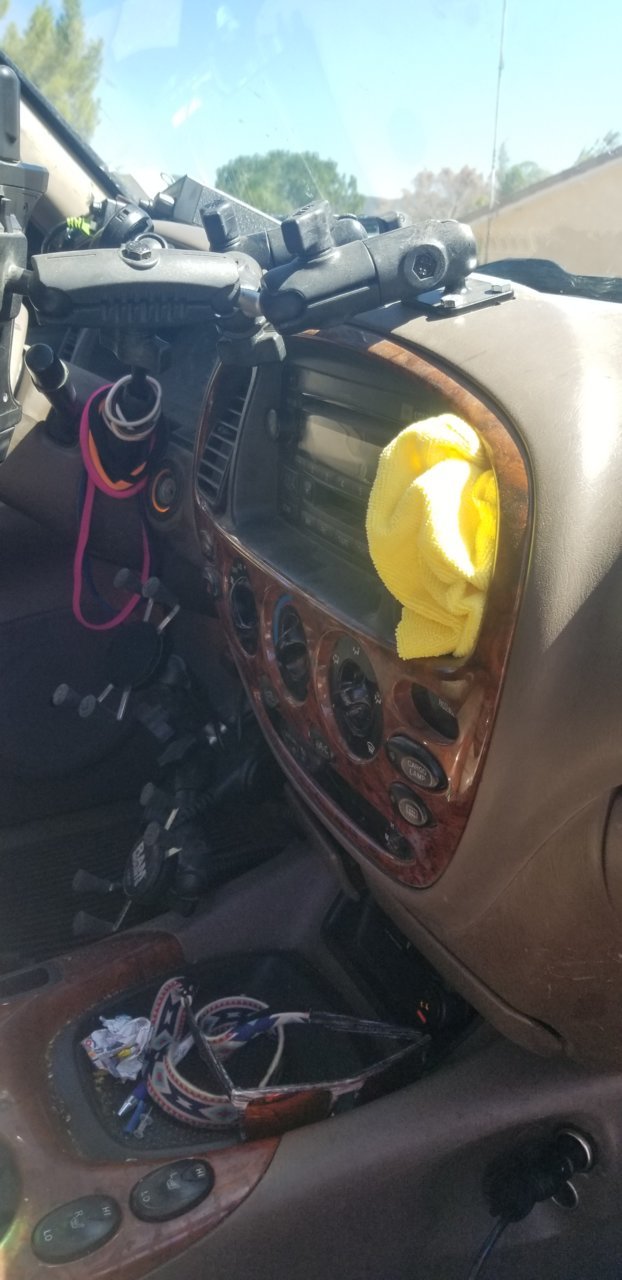

    So to add on this, awhile back I had the idea of sticking a microfiber cloth in the passenger's vent to increase flow to the driver's side. It works surprisingly well if you're driving without a passenger.
    Of course this isn't a substitute for the other suggestions mentioned in this thread.
