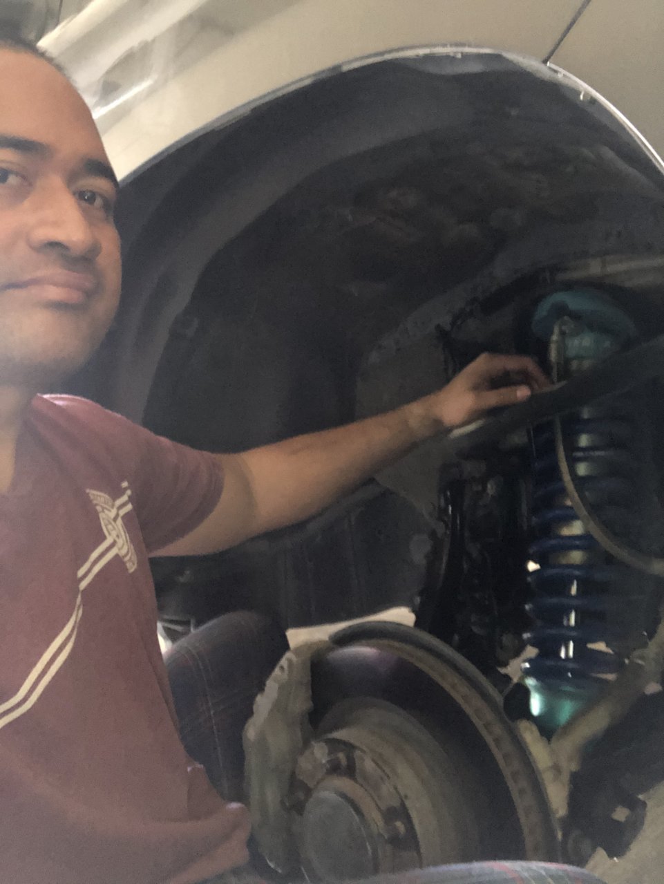

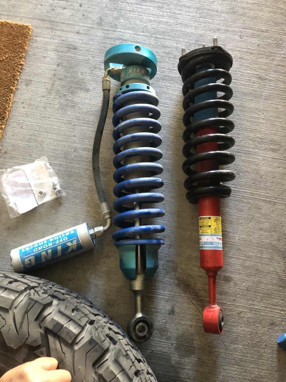

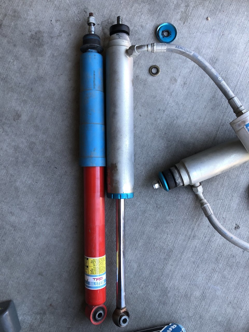

    Took off the kings to get rebuilt after 3 and a half years, only d-side rear is leaking but I’m gonna turn in all 4. Found an easier way to remove and install front shocks: take off castle nut on UCA, loosen cam bolts as much as you need to have room to get shocks in and out. Easy. Rears are even easier, don’t have a shop do it folks. I did it in my garage with basic tools, heck I don’t even have power tools haha.
