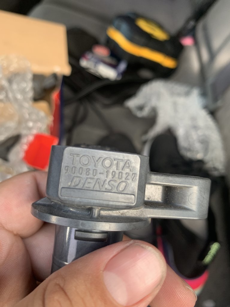

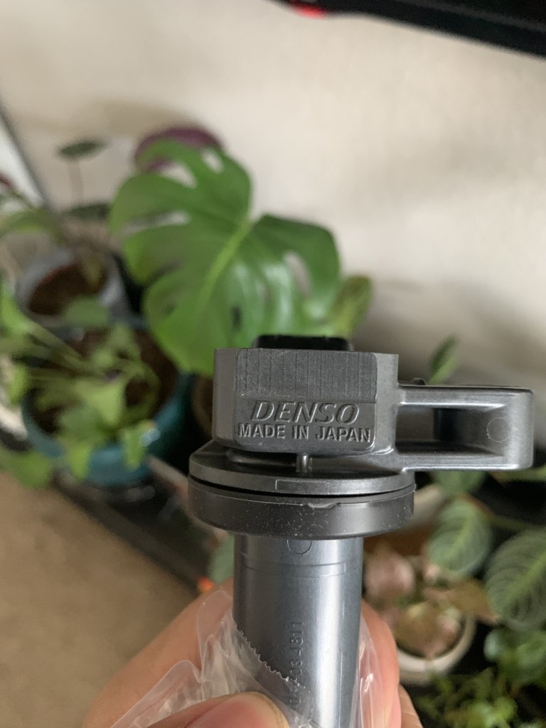

    I run Denso bought on rockauto.
    It’s the same thing to me.
    even looks like the Toyota logo was shaved off.
    below photo is the OEM coil
    Buy the Denso 673-1303
    from rockauto I have about 45k miles on them

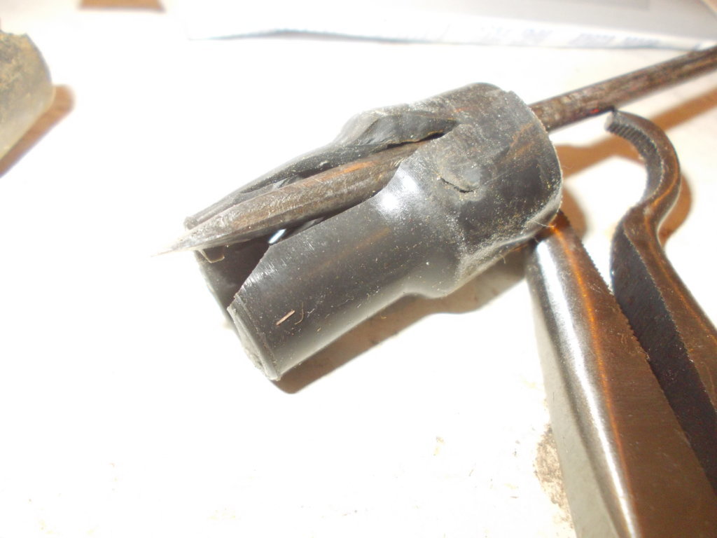

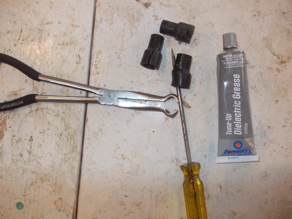

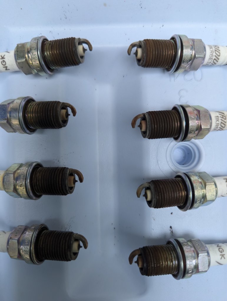

    Removing the stuck boots was not easy. I bought a set of Harbor Freight long needle nose hose remover pliers (see pic) and they did NOT help. I ended up grinding a long screwdriver to a chisel point and gouging the area that grips the plug, then spraying lots of silicone spray in there so it would release and slide up the tube. Then blew out with air. I bought a new set of Denso boot kits.
    Considering I am using some cracked coils, I think replacing the Denso grommet washers (included in the kits) on the coils frequently is a good idea to keep them dry.

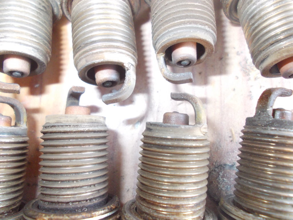

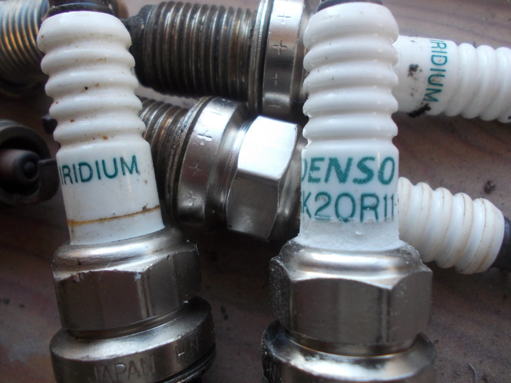

    After 66K miles, the existing Denso SK20R11 iridium plugs were completely shot and wide gapped but ran fine. I installed Denso IK40-5304 iridium plugs at .043" gap and put dielectric grease on the boots where they grip the plugs.

    I guarantee those are not iridium plugs. In my experience, true iridium plugs will look brand new at 120K miles. Did you buy them on Scamazon or Ebay?
    KNABORES and Dook55[QUOTED][OP] like this.
  11. Sep 5, 2024 at 5:12 AM
    Dook55
    Dook55 [OP] RCLB Guy
    Sep 15, 2019
    #36150
    338
    Montana
    2004 4x4 V8 RCLB 2006 4x4 V8 RCLB
    You may be right. I bought them from NAPA.
    The new ones I bought from Denso direct off their website. I think I'll have to buy all my plugs that way from now on.
  12. Sep 5, 2024 at 5:31 AM
    shifty`
    shifty` We call it “riding the gravy train”
    Jun 20, 2020
    #48239
    29,979
    ATL
    '06 AC Limited V8/4WD
    I agree, the tip shouldn’t be that far gone, although they are notorious (per internet enthusiasts) for the tip blowing out before NGK. believe Denso has a 80k lifespan on that plug. The NGK are 100k I think, specs are similar, tiny difference in diameter (like 0.1mm?) on the iridium tip. I went with the Denso.
  13. Sep 5, 2024 at 5:38 AM
    tvpierce
    tvpierce Formerly New Member
    May 6, 2019
    #30129
    1,472
    Maine
    2000 Tundra AC SR5 4WD, 4.7 Automatic
    I stand corrected. I just looked at Denso's web site, and it appears they offer at least 3 variants of iridium plugs -- each with a longer change interval: Iridium Power, Iridium TT, and Iridium Long Life.
    The Denso iridium plugs I've used in past Toyota cars have I guess been either TT or Long Life. When I replaced them at 120K miles, the electrodes still looked brand new. I did get counterfeit iridium plugs once from ScAmazon -- obviously I didn't know they were counterfeit at the time. But after 40K miles they started misfiring. When I took them out, they looked like yours.
    Dook55[QUOTED][OP] likes this.
  14. Sep 5, 2024 at 6:01 AM
    Dook55
    Sep 15, 2019
    #36150
    338
    Montana
    Those Denso SK20R11 I removed are shown as long life on the Denso website, so your first guess may be correct.
    https://www.densoproducts.com/denso-3297-sk20r11-iridium-long-life-spark-plug

    If those are supposed to be Denso Long Life plugs that should last 100K miles, I'd bring them back to NAPA and ask what's up with their supplier.
    This is what they should look like after 100K+ miles.
