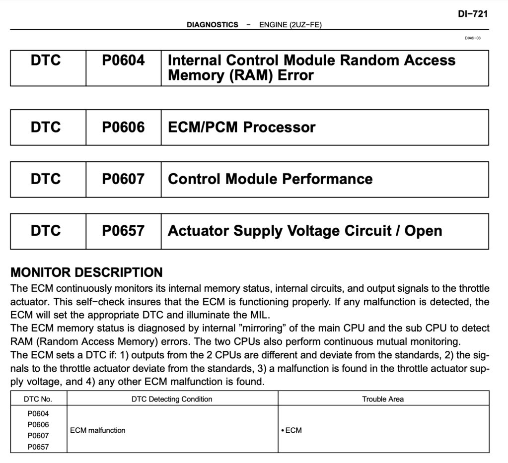

    p0605 doesn't seem to be the code you're saying it is. Can you doublecheck that's not a typo?
    I looked in Toyota's factory service manual, and all P060x codes are ECM related, computer issues, but they jump from p0604 to p0606, p0607, jumping right over p0605.

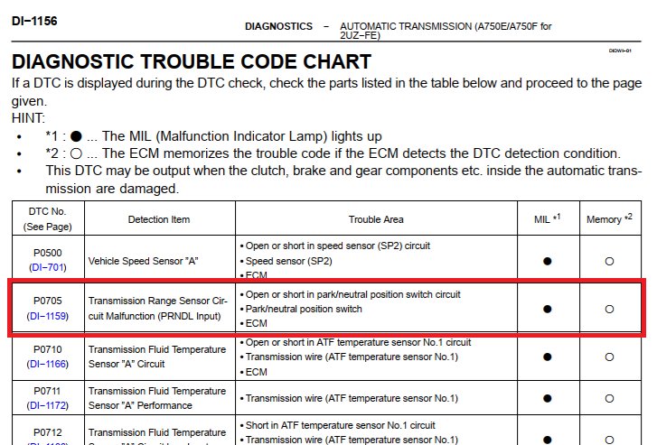

    Note it's P0705 (That 2nd digit is a zero, not the letter O) code indicates is the park/neutral safety switch or park/neutral sensor or "PNP".
    It's external to the transmission housing. This switch basically what tells the truck's computer what gear you're currently shifted into.
    It may not be bad, it may not need replacement. This code could indicate it's unplugged, the harness may be wrecked or have gunk in it, or it may be clocked incorrectly. Per Toyota's FSM, which anyone can download, there are only three causes for the code:
    Putting those in plain English:
    • "Open or short" - A wire got hacked, harness is unplugged, or connection is bad (corroded plug, melted plug)
    • Park/nuetral position switch is not installed, installed poorly, or not adjusted correctly
    • ECM - your on-board computer is bad, which is extremely unlikely

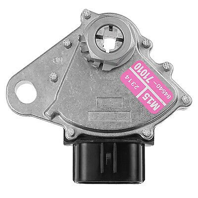

    The switch itself looks roughly like this, fan-shaped.

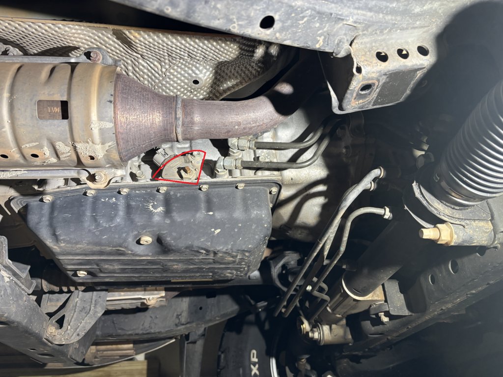

    Here's where it's located, on the '05/'06 V8's transmission, on the passenger side. Look toward the transmission while laying under the passenger front door - notice the grey wiring connector at the 10 o'clock position:
