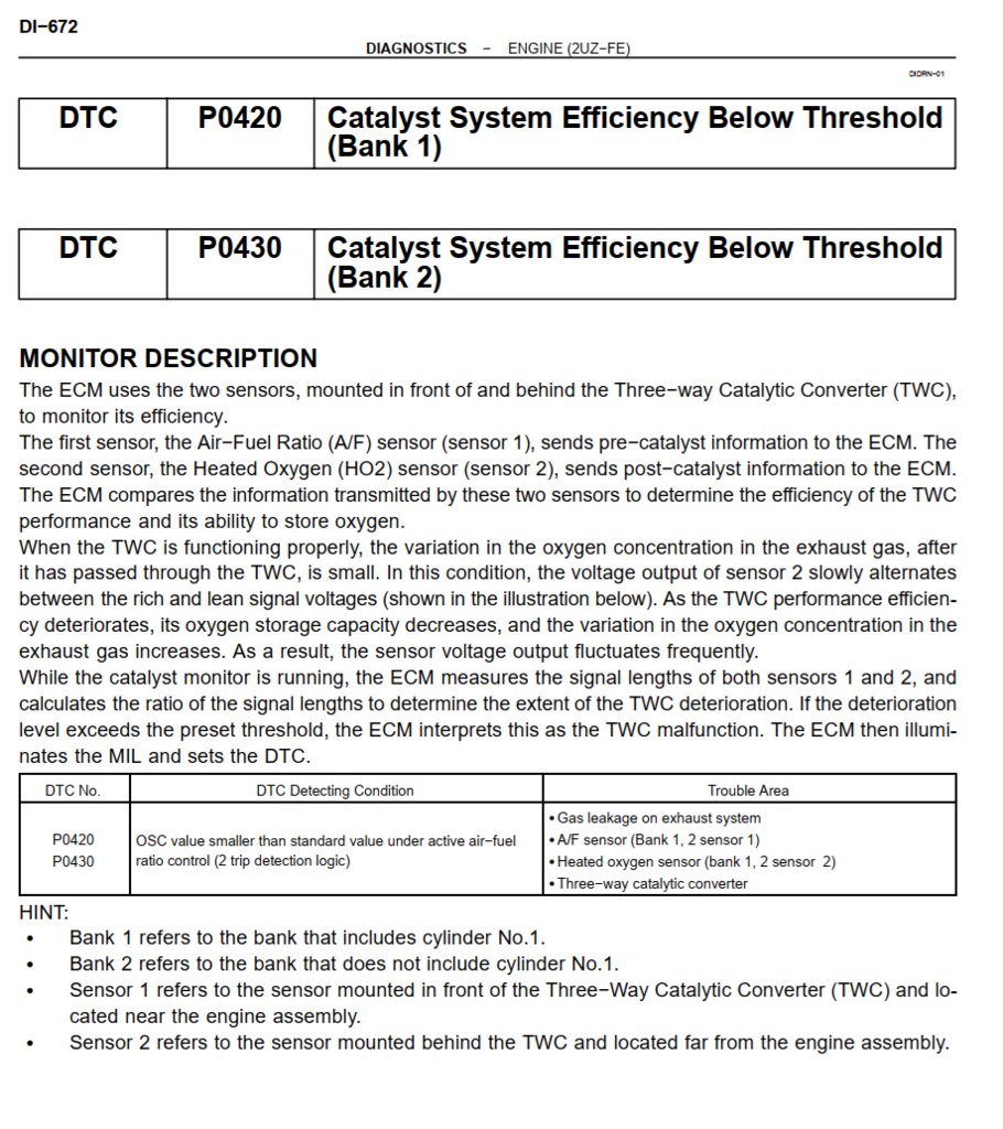

    Oh, and also from the FSM. Note the table "Trouble Area". There's really only 4 things that can go wrong here. Leak, bad/underperforming O2 sensor, bad/underperforming cat.
