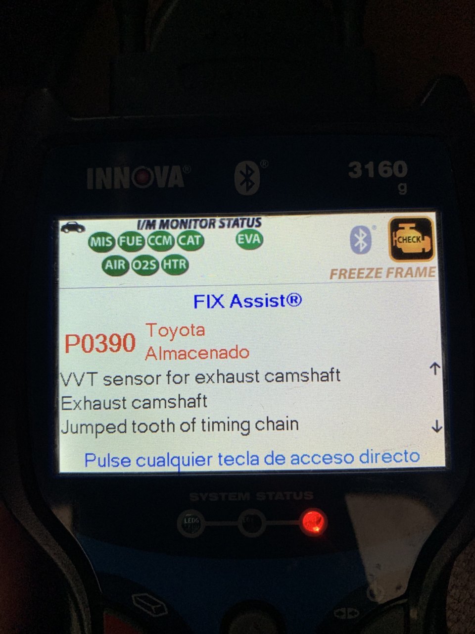

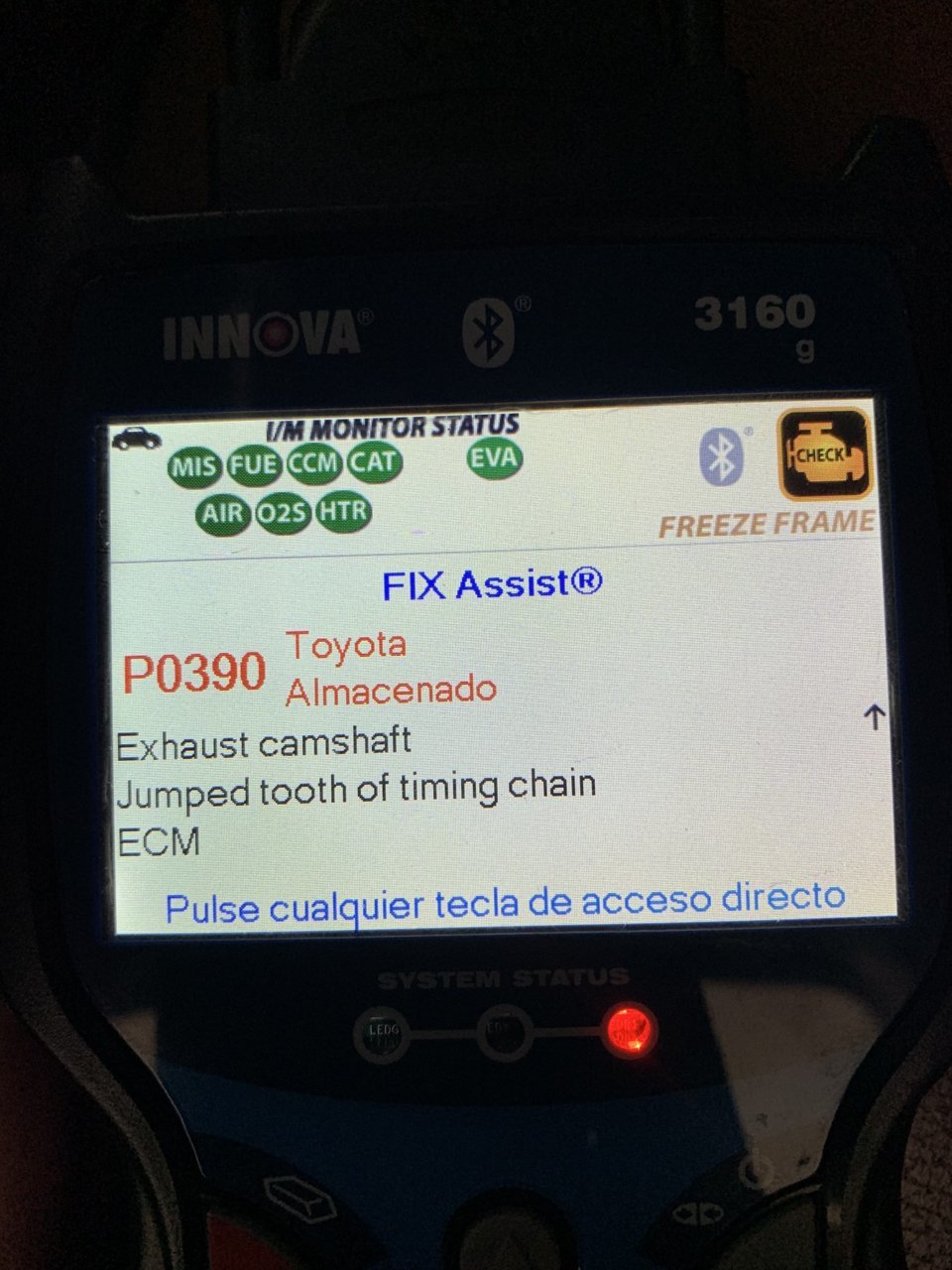

    Hi everyone I’ve got a 2007 tundra with 163k miles
    Today my check engine light came on and I’ve got this code. Can’t find much about it anywhere but from reading on here it says camshaft sensor.
    It does mention timing belt tooth jump but from my understanding the 2007 5.7 has a timing chain? Any help would be great

    Edit: what I’m looking for is the location based on the reading I’ll tackle the sensor first by cleaning it/changing it if necessary

    The position is a 3pin front/top of the valve cover. Position will look like a traditional sensor. 1 to 2 I think provides 5v.
    Actuator is a 2 pin, dont recall location offhand but likely top front as well. The actuator is sits/stands off maybe 2 to 3 in. 1 to 2 should be 12v.
    In going off memory, dont have the truck to look at.
