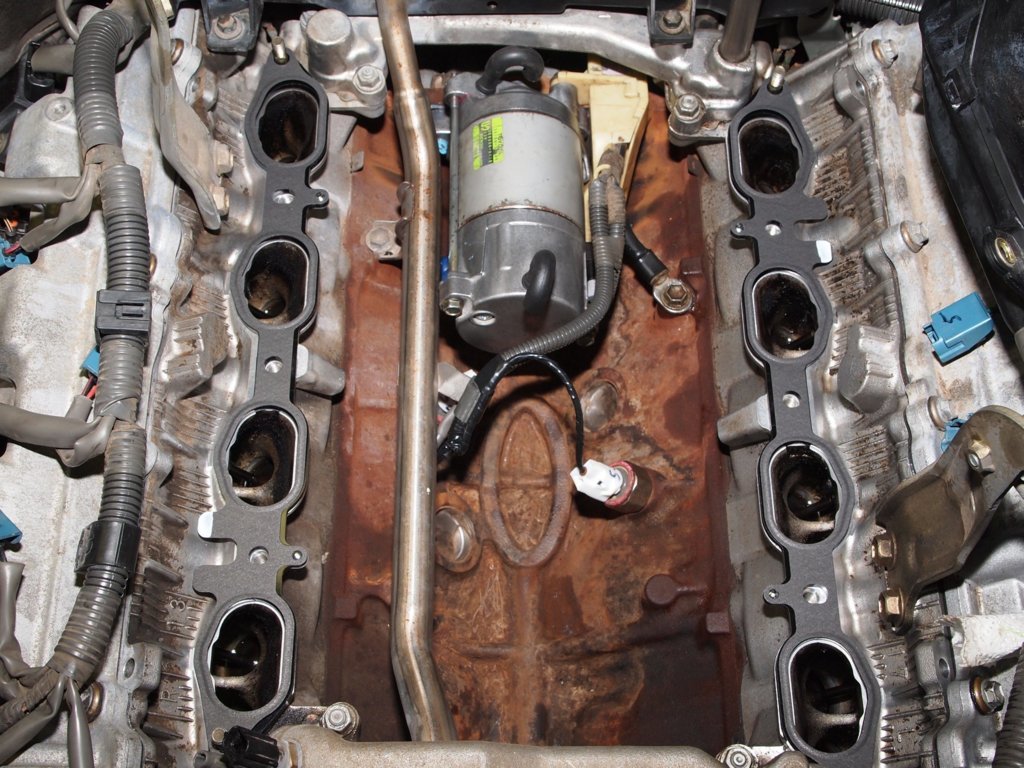

    Sad to be the one to tell you this, but unless you have an electrical issue, it's totally possible your intake gasket is breached at cylinder 3 and is letting more air into the cylinder than the ECU is expecting, and you're misfiring.
    When that happens, you need to replace both gaskets at the same time, DO NOT USE AFTERMARKET PARTS, this is what it looks like when you blow off one cylinder. If it doesn't jump to the right place, its 5-6 posts down on that page.
    @bmf4069 used aftermarket gaskets on his. Twice. Both blew out again within a year, as you see. Then he installed OEM. To date, those haven't blown. Seriously. You don't want to be up under that intake manifold again in the near future.
    There's a way to tell how to orient the OEM gaskets, based on tabs, but I don't have the non-VVTi V8 in my truck so I've never done it before. Plenty of others have, and have posted pics. Best to get it right the first time.

    White tabs up and out
