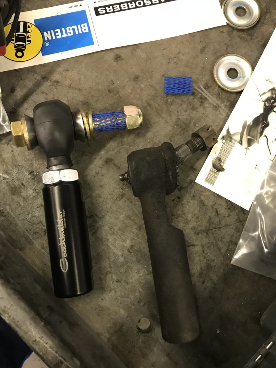

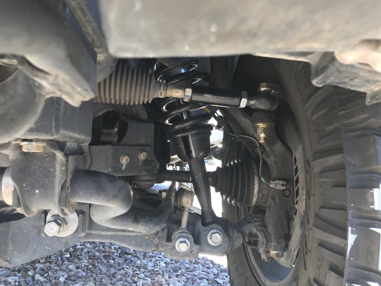

    I just installed the CB steering kit on my "15 CM 4x4. They made a huge difference, Anyone use these? If so, how do you grease them? Or do you? I see they have a grease boot.

    i use spray silicone type stuff on the top of the pivot point.

    Thats kinda the route I was gonna use

    Triflow, only when they're noisy

    And, it's not really a grease boot, it's a dust boot. You can check with Total Chaos on what's the appropriate grease/lube for heim joints. Heims are typically self lubricating.

    They recommend Super Lube. I put it in a large syringe and squeeze it around under the boot.

    I swear it made the steering easier, but the big difference is the turning radius, I have 35 inch tires with a 6 inch lift. Before I had to back up, pull forward, back up just to turn around. Now it turns like factory. Also had the skreaching sound on pavement when turning, no longer have that. I drove this truck lifted without these for about 3 years, sure wished I would have changed them 3 years ago.

    Who is they? Ekstrom?
