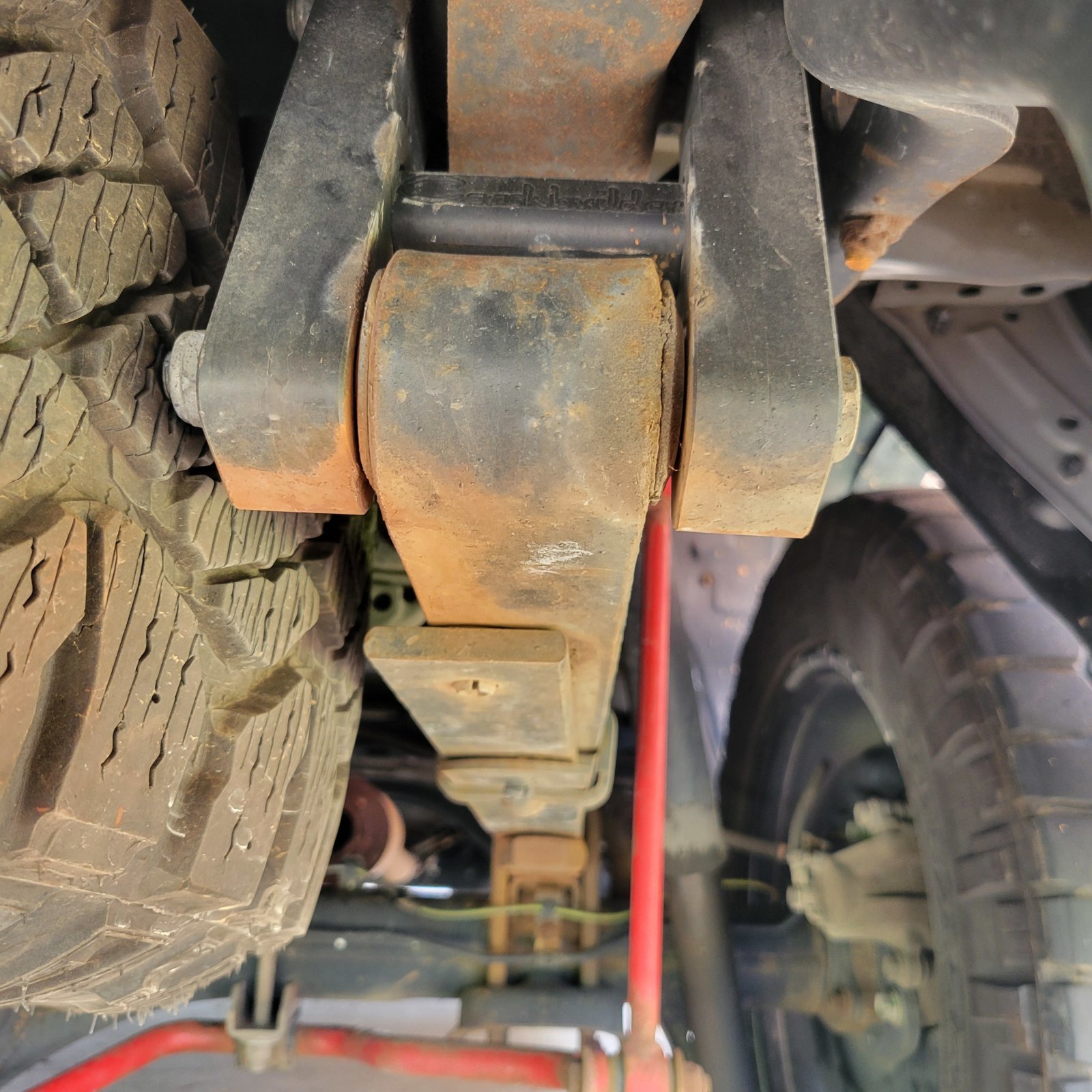

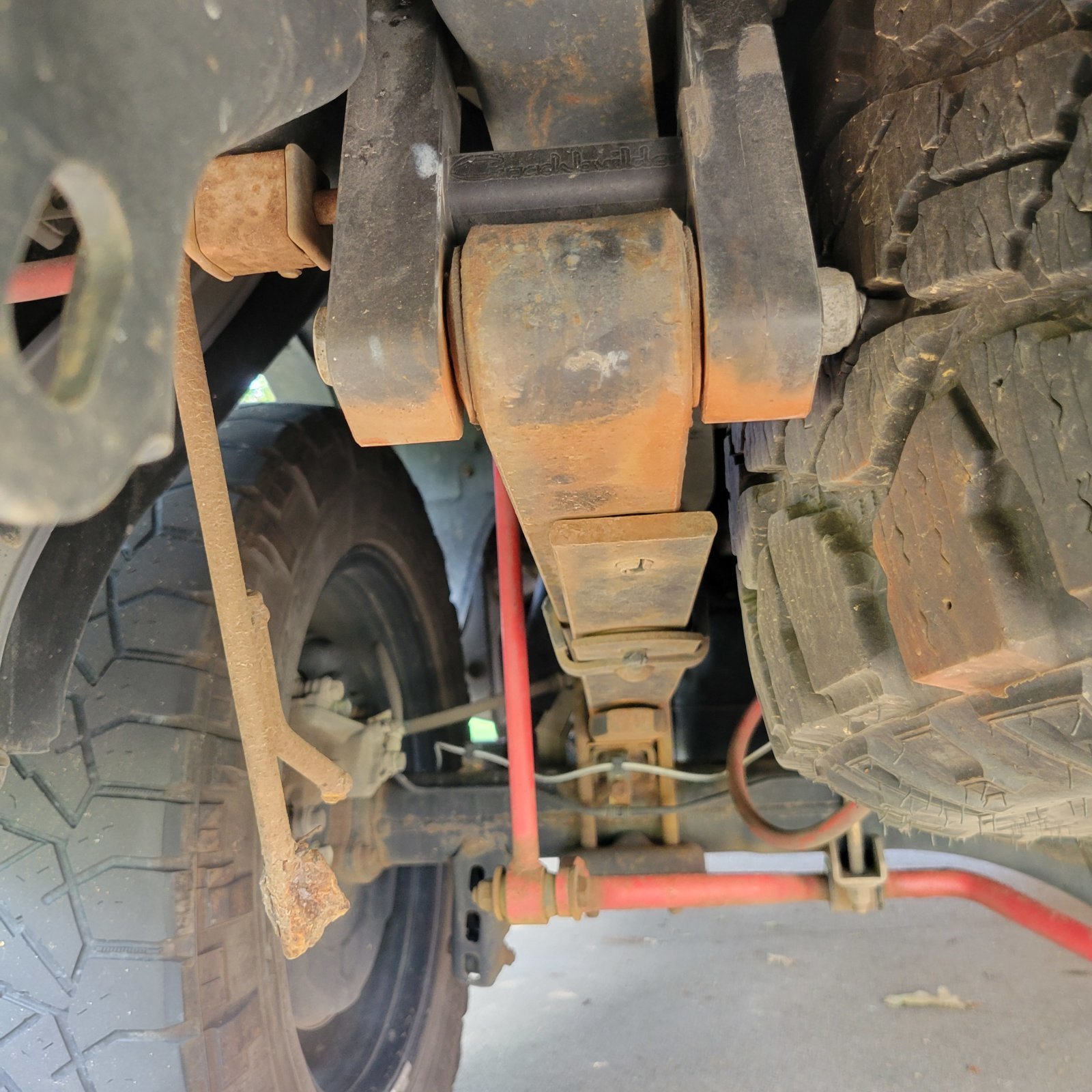

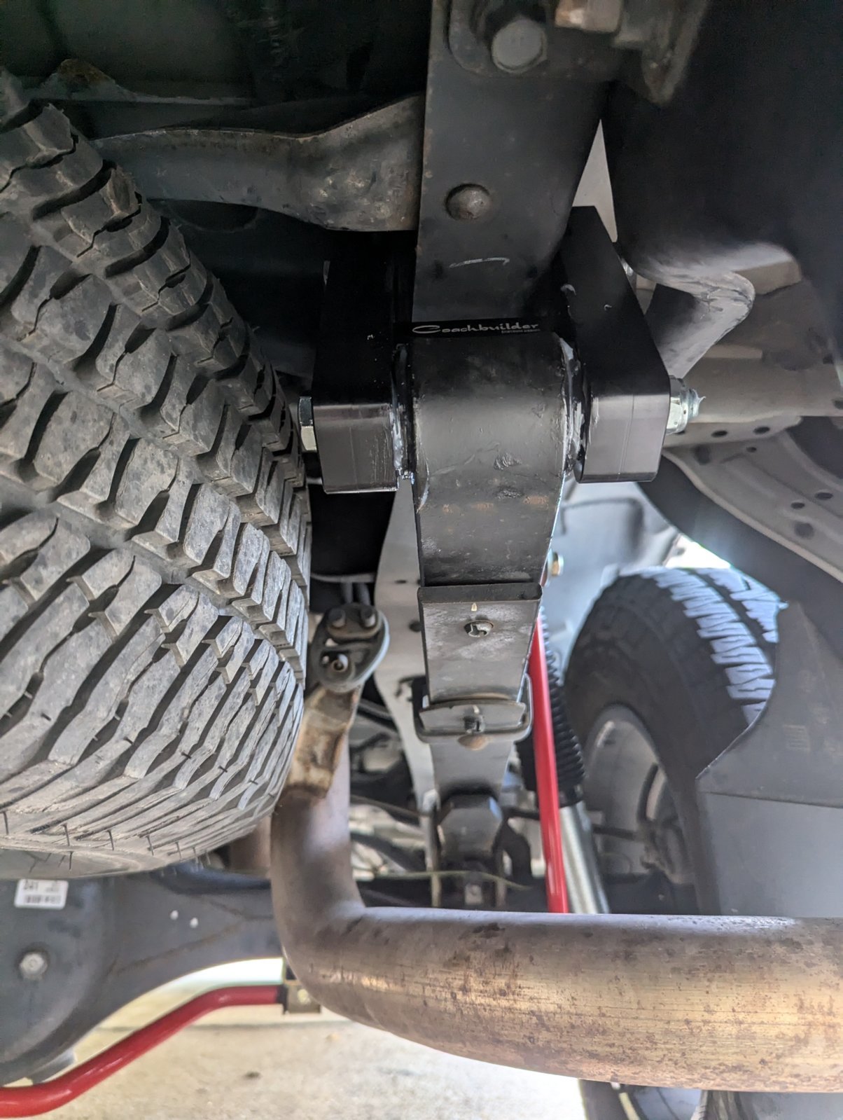

    I have a 2016 SR5. I installed some 3" Coachbuilders a few years back. I had an alignment done and the tech observed my leaf springs on each side were twisted inwards and both sides are pushed against the spare tire.
    I have not started my long drawn-out email exchanges with them yet. I was hoping this might be an easy fix. Does anyone have any knowledge or input on this?

    Probably because your spare is large and there's no place for the shackles to articulate to in that direction. What size is spare?

    seems like just getting the bolts flipped around to where heads of the bolts are towards the tires should give the minimal amount of clearance so they don't rub on the tire

    It's 34", why would they be articulating while parked?

    I'm not worried they are touching. I'm concerned they are twisting and not aligned.

    Think about physics and a solid rear axle for a minute. One side goes up on a curb and the other must come down. If the wheel traveling down can't because the shackle can't move forward, the axle will pull toward the side that is traveling up which results in horizontal force to the size traveling up. Stack 4 strips of something together and pull the bottom one sideways and see what happens.

    The issue is with the interaction of the bolt end and the tire. The bolts need to be flipped so that there is no tire contact. What is likely happening is that as the shackle articulates it is binding against the rubber and holding up the primary leaf. The rest of the leaf pack is relaxing during the suspension cycle, and since the shackle is being held up the rest of the pack is able to "float" and individual leafs can twist.
    Flip the shackle bolts around so that there's no more contact with the tires, hammer the leaf pack back into line, and Bob's your uncle :thumbsup:. Your truck is fortunately not broken, but just needs a touch of attention!

    When you articulated the suspension with the spare blocking travel they twisted accordingly. I quit running a spare underneath once I moved past 33s.

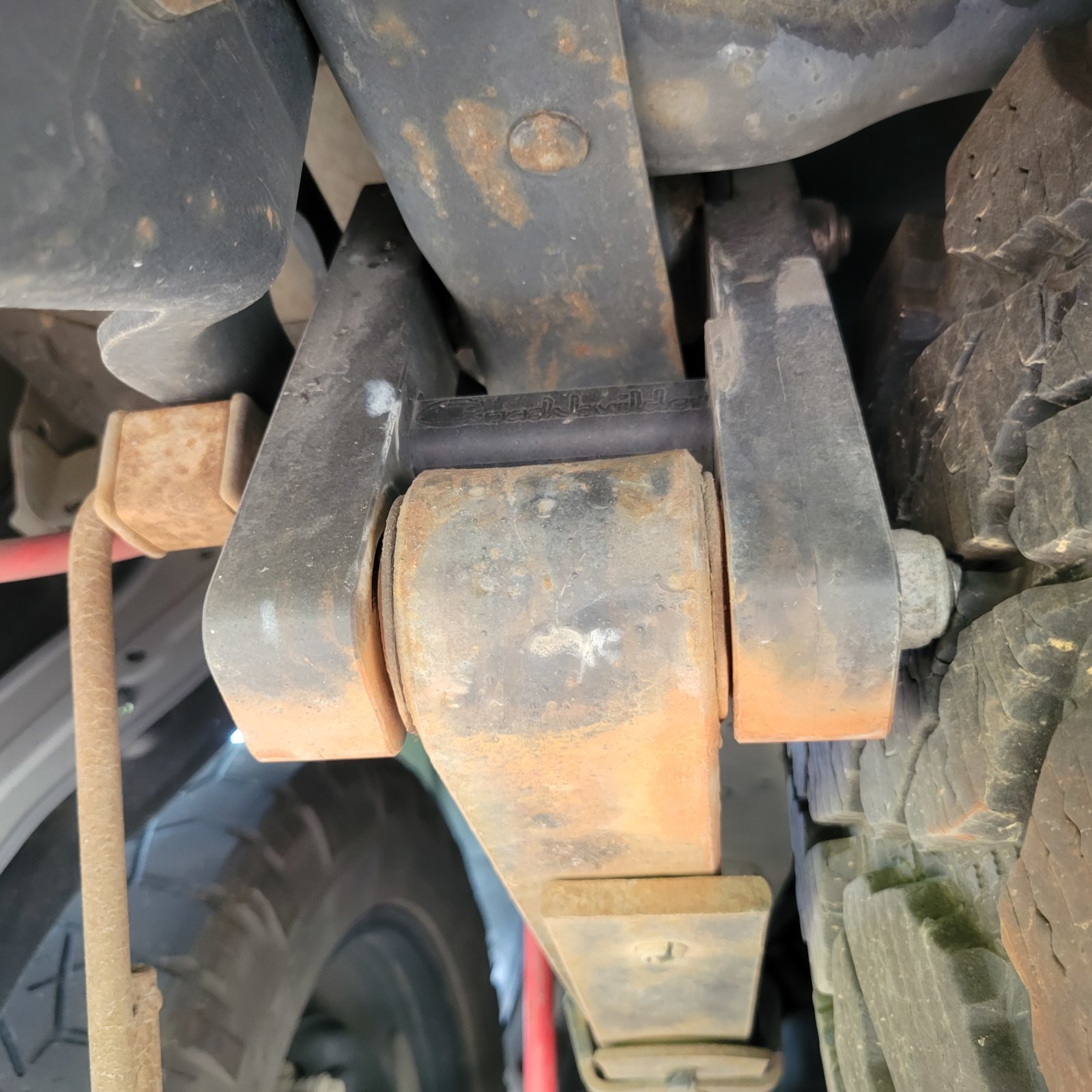

    Another example of these springs twisting -

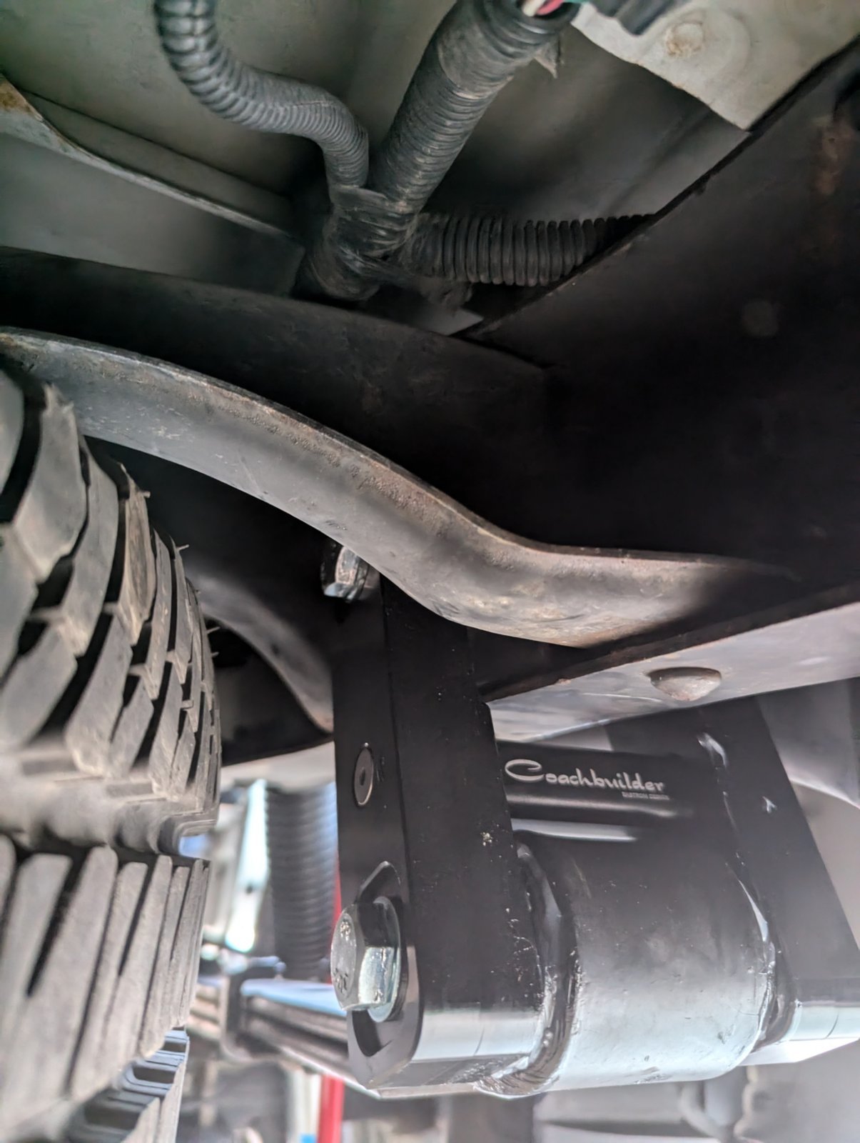

    I agree with @memario1214 , i just installed the CB shackles this week and notices that they were touching my spare when the nut is installed toward the spare tire. Also, i got the shackles with one washer missing from Coachbuilder so i had to reuse the old one from the factory shackles. Also had to look at whole bunch of pics on line to find out if the "coachbuilder" lettering should be on the inside or the outside and figures out that there is going to be a right and left.

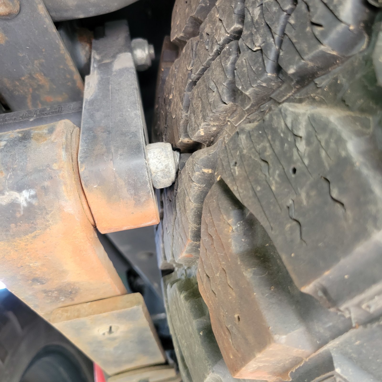

    I would reverse the installation of that bolt rubbing against the spare tire. Bolt head close to the spare tire, bolt nut away from the spare tire. There is a sweet spot where the shackle bolt will slide on and off easily. No need to remove the rear tires. Just remove the spare tire, jack the frame of the truck and watch the suspension relaxed. There'll be a point where the pressure on the shackle will be light and the bolt will slide out easily. As it is coming out, stick a screwdriver on that hole where the bolt is leaving so in case it gets misaligned, it will be easy to line it back up using the screwdriver. Actually, 2 screwdrivers. The other one you put on the other side of the hole once the bolt completely comes out. Then, remove the other one, as that's the end where the bolt will come in.
    I've used the +3 Coachbuilder shackles in the past on my RCSB. If you can't jack the frame high enough, then, remove the rear tire one side at a time. Leave the other side on. That way not much movement. Hope this helps.

    Hmm, I put one of my old 295/70-18 Ridge Grapplers on my stock spare rim and mounted in the stock location. It fits, but the Coachbuilder shackle bolts are touching or nearly touching like the OP's. Now I'm thinking after reading this maybe I should remove that wheel? It's really my second spare, I carry a full size in the bed.
