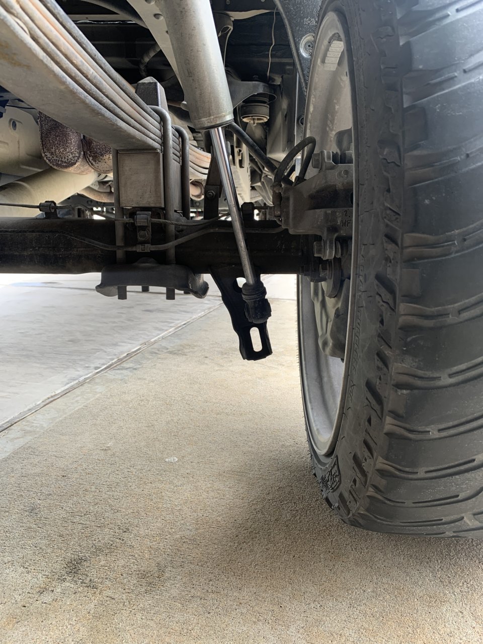

    So i just finished but guess what now my shocks dont reach the bottom mount anymore and i have the fox shocks for 4-7” rear lift what gives

    Getting ready to head out, but they dont reach, even with the truck on the ground with nothing lifting or supporting it?

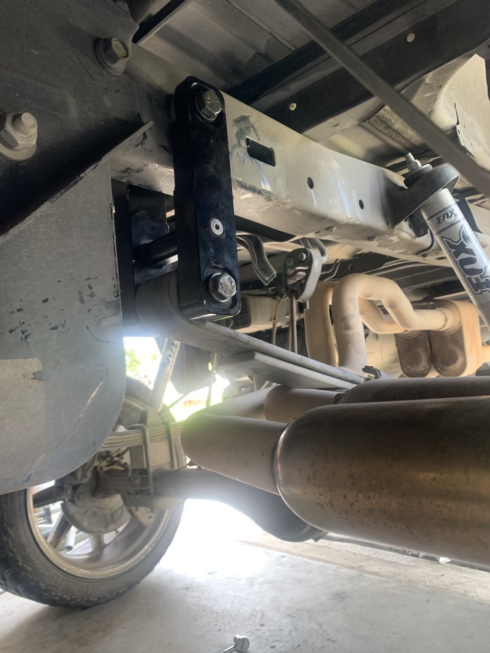

    Try placing the jack under the pumpkin/diff and lifting, the leafs will flex some and hopefully allow you to remount it. The shackles shouldnt lift it that much to make that big of a difference as that looks closer to 3". Could also see if the shock is maxed or not by trying to pull down on the lower mount/eyelet.

    Looks like you will need new shocks to run a +3 shackle on a 6in lift.
    6+3=9 in lift. You may not be at the full 9in of lift but your shocks are at full extension and look about 2in short.

    +3 Shackle is a 1.75" lift

    Did you torque the shackle bolts up in the air? That’s supposed to be done on the ground, so that could bind them and make it look like you have more lift than you should. But you’re also running 7.75” of lift if you have a 6” kit with +3 shackles (1.75” lift). You probably maxed out the shocks.

    The rear shocks are still charged with nitrogen and go to full extension unconstrained.
    They still look too short

    The do look a little straight up and down, mine have a slight angle to them. If you search for images of them you will see a lot of them angle toward the back of the truck.

    Have you loosened the shackle bolts yet to see if you get some articulation back there? It does look like they’re much more up and down than shackles should be.

    Probably need both to be loose, just hand tight. Then once you get the shocks attached, torque them to spec on the ground
