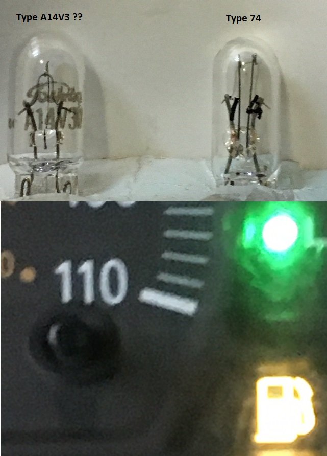

    Along with @Aerindel comment about not replacing "battery warning light with LED's", I'll also suggest not changing the Low Fuel to LED, at least that is the choice I made due to the comment from a poster at the TS forum. While I was hesitant to agree until looking further, I became convinced, unless found out otherwise. The Low Fuel socket is different in color(grey vs black as seen in below pic), the bulb is physically different from a Type 74 and when I did test by plugging the LED in properly polarity wise, it indeed came on with IGN ON. The best I can tell with a magnifying glass is the bulb is Toshiba A14V3 and indeed there is a Toshiba A14V3.4WL

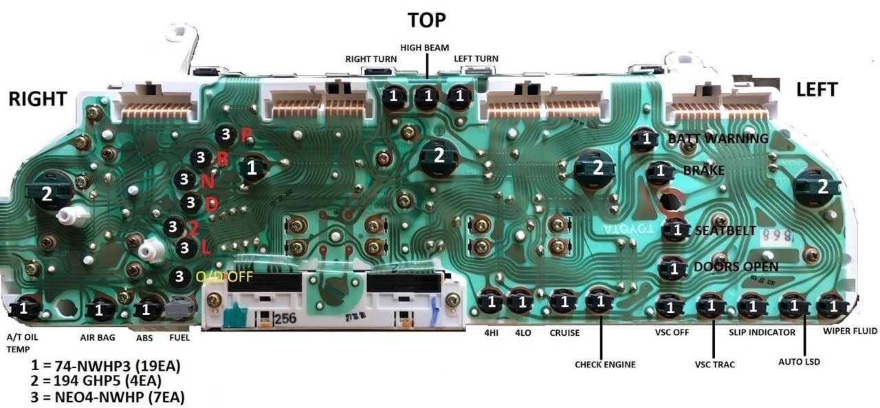

    Below is the back of mine with pertinent info I came up with for me when I was changing to LED just to give you an idea.
