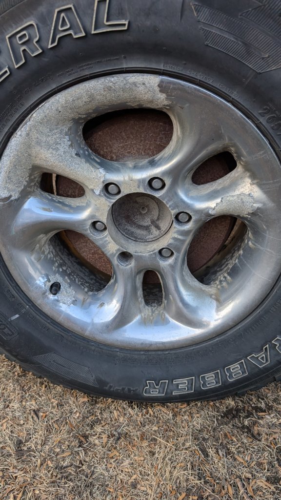

    Here's the old boy in the flesh. Plus the wheel mentioned previously.

    28,438
    ATL
    '06 AC Limited V8/4WD
    That look almost like the Ultra wheels that were popular back in the 80s/90s but it also looks like what came on older T4R?

    Raye
    Boonville, Missouri/Colorado Springs, Colorado
    2001 Tundra SRD AC 4.7L V8
    I'd believe it if they were that old. I can't find any real identifying data on them thanks to the weathering.

    28,438
    ATL
    American Racing AR-136 circa 1996, it would appear to me.

    11
    Raye
    Minus the centerpieces, that looks right. Definitely time to replace them in that case. Even without the cracked one.

    #48239
    28,438
    ATL
    May've also been the AR-33 (top right in that pic) which came in 16x7 and 17x8. But like, with the AR-136 and AR-33, it's misleading (1) because of the center cap, and (2) the length/shape of the spokes varies based on diameter, and (3) how flat the center is also varies based on bolt pattern.
    One good example of this with the AR-136 specifically, check out this 15" with 5-lug and how wildly different it looks from the pictures up there: https://www.ebay.com/p/1923040301
    It still reminds me of a wheel that Ultra, Prime, US Wheel or maybe even Progressive (although I feel like PW was mostly more angular wheels) would've made back in the late 80s/90s
