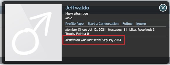

    #24
    shifty`
    shifty` Just like witches at black masses
    Jun 20, 2020
    #48239
    28,342
    ATL
    '06 AC Limited V8/4WD
    Clicked on his username and he hasn't been here since fall of 2023...
