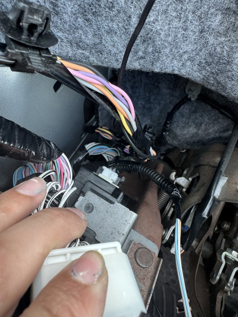

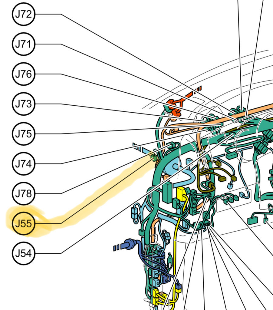

    After reading a bunch online I ended up figuring out it is a connector behind the fuse box on the drivers side. I attached a picture below to this post so everyone can see it and hopefully help someone. As for my AC blower problem it ended being a defective motor that kept popping the fuse on the fusible which was a pain to take out but after putting in my original part and swapping the fusible for the third time everything finally works
