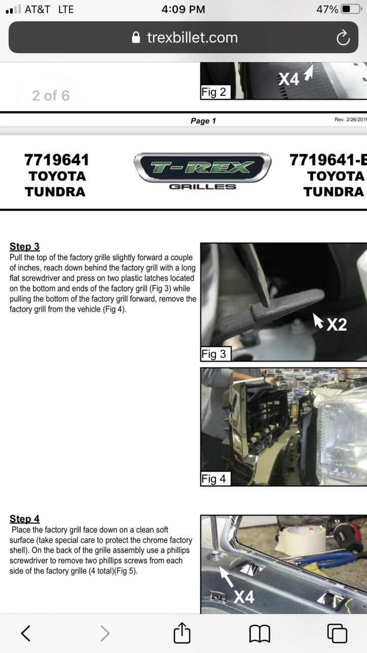

    Ok. Installed a t-Rex grill on my tundra front grill a few years back. Yesterday I noticed it was sagging a bit on the right side. Looks like the clip broke on bottom right if you are looking at it. It is the piece that goes through the bottom inside corner of the trim that sits below headlight. I can’t find the part number, I ordered three sets of “clips” and nothing is the same. Google searches aren’t helping me... does anyone know the part number for those clips?

    It is the part on the original grill that you put the t-rex on. So the chrome outline of the original equipment. The long white clips that put the grill back on the truck.

    The grill is attached to original equipment. It is the original equipment of the truck, and the clip that secures it to the frame, and happens to pass through the inside bottom edge of the trim piece that sits under the headlight. I am at work, but if I ever get out of here today I’ll snap a picture to explain.

    The little guy in figure 3

    Oh the latch tab clips! Why didn't you say so! Just kidding I don't know what those are called, probably tabs.
    I don't think you can order those as a separate part, its attached to the lower surround grille. You are probably going to need to order the grille assembly. You can see one of the tabs in the upper left of this video when he is trying to remove the sensor at the 8:30 mark and again at the 14:00 mark:
