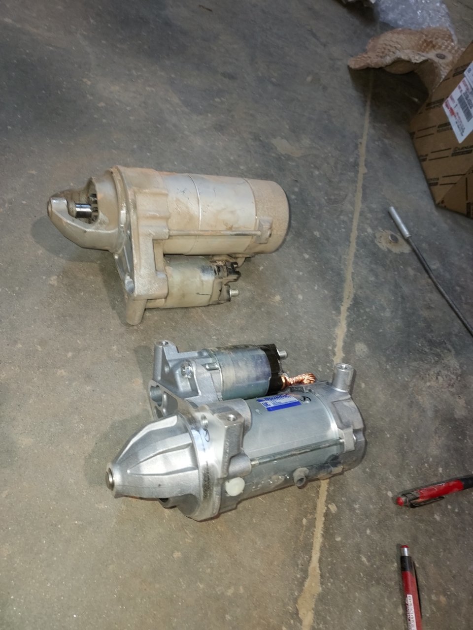

    Swapped the battery under warranty, and same thing happened.
    I jumped it one last time and it came back on, drove it around the block and it stalled leaving me stranded on the other side of the block, had to take the tow of shame to get it back home.
    At this point I just gave in and bought a starter, replaced it and has been good ever since. It's probably been 4 or 5 years since I replaced it with a Denso unit from rockauto.

    Just happened to me also. Damn heat shields took for ever... If you do it yourself remove the dipstick tube I fought with that shit forever. You don't need to remove the headers but it is tight.
