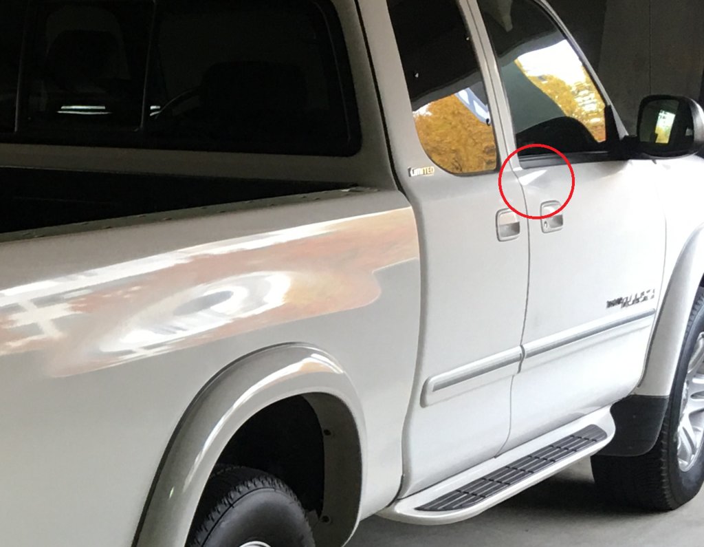

    IMG_5866.jpg I need some help figuring out what to do about replacing my clear coat or the next best thing. I saw the forum and it said that my truck normally wouldn't have a clear coat so do I even need one?

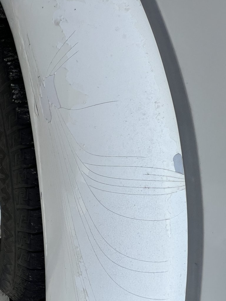

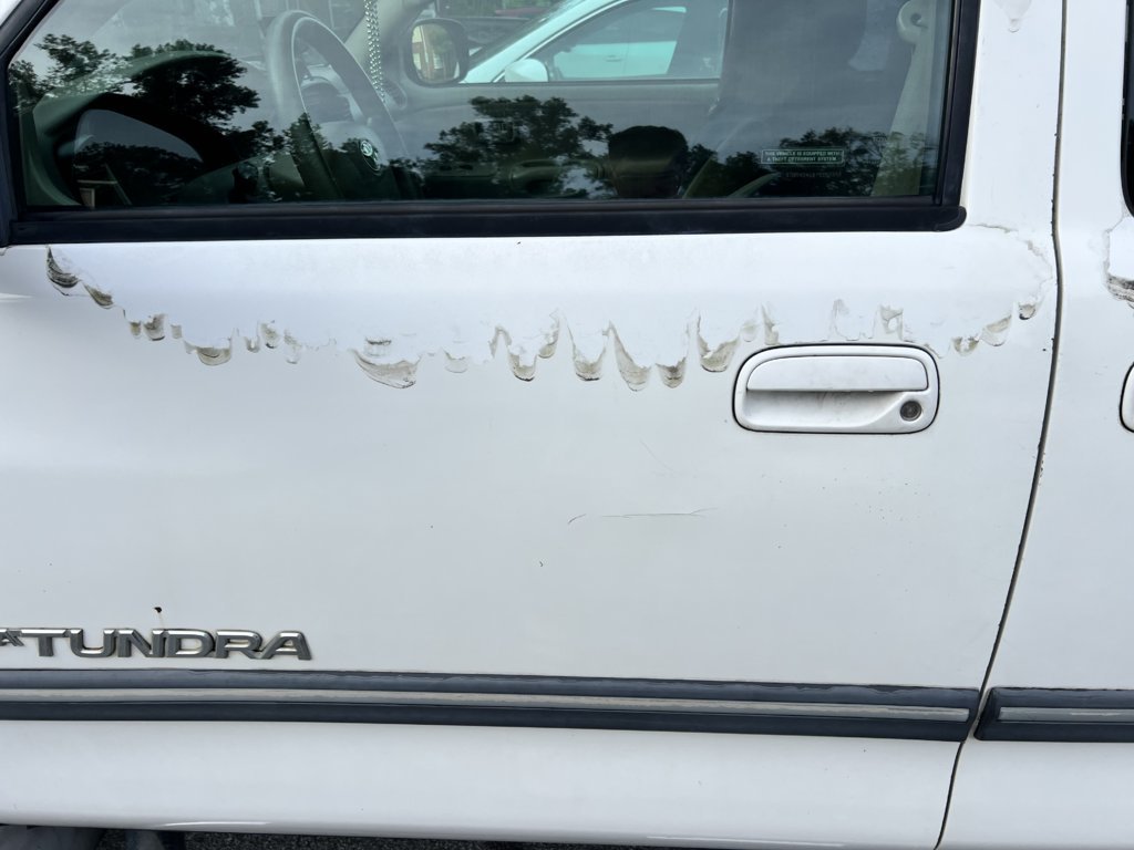

    I took a couple more photos if more is needed

    Best results are going to be a repaint, and alot of prep work.

    Repaint in places and shoot a coat or two of clear over the entire truck.

    It looks like some dumbass probably got talked into shooting a clearcoat over the original paint because it was chalked, and here you are. All it needed was polishing, but I’m guessing it got shot with clear instead.
    Your truck shouldn’t have clearcoat for white for metal panels, only the plastics. It should be single stage white, no clear. Repaint is your option. But for now you need to treat all the rust spots. Hit with a few rounds of Naval Jelly, and top with a white self-etch primer until you get it fixed.

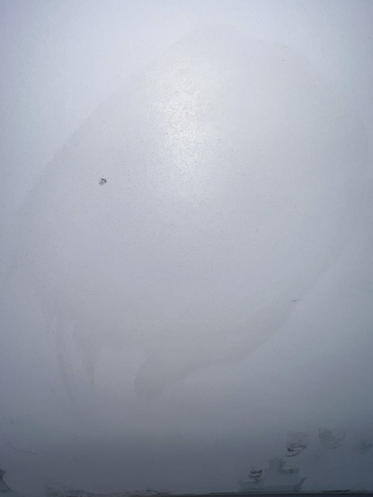

    I used this for the test and it definitely looks more like a glaze than a shine. I know its in the name lol. Will this work or should I go to ace?

    That's not a good example. That's sealant, it appears. You need compound, to physically cut the paint.

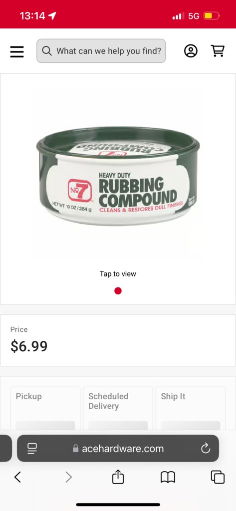

    This ? There is this and polishing compound.

    YES! That's the stuff. But at the store it may be in a white plastic shorty tube with a green plastic lid. That's the good stuff.

    Here you go. These are your friends. Chances are the can they have at Ace is the right can, but you can literally buy the shit all over the place. Auto parts stores, hardware stores, Amazon. Just make sure it is the RUBBING compound, not polishing compound, or any other compound. Stuff if the best compound I’ve ever used. Best mix of aggressive and smooth.

    To that point, need to make something clear. There are two common styles of painting used on our trucks: Two stange and single stange.
    Two stage: You shoot a base color coat on (stage 1), then top it with clearcoat (stage 2)
    Single stage: Clearcoat and base are mixed into one, and shot on (stage 1)​
    Single stage paint will always chalk out if not kept up with on wax and sealer. Multi-stage paint (2-stage, 3-stage) has the clearcoat to act as a hardshell, and as long as you maintain it with UV protection and wax it once a year, it'll usually stay intact for decades in "normal" environments.
    Why am I telling you this? I don't want to get your hopes up. It's well known Toyota used single-stage paint on their white and red (non-metallic) vehicles for decades, and was still using single stage on white vehicles through the 2010s, your truck should have come from the factory with single stage paint. Because this is established fact, with white trucks specifically, I'm assuming your previous owner's truck wasn't well taken care of, and it was as chalky as mine below, and he went to a paint/body shop, and/or they were paint-ignorant and decided they'd be smart and shoot clear over single-stage and it'd be shiny, but without proper prep, clear wouldn't stick, and you'd end up with what you show above: Gross failure of the clearcoat in a major way.
    **IF** I'm right, it means you have good single stage paint under that clear, and if you can remove the clear, you should be able to buff out the paint like I did with mine. If I'm wrong, and ... at some point, your truck was sanded and repainted two-stage, either because of sales lot or shipping damage, or because of an accident, then the chalky paint under your clear is basecoat, and the polish **WILL** technically make the basecoat shiny, but it won't stay shiny for more than 2-3 months without new clear over it to keep it that way.
    That's a long way of saying: I'm only suggesting you to do this, testing the No.7 on an inconspicuous spot like I'm showing in this red circle below, so we can see if it shines up, and is still shiny in 2-3 months. If so, I'd be pretty confident I'm right. And if not, No.7 is friggin awesome for all kinds of stuff, including getting headlights crystal clear again.

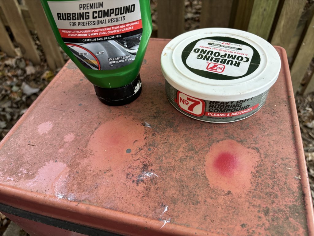

    @sANDI_tOES here is a real world comparison of these two products. Same exact method used.
    I have this bin outside my house for 3-4 years. Single stage paint. Sun has beat it down. On the right, I’ve done a circle as I recommend above, but maybe a bit larger, 1.25” and 1.5” with the Turtle.
    Clearly, the No.7 was able to cut down to the original pigment, through the layers of oxidation, and expose the original color underneath. Turtle wax got it mostly shiny, but couldn’t get down to good, unoxidized/unfaded paint.
    Again. Same method. Same pressure. Same panel. Different product. Turtle wax really errs on the side of caution, nerfing their product so people don’t cut thru their clearcoat. It’s closer in abrasiveness to Meguair’s Ultimate Polish (which is a polishing compound, not a buffing compound, there’s a difference). Turtle Wax shouldn’t be calling it “buffing compound”, it’s only as effective as a polishing compound.
    To that point, what we are trying to achieve here is NOT for us to use the No.7 to buff out your truck. No.7 is a bit aggressive for that, you DO NOT need something that cuts this hard to do that job, it’s not a good product for a newbie to use their 1st time. You should use polishing compound for that. But No.7 IS a great product to test, in under 60 seconds, what a GOOD polishing compound will do for your paint. And that’s what we are trying to do here: Confirm if some fucking idiot sprayed clear coat over your single stage paint, and that’s why it’s peeling so aggressively. If they did, there’s a solid chance we can resolve a good chunk of your paint. It won’t be a show queen, but it won’t look like ass either.
