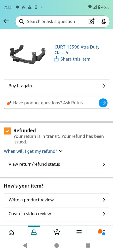

    My 14 CM SR5 came with a factory hitch. I'm wanting to replace it with a class V hitch but the Curt product I ordered doesn't have all the attachment points that the factory hitch has. Is there a class V hitch available or a work around to make the Curt hitch work?Tia

    Welcome from OKC! If the same one I ordered prior to buying my truck with a factory hitch, that dude is a beast! We were in the pandemic and I wanted a good hitch with my Tundra so I bought the Curt before the truck while available. Anyway on my truck, the factory hitch also serves to support the rear bumper (if you wanna call it that) components. That crap went in the trash and I bought Ranchhands to replace both. Anyway, that Curt product might not have all the same mounting points because it is just a hitch, not a bumper support/bumper core. That doesn't mean it isn't a great hitch. IMO it is a great alternative option. Have a picture or screenshot of it?

    Yup. That's the same one I ordered/received. I've got 60 days to return it, if I can't find a workaround. My question is...what do the Tundras that aren't factory equipped with hitches have for bumper supports? Can I use those parts and keep the OEM bumper or is replacing the factory bumper the only alternative?
