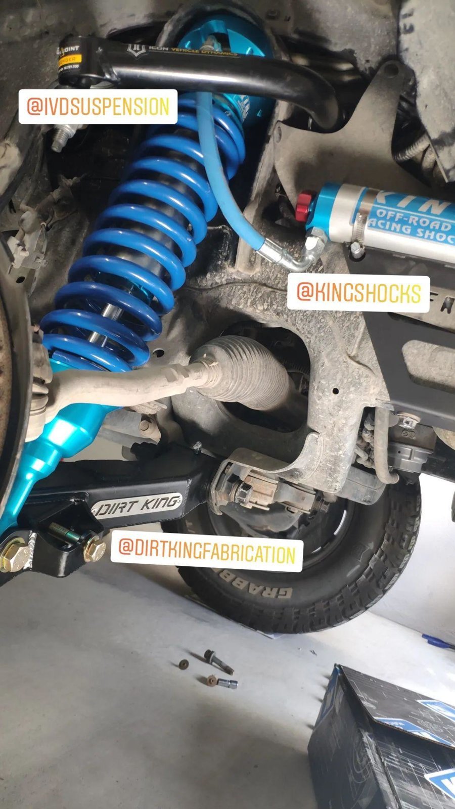

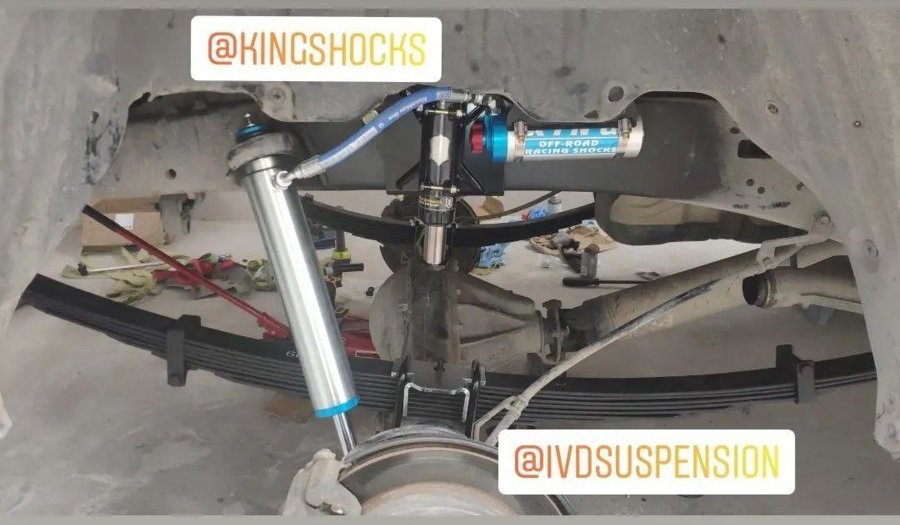

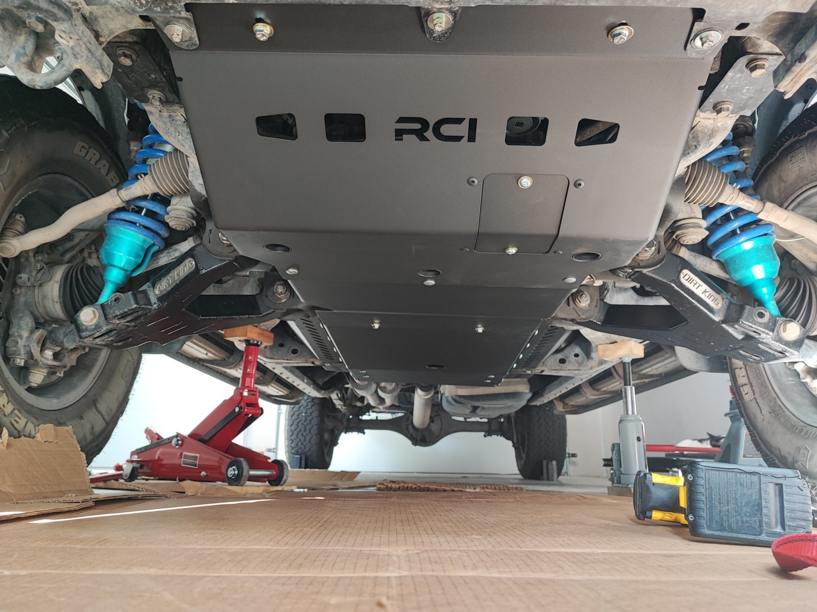

    Not a fan of posting **** to show what I have or what I do, but I owe this place and everyone here at least that much. The information shared and the help given on this forum is second to none, not sure I could have managed this much without it. I do most of the work (including suspension) and reach to the pros when needed... so here goes.

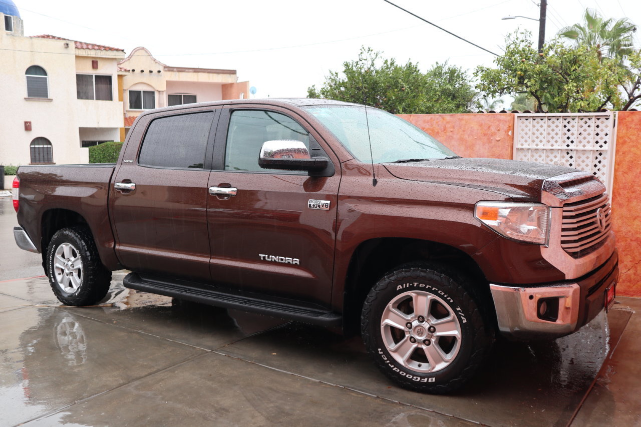

    From bone stock

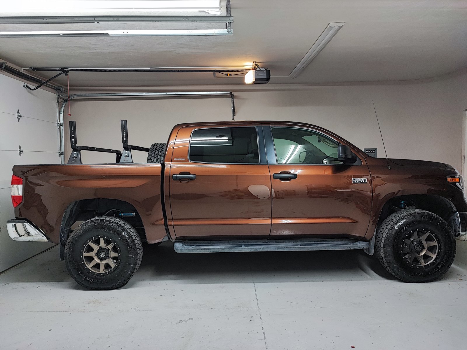

    To the following mods:

    Apologies for the lack of pictures, I inadvertently deleted them during a phone cleanup.
    There's not much else to do as far as mods go, bumpers and lights might be the last pieces of the puzzle, will do shock tunning and highly likely gonna box the back half of the frame. Other than that, truck is near complete.

    Edit: Found some on the 'gram, even forgot to mention Icon's tube uppers were there first, but alignment sucked with those.

    The truck looks sick! How's the rear flex with the Icon Leafs and the King shocks? That's the exact setup I'm thinking of running.

    Lots of good and usable flex, stock can't match at all. This setup is only second to bypass shocks and long travel.
    Upgrade to poly bushings and liner between leafs, silent and less undesired lateral flex :thumbsup:
