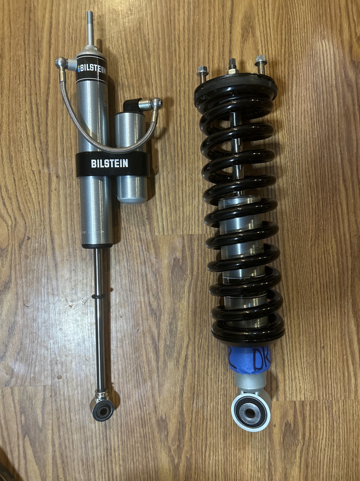

    Aren’t they purdy when new.

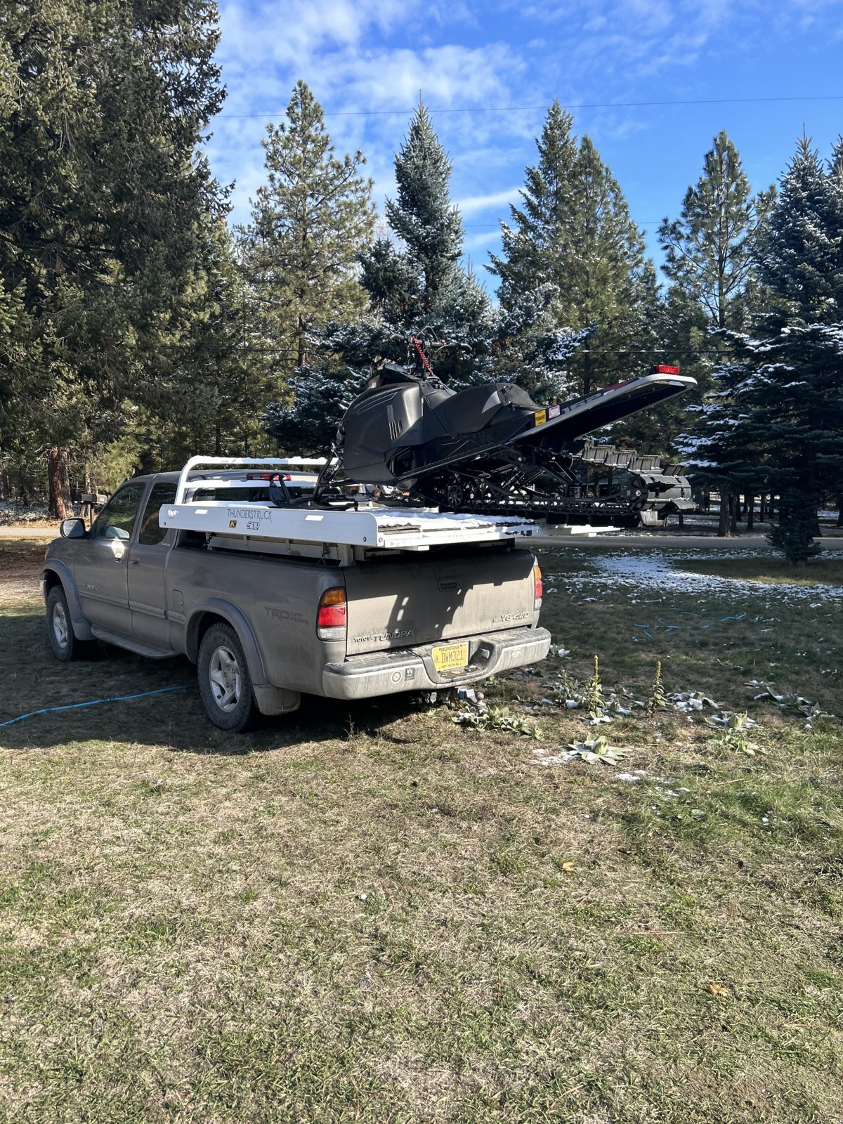

    Sitting a lot more level but still needs new leafs.

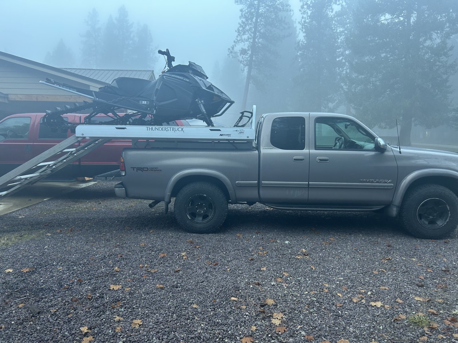

    This was the before.

    that’s a heck of a lot of cantilever going on! You almost need some sort of cab over ramp.

    All the weight is forward. The tunnel and track doesn’t weigh but maybe 70 pounds.
