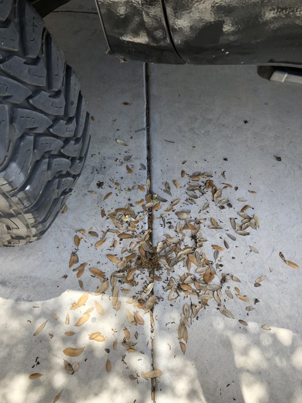

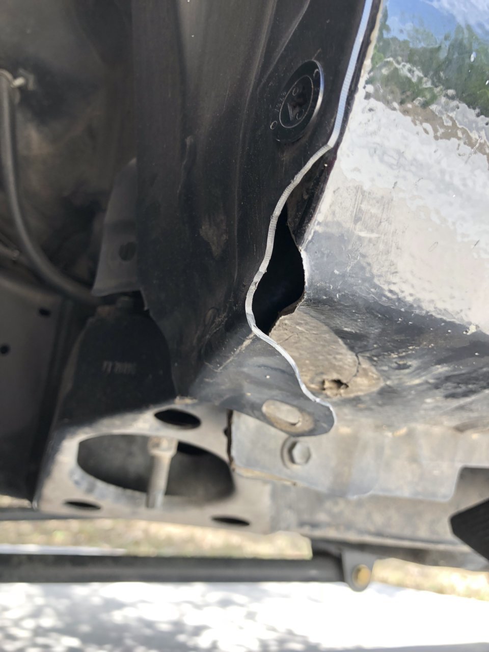

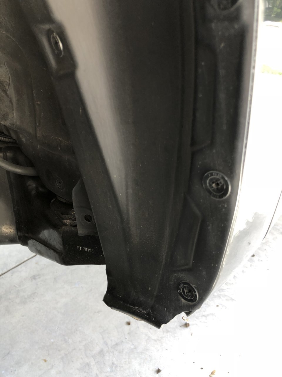

    I typically park my Tundra under trees at home. So today I noticed a small leaf sticking out of the lower driver side rocker near the front door. So I decided to remove the plastic river and take a look. Much to my surprise the whole lower panel was packed with leaves! I always remove them when I see them but I didn’t expect that many leaves to be trapped in there. Here are a few photos. Might want to check your Tundra if your under any trees and see if it’s packed full of stuff. A0B0D731-F43D-418C-81DC-82B26EA21CF7.jpg04E2DCEC-256B-4E61-8DD9-87732B4F4857.jpg 827D8B13-080E-40E0-A204-F3B4D07AF023.jpg

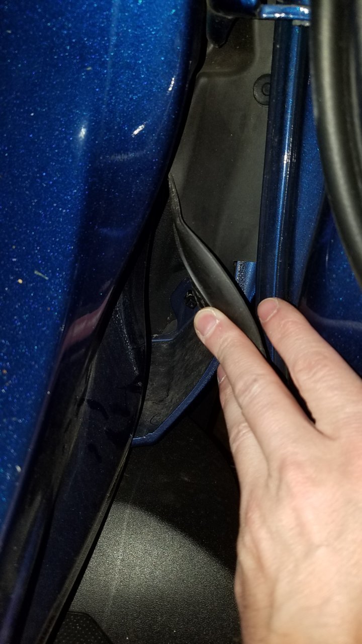

    You can get to those leaves without removing that tab. You can also go in from the jam side.
    Just push the plastic out of the way

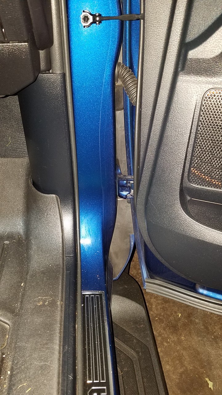

    Maybe this is the same area you're talking about?
    I just went out and checked.
    Shocked I didn't have anything in there.

    Yes sir. I’ve checked there as well. I couldn’t believe how many leaves where trapped in that spot. I would imagine if they stayed there for a long time they could have lead to rust.

    I tried that at first but it was a lot easier to remove all of them from the wheel well side.

    Yeah I taco would get loaded up with crap in there. It could absolutely lead to rust. And probably some smelly rotting stuff too

    I was surprised I had no leaves on my passenger side and a bunch on my driver side. Ok maybe I should have pulled that rubber towards the cab a little more after seeing your photo. lol

    That’s the spot. They come in from the top on the cowl area near the ends.

    Yeah it’s a tight spot. But if I only have a couple leaves, it’s easy to get. I can only imagine if it was packed.
