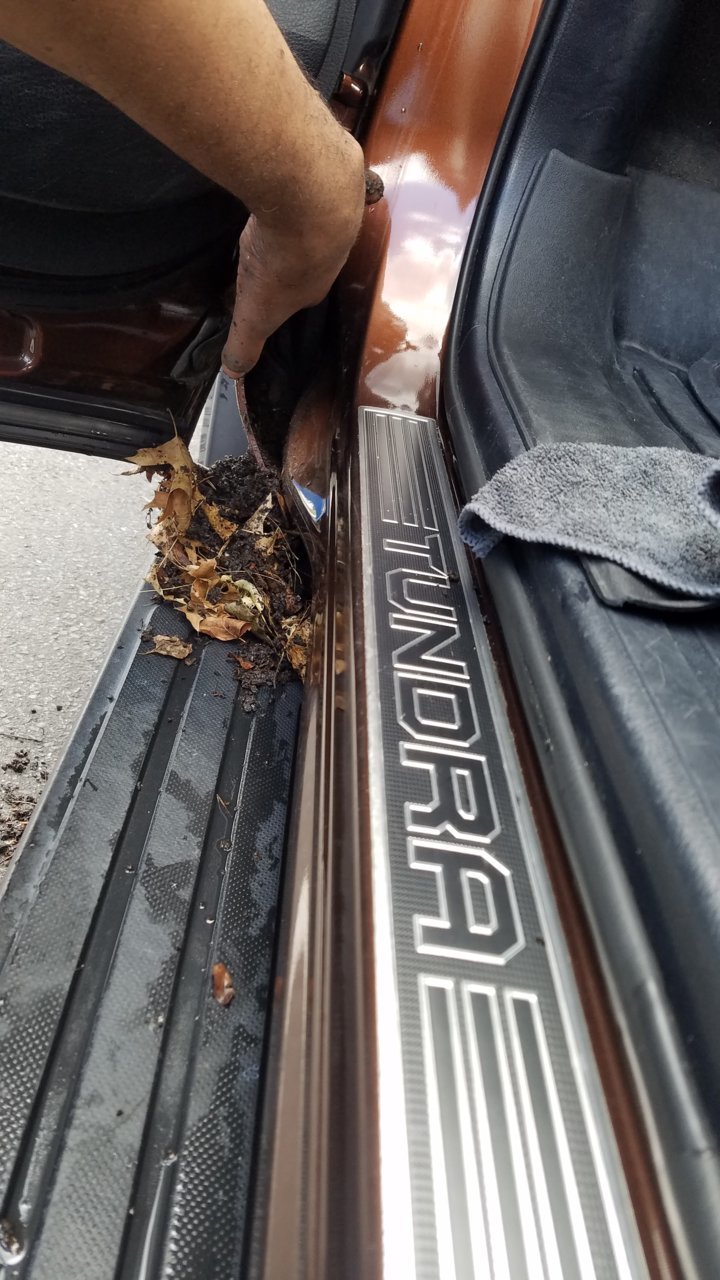

    I post this on the TRD PRO thread earlier. Went and wash my truck today. Noticed leaves hanging from rubber flap lower fender driver door. Pulled rubber flap and WOW lots of dirt leaves etc that I am sure would cause l ok were fender rot later.
    Cleaned it out also passenger side.
    You should all check and clean yours.
    Let me know what you all find

    I was shocked that mine were clean and dry. I do park in the garage every night so that must help. I sprayed all around inside there with fluid film just for piece of mind
